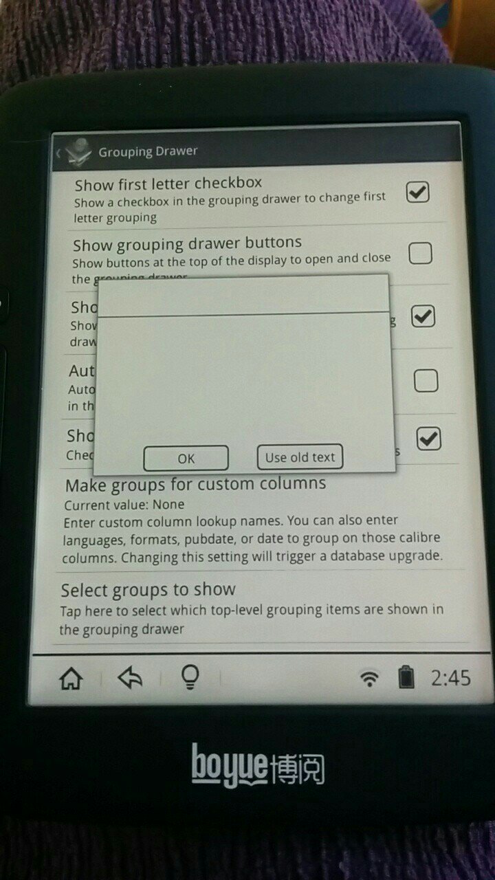

I'm playing with my Boyue T62 and have a setting that doesn't show text - in Groupings settings Make groups for custom columns. What should it say? Here's a pic:

PL: I just went through all the settings in that screen and non of them have those buttons on it. Are you sure you are using the latest version?
Make Groups from cusomt columns shows check boxes and a reset list button.
At the bottom there are cancel/help/ok buttons.
Attachment 128947
Have you connected it as a wireless device since calibre 2.1? It looks like it isn't seeing the columns supplied by the later calibre releases and that my test for that isn't working.
I haven't connected as a wireless device at all yet. Just to the content server.
OK, then that is the problem. Somehow the text of that dialog box has been lost.
The CC dialogs that allow column selection require having connected at least once as a wireless device to calibre 2.1+ to get the descriptions of the columns available. The dialog you are looking at was intended to tell you that. Clearly it doesn't. I will look at the code tomorrow AM when my brain is more engaged.
Since this is eink is it possible that it's the white on white problem? I'll wait until you have a version with the text showing until I connect wirelessly so I can test it.
Anything is possible. I know we have had trouble with text styling in the past.
Thanks for waiting.
