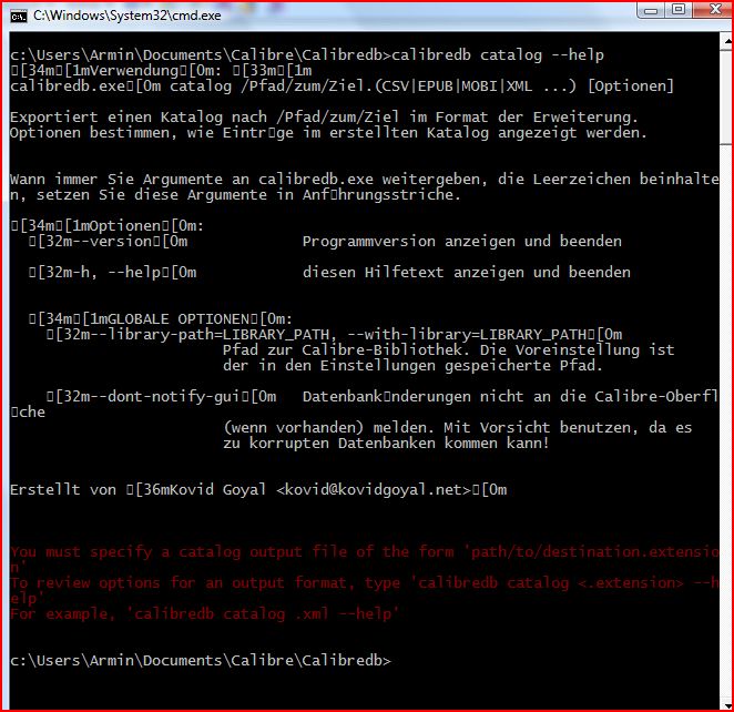

An additional point, if I do a help request, the printed output looks very ugly.
i.e.: 'calibredb catalog Katalog.csv --help' (second picture)
I'am a bit lost on this. Is it me or an error?

The ugliness is probably because you have a non-utf8 windows console. Trying to get correct output for all the combinations of windows encodings + console encodings out there is impossible.
Old 02-09-2014, 12:58 PM   #3
Posts: 45,627
Karma: 28549046
Actually no the ugly output is specific to calibredb catalog --help (without a filename) and windows. Fix will be in next release.
