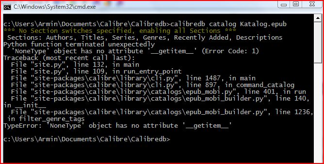

However, what is not working is i.e. 'calibredb catalog Katalog.epub' where I get this error
*** No Section switches specified, enabling all Sections ***
 Sections: Authors, Titles, Series, Genres, Recently Added, Descriptions
Python function terminated unexpectedly
  'NoneType' object has no attribute '__getitem__' (Error Code: 1)
please see first picture.
If I add '--fields=authors' I got only new errors. Guess it is not for epub and applies only for csv and xml?

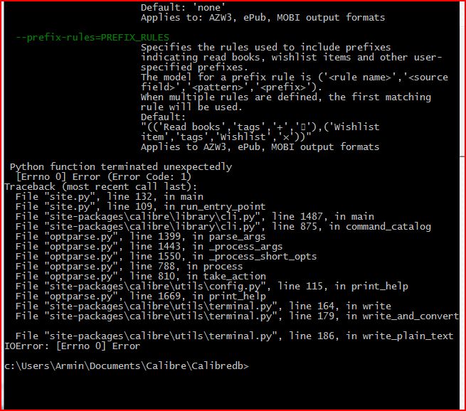

i.e.: 'calibredb catalog Katalog.csv --help' (second picture)
I'am a bit lost on this. Is it me or an error?

In the first picture your error is likely caused by a stale setting for the genre source field. You will have to change that in the main calibre program.
I had just change the Gui-language to English and try to do the command line catalog again and to my surprise it works. Going back to German the error is back again. Same to some other language. I check it for some other like Italian, Spain and French. Same behavior. Going back to English and it works again. It looks like there is a problem in this area.

https://github.com/kovidgoyal/calibr...f2e4497eceeec4

I got this python error if I use the help-option (calibredb catalog file.epub -h) at the end of the report.

Old 02-10-2014, 12:35 PM   #11
Posts: 46,556
Karma: 29634066
https://github.com/kovidgoyal/calibr...0ca132cacab582
