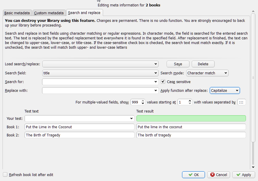

It demonstrates only that your assertion that the other case change operations were not in bulk metadata update was false. Also, there is no need to write regular expressions, as shown by the attached screen capture.
As for inferring pro or con "Anglosphere cultural bias", je n'en sais rien. Vos allégations sont trop subtiles pour moi.

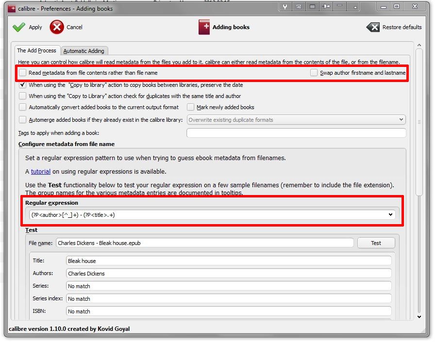

And I request you, can I import the books with calibre but read the file names and not the metadata content? If it were possible I would not have the need to convert anything

@chaley - at the top of your attachment there is first a warning that Search and replace can destroy a library, this followed by a long paragraph that most non CompSci graduates cannot comprehend - hence they 'move on'.
Don't you think it would make more sense and be more consistent if the Case Change drop down button was available on the Basic metadata panel - it would also remove any perceived hint of cultural bias.

@Lauraq - yes you can do that quite easily - go to Preferences->Add Books, see the attachment
The settings you may need to 'adjust' are those I've highlighted
There are preconfigured regular expressions you can use - click the little down arrow at the right end of the regular expression field to see the others.
I use the one shown - and you can see that I've entered a test file name and clicked the test button

Fantastic! The conversion isn't necessary now

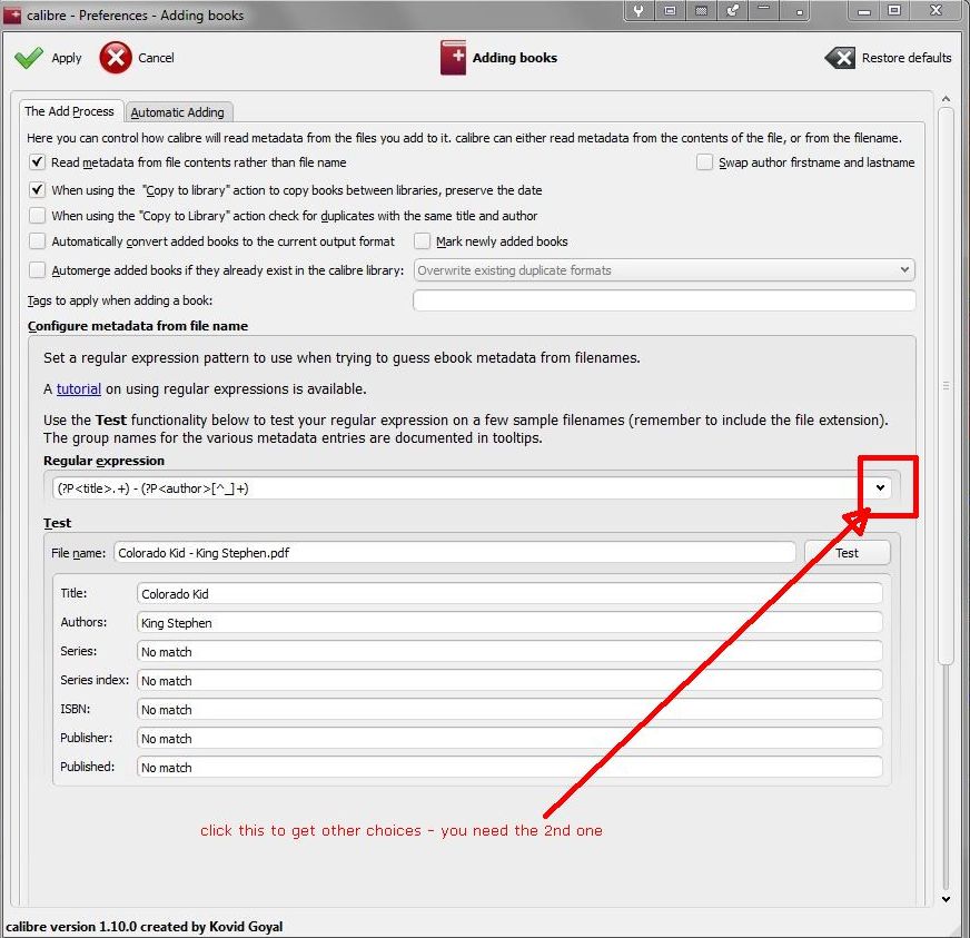

But I have a last problem, the files that I have have first the titel and after the author, for example:
Colorado Kid - King Stephen
and your string import the name in the title field and the title in the name field. I have reverse the string to
(?P<title>[^_].+) - (?P<author>.+)
but don't work

@Lauraq - See attachment - select the second RE in the drop down list and you should be good to go

PERFECT
