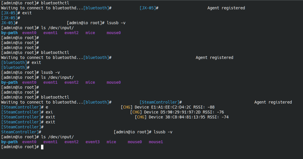

I've found a couple of use cases where having a bluetooth page turner would be quite useful.
I've tried with 4 devices...
So far I've managed to make it work with just one, a cheap bluetooth joystick.
I want to make it work with a selfie remote control.
I've checked with evtest and it is generating a KEY_VOLUMEUP event.
But I've tried to configure that and it is not working...
With a second clicker it generates one KEY_VOLUMEUP and KEY_VOLUMEDOWN in loop (a different event on each click)
Any ideas on how to continue...

I've tried a bunch of cheap remotes. The single button (or Android/Apple two button) ones usually don't do anything useful. Some of them do Enter.
Ok, I know that this part is not useful for most people. In the past, when selfie clickers were not so popular many of them used a masked ROM for the Bluetooth stack and an EEPROM for the OEM's code. Finding and altering the USB HID descriptor was easy. Then you could have the clicker generate any key code. You just needed an I²C interface to reprogram. I did this to one clicker and then put it into a little foot switch. Since then I've just replaced it with my own Bluetooth circuit.
The other way is to make a custom /system/usr/keylayout/Vendor_1234_Product_5678.kl that will remap your useless button to what you want. This will work fine, but it means that you can't use your clicker on a random device.
There are clickers with "5 way" controls, but I've found the mechanical properties ungainly.
It sounds like the keylayout is the way to go for you?

Has anyone figured out the solution for finding the best event codes? I bought this bluetooth button: https://nl.aliexpress.com/item/10050...yAdapt=glo2nld it's called the JX-03. And these are the results of the evtest tool:
On connection
Select the device event number [0-21]: 21
Input driver version is 1.0.1
Input device ID: bus 0x5 vendor 0x5ac product 0x22c version 0x11b
Input device name: "JX-03"
Supported events:
  Event type 0 (EV_SYN)
  Event type 1 (EV_KEY)
    Event code 114 (KEY_VOLUMEDOWN)
    Event code 115 (KEY_VOLUMEUP)
    Event code 320 (BTN_TOOL_PEN)
    Event code 330 (BTN_TOUCH)
    Event code 374 (KEY_KEYBOARD)
  Event type 3 (EV_ABS)
    Event code 0 (ABS_X)
      Value      0
      Min        0
      Max     4095
    Event code 1 (ABS_Y)
      Value      0
      Min        0
      Max     4095
    Event code 40 (ABS_MISC)
      Value      0
      Min        0
      Max        1
  Event type 4 (EV_MSC)
    Event code 4 (MSC_SCAN)
Properties:
  Property type 1 (INPUT_PROP_DIRECT)
Testing ... (interrupt to exit)

Hello.
I can't figure how to make my cheap aliexpress ring to work.
I tried to do the uhid.ko without results.
I am able to connect it to my libra 2, it stays connected with the name JX-05. I see it under bluetoothctl when connected to ssh. However, there is no /dev/input/event3. It is not listed either on /proc/bus/input/devices.
The ring works, if I connect it to my linux PC, a correct entry is created under /dev/input, it is listed under /proc/bus/input/devices, and evtest pick it fine.
Could somebody help me ?
Link to the Aliexpress page of the ring

Do you see your Bluetooth device reacting to your inputs? That’s a way of telling whether the kernel patch did its thing or not (a Led flash is what it is usually).
Have you determined the correct actions using evtest? What does your config file look like?

I'm 100% sure I found the correct actions. I succesfully setup the plugin using a steam controller. The thing is, evtest on the kobo cannot find the ring, even tho it is connected to bluetooth. Evtest on my PC using linux find it without issue

Originally Posted by shamalox View Post
The thing is, evtest on the Kobo cannot find the ring, even though it is connected to bluetooth.
Input things might be a keyboard, consumer control, a mouse, a game controller.
Some of these might not be acknowledged by a specific system.
The question is: what is your ring?
Sometimes? lsusb -v can print out HID report descriptors.
If we could see that, we could see what your ring is.
OTOH, that probably won't help getting the ring to work on your Kobo.
But at least we will know what the scoop is.
When buying Bluetooth devices out of China, buy a few of each and celebrate if one hits the jackpot.

Nothing either in lsusb unfortunately...
As seen in the screenshot, the first part is when it is connected (see JX-05 in bluetoothctl).
The second part is with bluetooth off.
The third part is with a steam controller, which I know works well.
Honestly I know that I'll probably need to buy another, but i'm curious as to why is doesn't even exist in the eyes of the kobo
Then connect it to something that works.
Dive down in /sys somewhere and find "report_descriptor".
This is a binary file, copy it over and post it.
Make sure you have the right device.
