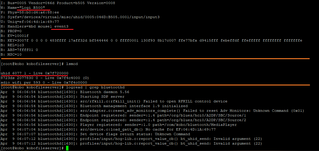

Yes, it works. I rebuild the uhid.ko and try it with my Logitech R500. It is perfect now!
https://github.com/tylpk1216/kobo-libra2-uhid-module
