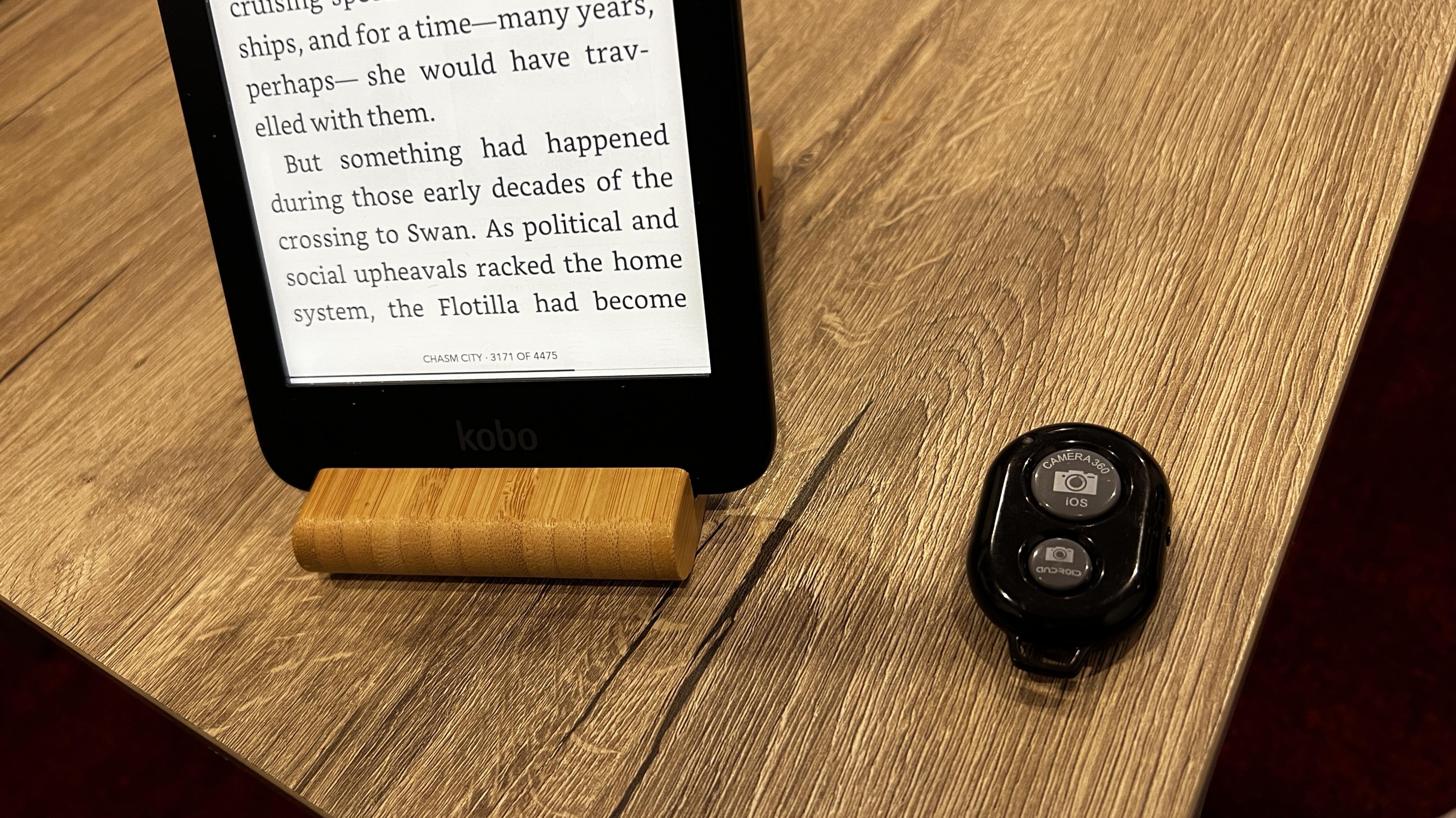

Getting close but not there yet...
I've found a couple of use cases where having a bluetooth page turner would be quite useful.
I've tried with 4 devices...
So far I've managed to make it work with just one, a cheap bluetooth joystick.
I want to make it work with a selfie remote control.
I've checked with evtest and it is generating a KEY_VOLUMEUP event.
But I've tried to configure that and it is not working...
With a second clicker it generates one KEY_VOLUMEUP and KEY_VOLUMEDOWN in loop (a different event on each click)
Any ideas on how to continue...

I've tried a bunch of cheap remotes. The single button (or Android/Apple two button) ones usually don't do anything useful. Some of them do Enter.
Ok, I know that this part is not useful for most people. In the past, when selfie clickers were not so popular many of them used a masked ROM for the Bluetooth stack and an EEPROM for the OEM's code. Finding and altering the USB HID descriptor was easy. Then you could have the clicker generate any key code. You just needed an I²C interface to reprogram. I did this to one clicker and then put it into a little foot switch. Since then I've just replaced it with my own Bluetooth circuit.
The other way is to make a custom /system/usr/keylayout/Vendor_1234_Product_5678.kl that will remap your useless button to what you want. This will work fine, but it means that you can't use your clicker on a random device.
There are clickers with "5 way" controls, but I've found the mechanical properties ungainly.
It sounds like the keylayout is the way to go for you?

Old 12-12-2023, 10:58 PM   #127
lumping-sugar66
lumping-sugar66 knows better than to ask about the Gravitic Imploder Lance.lumping-sugar66 knows better than to ask about the Gravitic Imploder Lance.lumping-sugar66 knows better than to ask about the Gravitic Imploder Lance.lumping-sugar66 knows better than to ask about the Gravitic Imploder Lance.lumping-sugar66 knows better than to ask about the Gravitic Imploder Lance.lumping-sugar66 knows better than to ask about the Gravitic Imploder Lance.lumping-sugar66 knows better than to ask about the Gravitic Imploder Lance.lumping-sugar66 knows better than to ask about the Gravitic Imploder Lance.lumping-sugar66 knows better than to ask about the Gravitic Imploder Lance.lumping-sugar66 knows better than to ask about the Gravitic Imploder Lance.lumping-sugar66 knows better than to ask about the Gravitic Imploder Lance.
lumping-sugar66's Avatar
Posts: 152
Karma: 87635
Join Date: Oct 2023
Location: Ontario, Canada
Device: Kobo Aura Edition 2, Kobo Clara 2E, Kobo Libra 2
Originally Posted by tylpk View Post
Yes, it works. I rebuild the uhid.ko and try it with my Logitech R500. It is perfect now!
https://github.com/tylpk1216/kobo-libra2-uhid-module
tylpk, tsowell Thank you very much for this mod.
I can confirm on my Clara 2E, using the mod and the kernel patch provided above, the cheap BOOD-202 device is turning pages.
FWIW, here's the settings for this device.
[root@kobo ~]# cat mnt/onboard/.btpt/BOOD-202
nextPage 1 115 0
Which translates to "nextPage EV_KEY KEY_VOLUMEUP 0"
All the best
lumping-sugar66 is offline   Reply With Quote
Old 12-13-2023, 04:40 AM   #128
Renate
Onyx-maniac
Posts: 4,438
Karma: 22077647
I can see that you like wood. Did you make the stand? It's nice.
The table isn't too shabby either.
