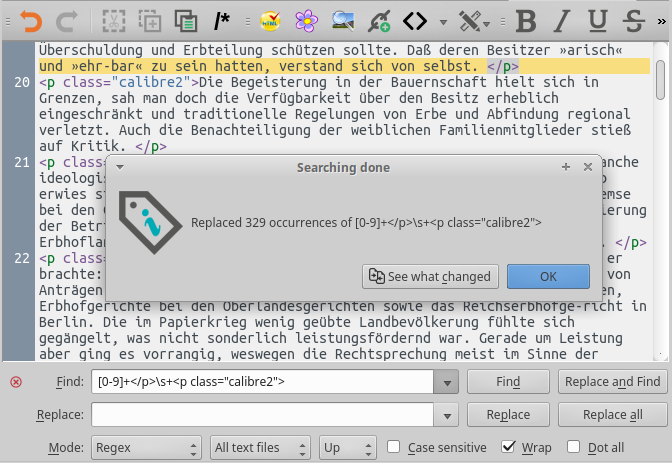

Name:	Searching done_Replaced 329 occurences.png
Searching done Replaced 329 occurences of [0-9]+</p>\s+<p class="calibre2">

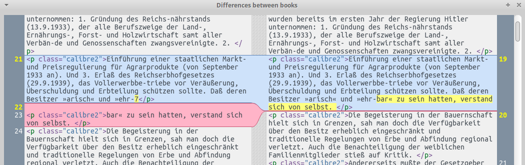

Name:	Differences between books.png
Differences between books I consider (left side) only the characters which get eliminate, so 7</p> and <p class="calibre2"> should be highlighted in red.
Consequently, the yellow highlightings (right side) would be superfluous.

Sigh. I suggest you go read up on how diffing algorithms work. Google patience diff algorithm. No diffing algorithm can ever match what you think has "changed" in all situations. There are literally infinite ways to go from document A to document B. Any diffing algorithm simply has to guess which of those ways was actually used. Every diffing algorithm will get it wrong from time to time.

IMHO that is actually the correct way anyway.
The code tags are part of the changes, are they not?
