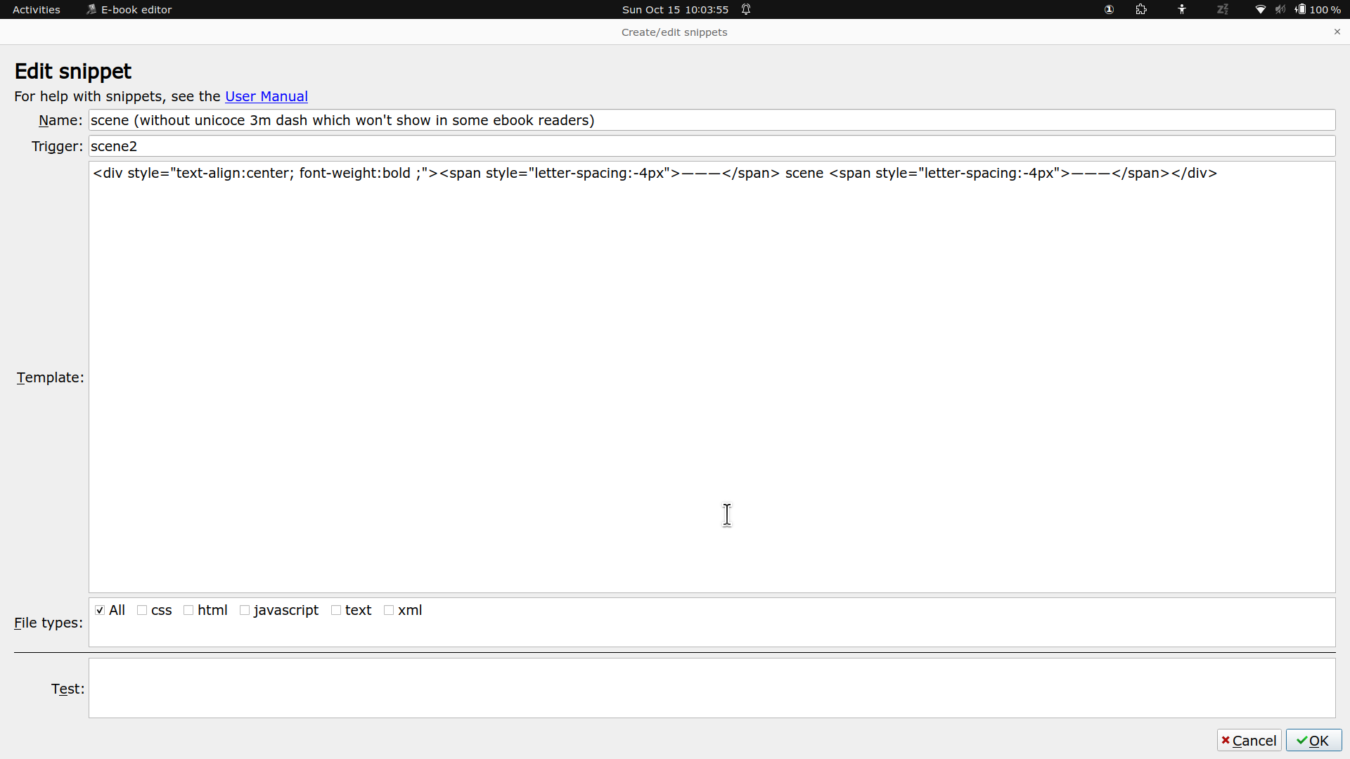

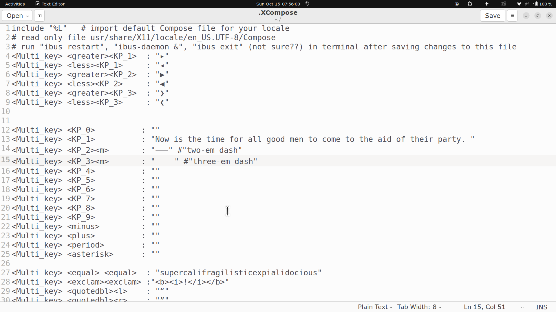

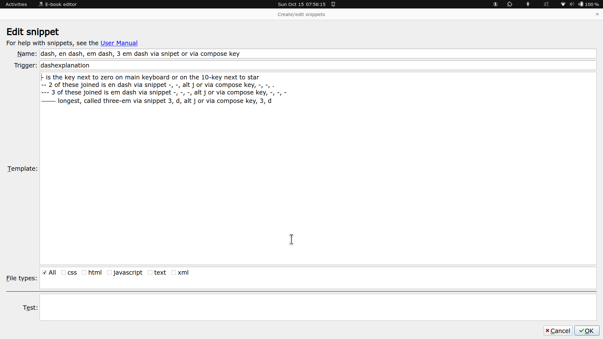

I use en dash and em dash quite a bit. To make them I employ both the calibre snippets and also .XCompose. I found out to my horror from a prior post reply that Amazon will not recognize the em dash, so I fudge it by 'running together' 3 regular dashes with a span whose spacing has been reduced. I use the triple sometimes to surround page numbers at bottom of PDF pages. You can set up an .XCompose file in Home and use it elsewhere (not just calibre tag editor). While in calibre I prefer using snippets for en and em dashes. I break USA convention (if, indeed, those rules still apply) by separating like this: text space en dash space text. That is, I do not allow the en dash to touch text (as is the convention). I find that it is even worse looking when done as follows: text comma en dash space text. This was done frequently a century ago by many authors. Or, maybe the type setter did this. I use the triple dash like this for mid-chapter centered scene breaks: em dash space scene space em dash. Best regards, Pop

Sure em & en both work on Amazon upload to KDP. Why do you think em dash doesn't (which is odd as Amazon is US)?
On Linux I disable Caps Lock Key, both shift is Caps lock, either cancels and then Compose mapped to Caps Lock Key. The Compose --- is em and Compose --. is en as standard. I do have a custom .Xcompose too, but only needed for Greek, prime, double prime like 6′ 2″ ( Using Compose 0 ' and Compose 0 ", where 0 is Zero.) and a few other unusual things as Alt Gr and Compose cover Spanish, French, German, Polish, Icelandic etc. I've no need to type Hebrew, Arabic, Thai, Hindi, "modern" Korean or Cyrillic, but these can be done by swapping layouts or in .Xcompose. The advantage of .Xcompose is using a transliteration rather than official language layout.
Years ago I made my own layouts using MS Keyboard Editor thing on XP to match the AltGr of Linux. I've no idea why the regular MS UK or US layouts are so limited.

It's the extra long dash that won't show correctly in kindle previewer. I quit (more or less) using it from advice on mobileread. I now fudge the way-long dash with calibre's snippetology which is fun to do. It would be great if there were a way to insert various CSS to create epub outcomes viewable with calibre's reader that emulates what each and every name brand dedicated ebook reader will show without having to actually purchase that particular piece of hardware. I have no desire to buy any nook, fire, ipad, sony, kobo etc. in addition to my laptop which seems to show epub rules exactly under calibre. As of now, putting cutting edge CSS stuff on amazon runs the risk of it looking corrupt on their own reader. They only use a cut-down subset of CSS. As for little-used unicode stuff (which I like to goof with sporadically) I am perplexed it won't work in the amazon kindle previewer. After all, they have done yeoman's work getting Japanese, Hindi, every which kind of alphabet to work. Seems as though they could at least put out a linux version. I thank you all for your input and correspondence. Best regards, Pop
No. The two rare dash characters:
  • U+2E3A = ⸺ = TWO-EM DASH
  • U+2E3B = ⸻ = THREE-EM DASH
should not be used like that.
Instead, it's better to create those lines via CSS. That was one of the first questions I asked MobileRead wayyyy back in:

I also strongly recommend against using those 2 dash characters, because of all the missing font + problematic rendering issues. Instead, use the equivalent amount of normal EM DASHes.
Yep, exactly. Barely any fonts have those 2 rarer dash characters, and it will cause more trouble than it solves.
