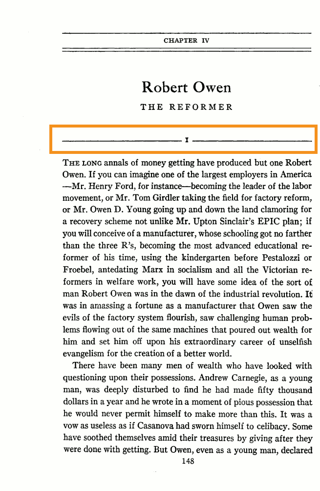

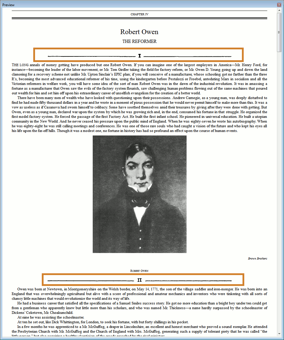

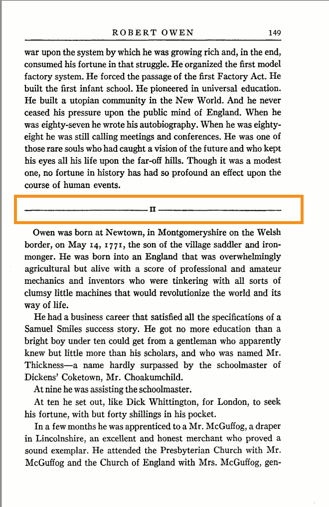

I was wondering if anyone has stumbled upon a way to do these headings in EPUB (Highlighted in orange):

The current EPUB uses images. (HIDEOUS solution, and does not scale at all):

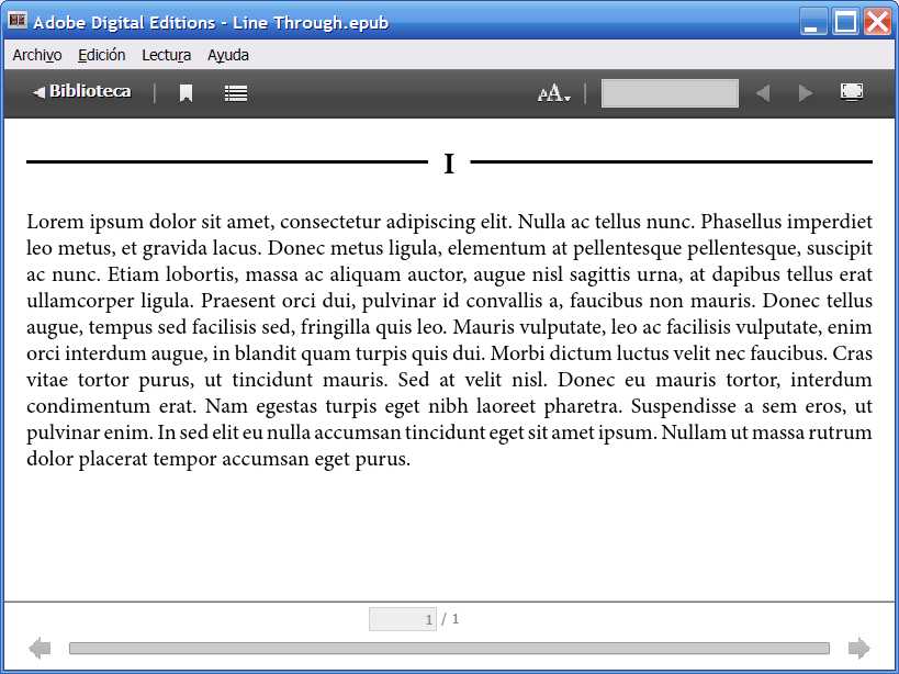

Hi Tex;
You can achieve that effect with the following code:
1. In your .css stylesheet, write:
h2 {
   text-align: center;
   margin: 1em 0 1em 0;
   font-size: 1.4em;
   border-top: 3px solid black;
   height: 0.5em;
.text {
   float: left;
   width: 5%; /* feel free to change the width */
   margin: -0.5em 47.5% 0 47.5%; /* if you change the width, then you must change the left and right margin */
   background: white !important;
p {
   text-align: justify;
   text-indent: 0em;
2. In your .html file write:
<h2><span class="text">I</span></h2>
<p>Lorem ipsum dolor sit amet, consectetur adipiscing elit. Nulla ac tellus nunc...</p>

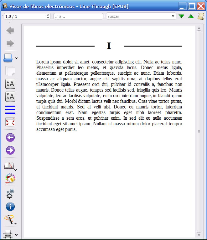

Here you can see how it looks in ADE:
Name:	Line Through.jpg
Below I attach the respective .epub
Regards

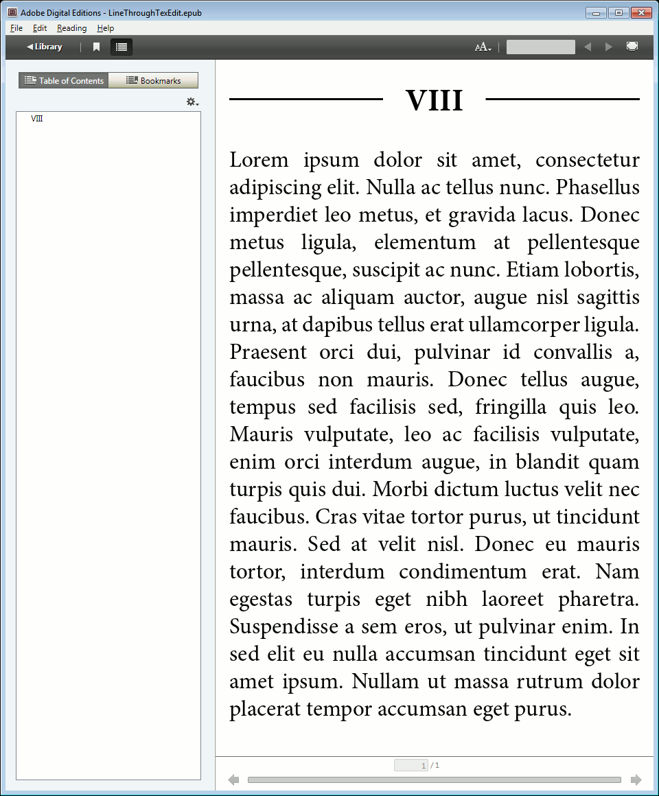

In ADE:

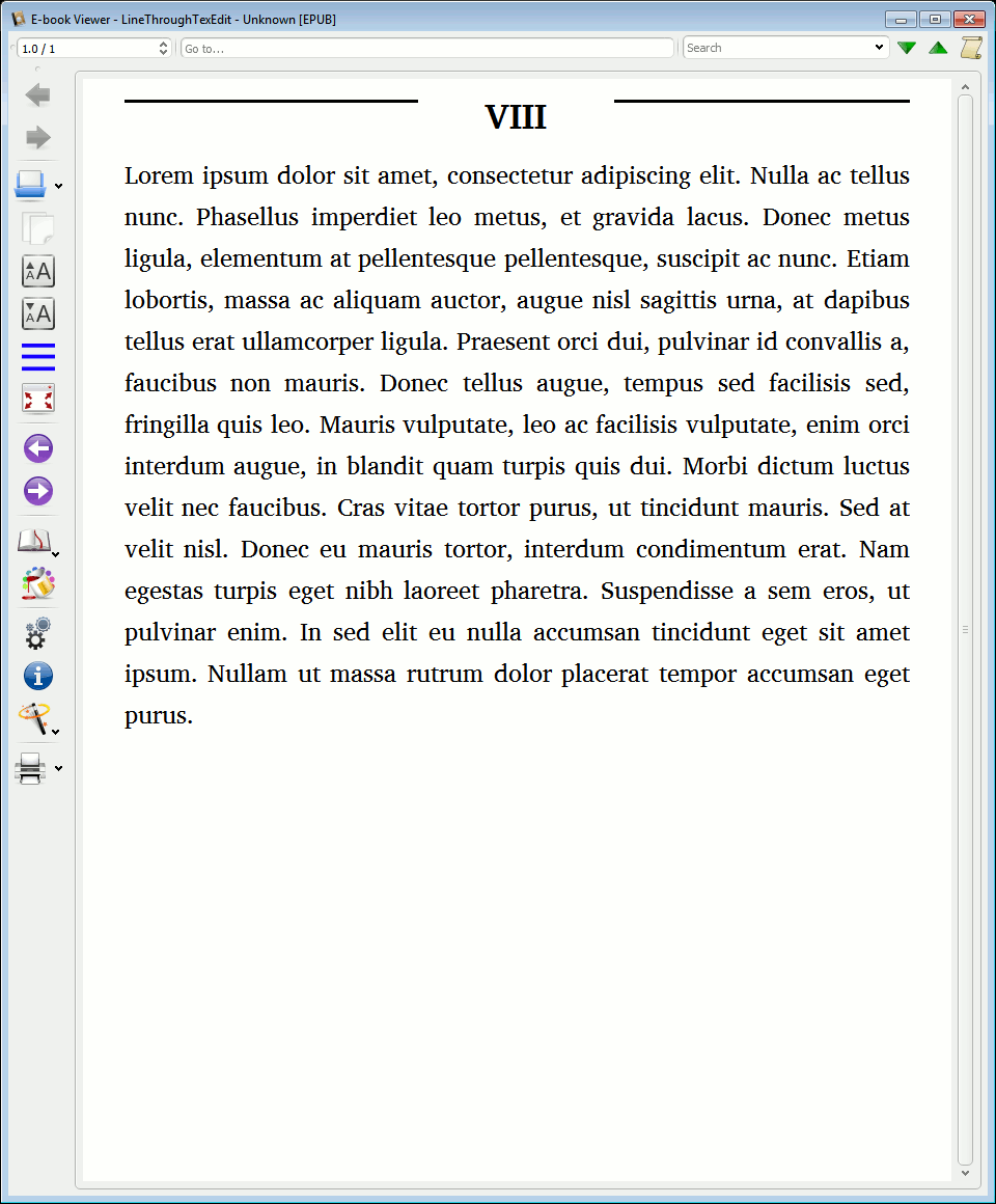

Tested it in Calibre, you get this oddity (border appears at the very top, and not through the middle):

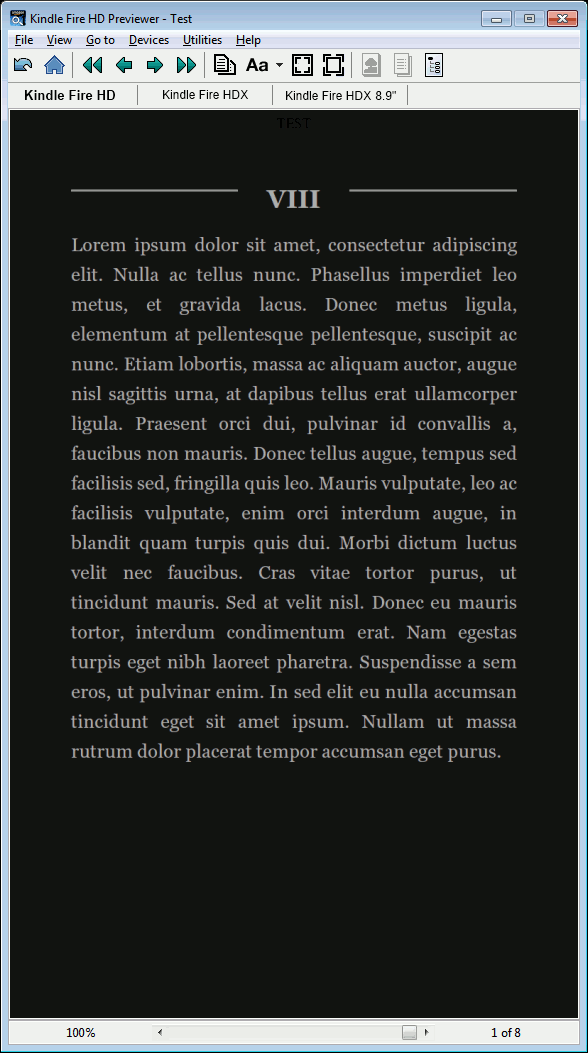

Well, it seems that if we set the line color to some kind of grey, all is solved. See this picture:
Name:	Line Through Night.jpg
I reached that solution by using:

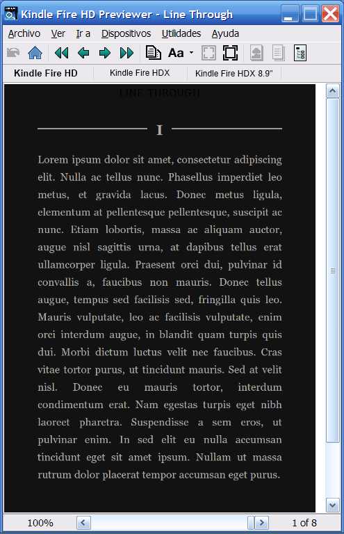

Hmmm.. now am I just going crazy? My Kindle Previewer shows the line up top and not centered as it does in yours:

(You should upgrade to PNG in your posts as well, that last one had such bad haloing artifacts.)
Really? You are a perfeccionist, Tex I think that .jpg is ok in posts like this one.

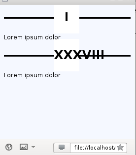

Maybe someone with a Kindle Fire can post a screenshot of his\her device and then we'll have a definitive answer. By the way, your aproximation works better in night mode:
border-top: 3px solid;
looks great in Kindle Previewer.

I think I found the final solution with the following css code:
h2 {
   height: 2em;
   border-bottom: 3px solid;
   margin-top: -1em;
   margin-bottom: 1em;
   font-size: 1.4em;
   text-align: center;
.text {
   float: left;
   width: 20%;
   line-height: 2.8em;
   font-size: 1.4em;
   margin-left: 40%;
   margin-right: 40%;
p {
   text-indent: 0em;
This is the look in Calibre Viewer:
Name:	Line Through II.png
And this is the look in Kindle Previewer (Kindle Fire - Night Mode):
Name:	Line Through.png
Below I attach the respective epub.
Regards
Rubén
