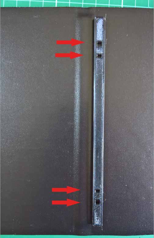

6. Now you have to cut holes in the sticky f. l. to free the holes in the lower spine. In the picture below I used a second spine to localize the holes
7. Holes
8. Attach the upper part of the spine to see if everything fits and the holes are big enough
