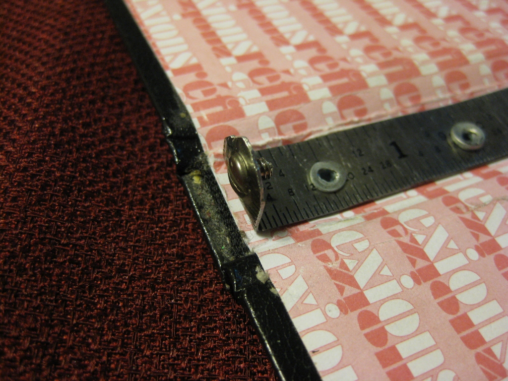

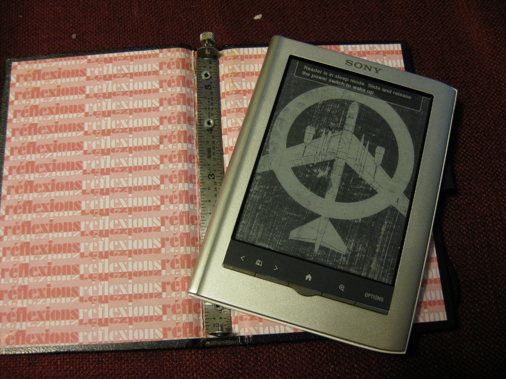

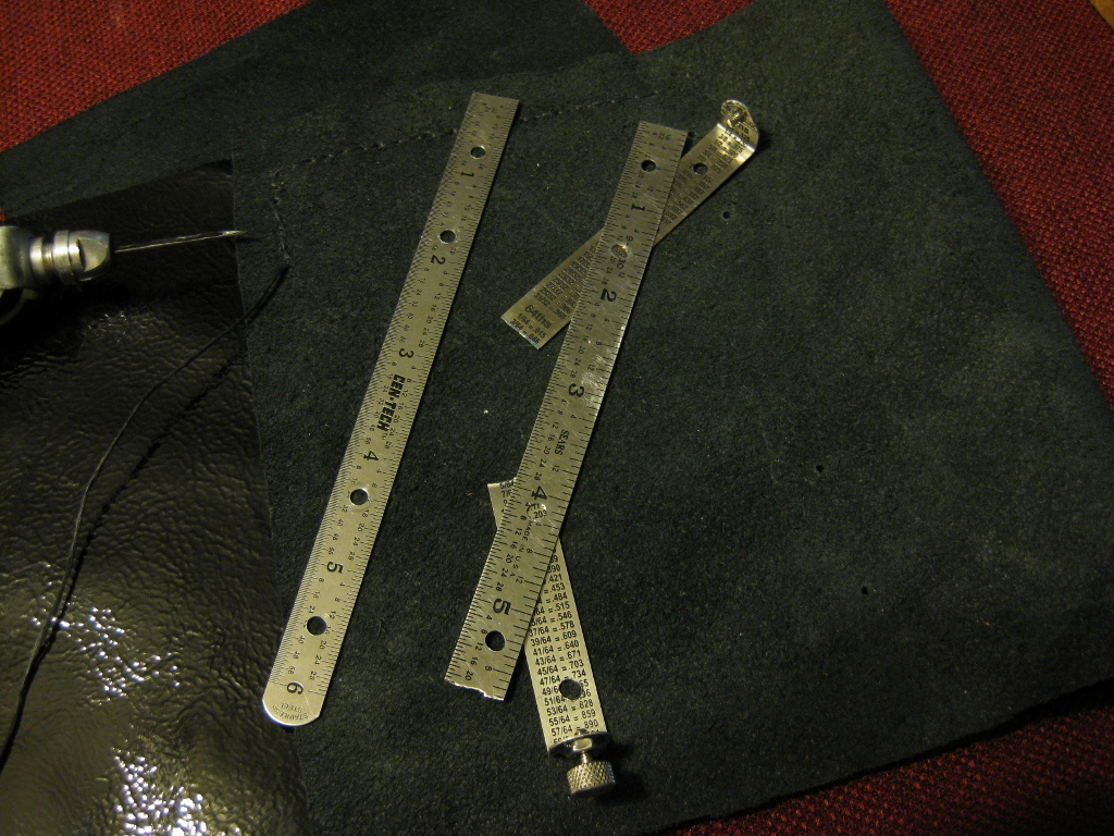

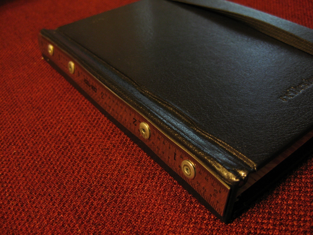

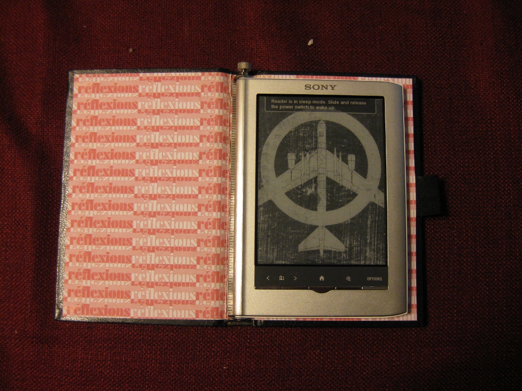

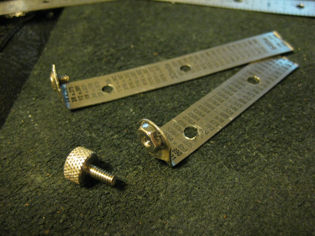

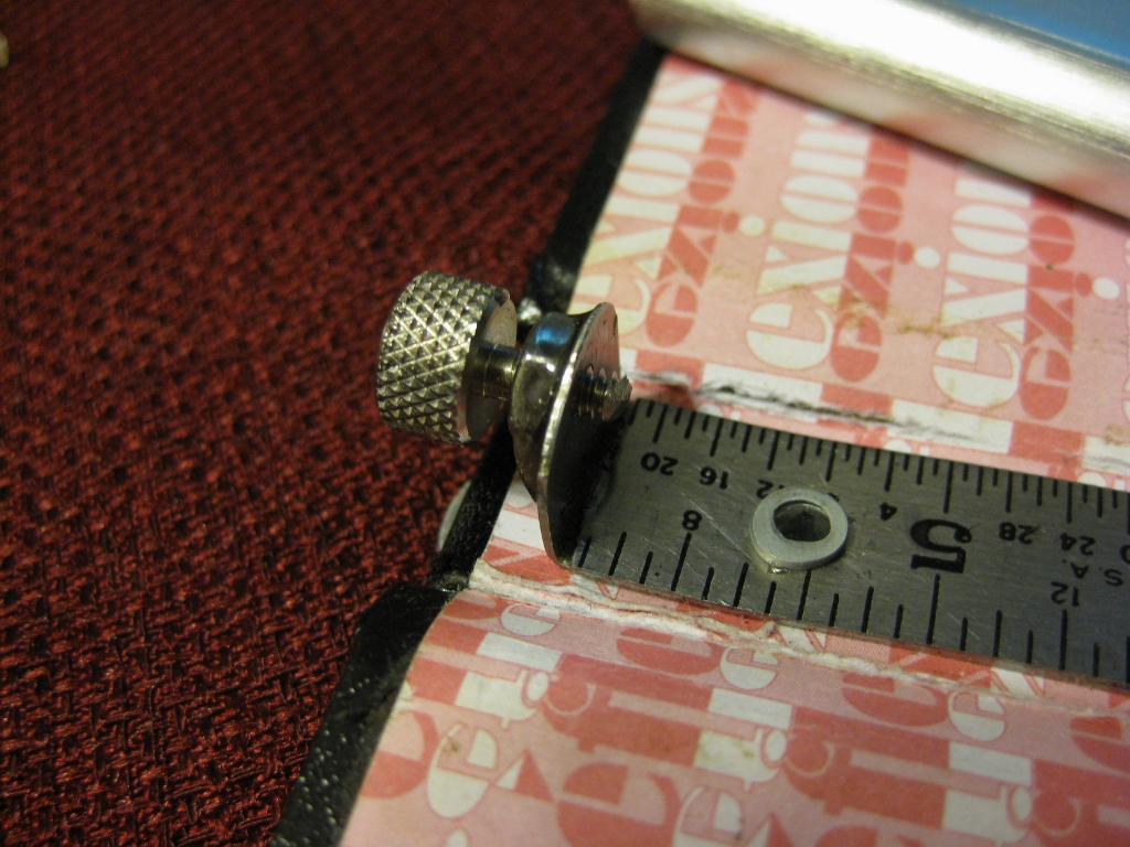

As I mentioned in another post, while I like Sony's idea for mounting their readers, I've hated the plastic spline ever since one failed on me.
The Idea of constantly flexing a plastic mount to get the reader in and out is just plain stupid! It's not an "if it will break", but "when", and then you're left with a useless cover!
So I wanted something:
- durable
- doesn't rely on flexing to release
- takes up about the sames space
- can be mounted onto almost any cover
Here are some pics of my solution. It's made up of 4 pieces:
- a fixed screw end piece
- a screw/nut end piece
- front and back mounting strips
Assemble with pop-rivets or screws

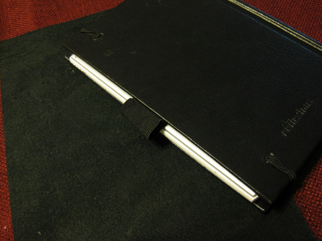

Also pictured is the first cover I made (and the last picture is why it didn't last long -- it wasn't long enough to cover it).
I'll post more later.

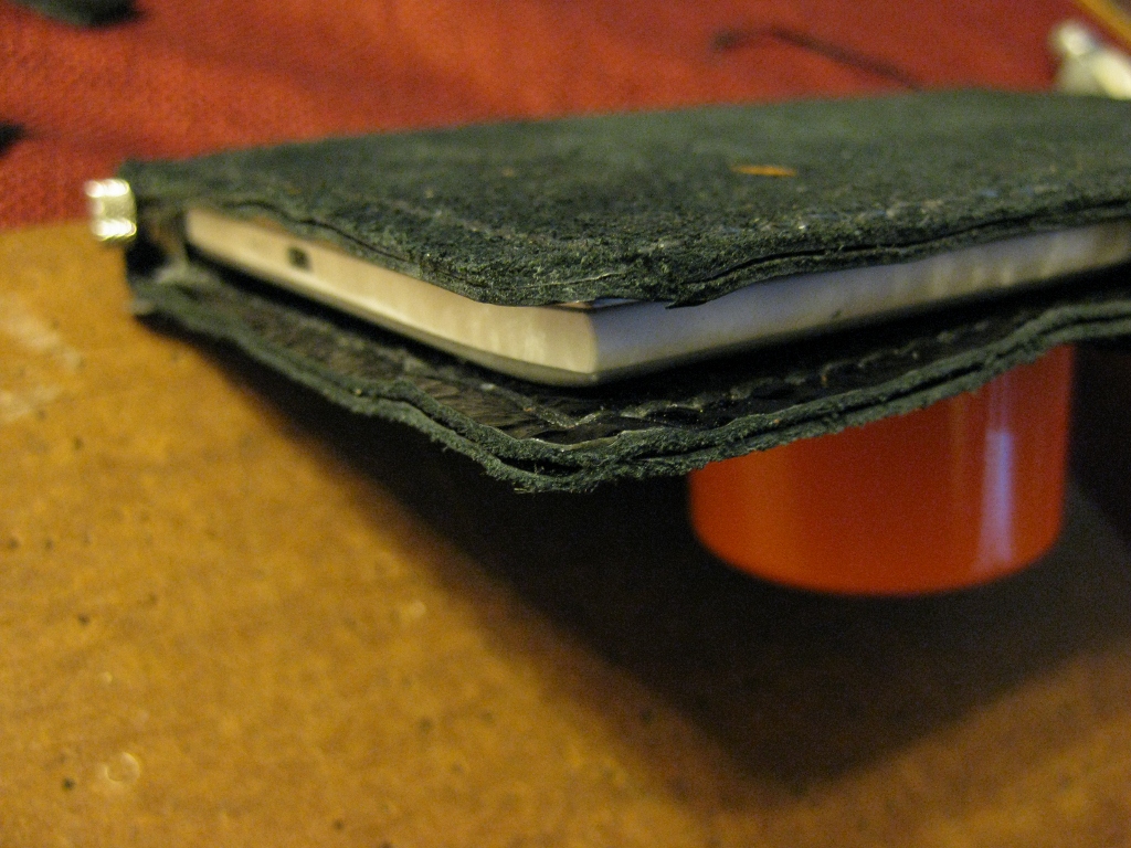

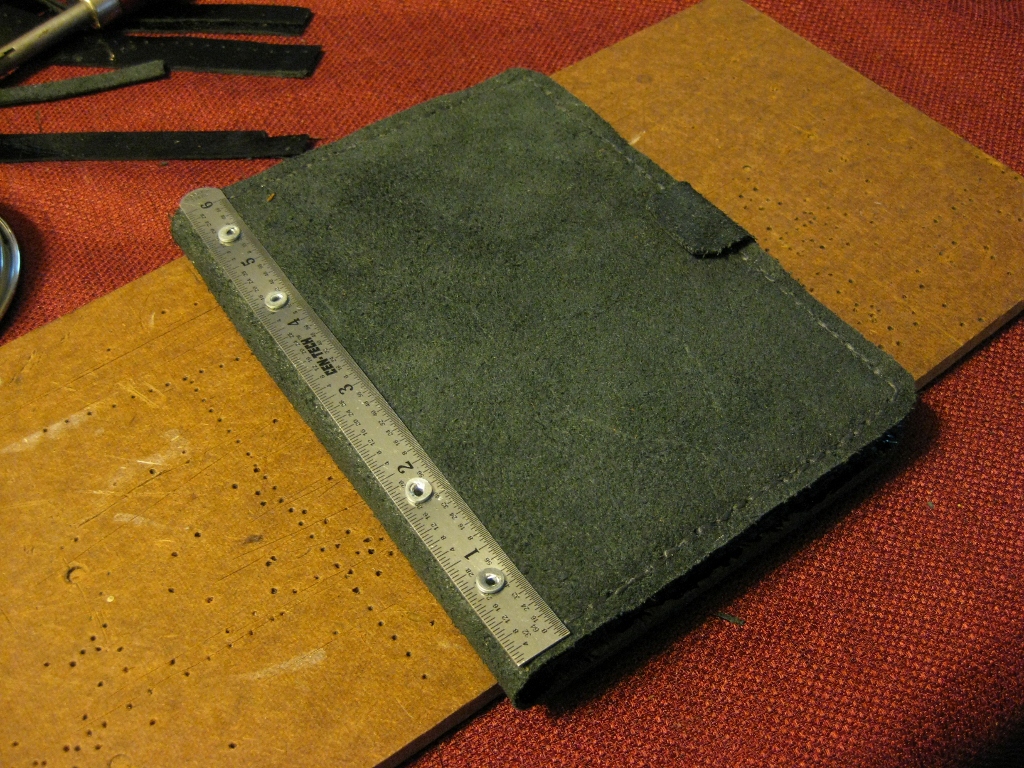

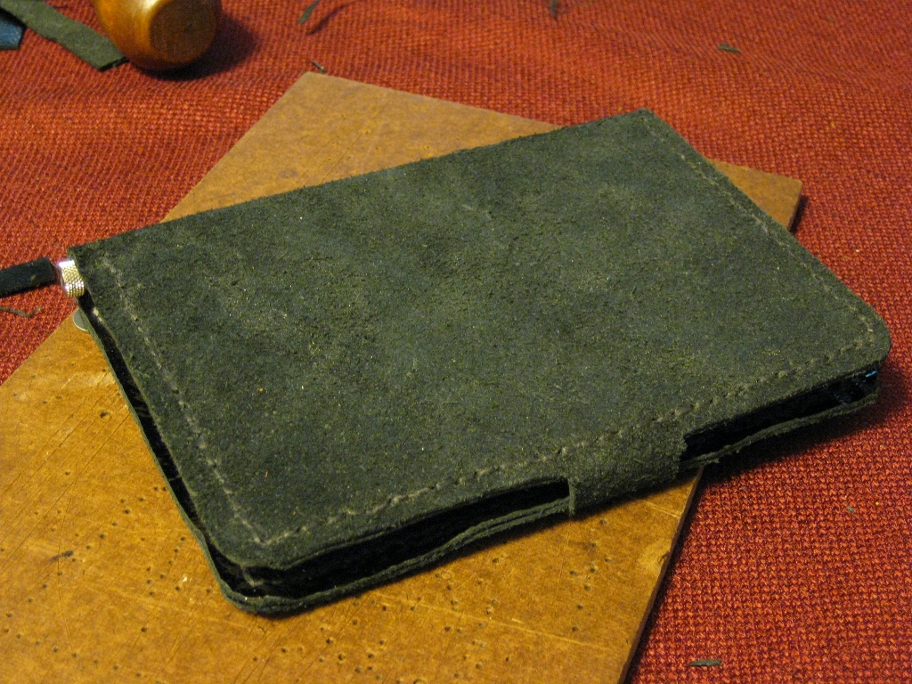

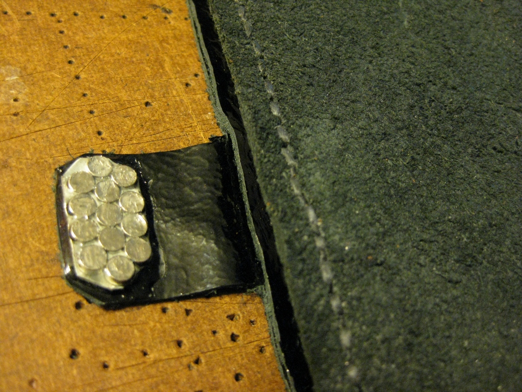

. . . And here's the cover for my 350.
It's made of 3 pieces of leather with two metal cores (top and bottom, cut out of a CD-R drive case). The spine is pop-riveted into the bottom core.
While playing with this, I discovered that there are magnets in the reader itself (NOT the cover!!). The metal cores hold well to the reader.
The outer cover is a single piece of leather, with a tab left for closure. The other two pieces of leather cover the cores.
The closure tab has a set of magnets epoxied onto it. it flips around to the other cover and latches onto the core.
And finally, a 1/4" margin all the way around. A nice solid cover and I'm tickled pink.

I was going to comment "the latch is a good touch. magnets?"
then I read your post. So that's why sony covers shuts well...
Great work. When I broke my cover's spine I will be sure to follow your example.

i dont know whats cooler, your cover or your screensaver!

Do the threads from the screws damage the holes in the reader? I wonder if it would be better to go with a slightly larger screw so the threads could be filed off where it inserts into the reader or put a plastic sleeve on it. That is a nice design you came up with. I wish I new a machinist who could make me one. I could see the ends being a little thicker so a nut could be press fit or possibly threads could be tapped directly into the metal. I would love to get an Oberon cover with this retaining mechanism.
