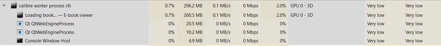

Occasionally, upon first opening an epub in Calibre's viewer, it takes a long time to open (several minutes as opposed to a couple of seconds). Usually, this is just after I've used Calibre's editor to strip out all the publishers' CSS and replace it with my standard set. Once the viewer opens, there's no problem and the delay doesn't repeat itself when I view the book again (even if I have the editor strip out the viewer's files). This doesn't happen with the vast majority of my books. There's nothing special about the books where it happens: the number of chapters (files) is normal (say about 25) and the chapter (file) size is nothing special. AFAICS, there's nothing left in the HTML (or in my standard CSS) that could be causing this kind of slowdown.
This is on Windows 11 Pro x64 (fully updated) with the latest Calibre (6.3). Nothing else is running. Here's a screenshot of Windows Task Manager for the Calibre tasks while it's happening (it's at the top of the list so is what's taking the most resources (even though it's practically nothing).
Sorry I can't figure out how to reproduce it reliably. But, I thought I'd report it in case others run across it. Maybe it's a QT thing?
EDIT: I've tried getting this image down to the forum's recommended size, but it becomes unreadable. it's a pretty small image, so maybe it's ok. If not, let me know and I'll put the teeny-tiny one in.

EDIT 2: When I checked the task manager, I didn't even see Windows Defender churning away. So, I don't think the antivirus is the issue (if it were, I'd have thought it would be at the top of the task list). But, next time it happens, I'll take a look for what Defender is doing in particular.

The viewer converts the format file being viewed to "Kovid Goyal's universal format", and it does that in the calibre cache directory. You can relocate it via the CALIBRE_CACHE_DIRECTORY Environment variable. Might be an idea to monitor what's going on within it.
What happens if you make a minor change to the epub content (i.e. the text , not the markup) - that should trigger the 'first read' process.
I doubt it will be anything to do with Defender, too many people use it without any troubles.

Once the viewer comes up for one of those long-load-time books, subsequent loads are normal (well, I assume they're normal -- I haven't run across one of these instances that happens more than once on any given book). Editing the book doesn't make a difference.
Regarding the cache directory, is it supposed to be set? There doesn't appear to be any Calibre environment variables set anywhere. ...\AppData\Roaming\calibre\caches is empty and I don't see a cache directory anywhere under ...\Program Files\Calibre2. Of course, even if there were problems there, I'm on a NVME only system, so loading times shouldn't be in the multi-minute range for a ~ 1MB epub.

The Env Vars are used to override the 'internal' defaults, so they are not normally set.
I think the default cache directory location is within the configuration directory - so, in Windows that would be c:\users\<username>\appdata\roaming\calibre\cache. I've used the Env Vars to put the configuration on my HDD Data drive alongside my libraries, and the cache is on an SSD.
Start utilities have been know to interfere with calibre's functioning - e.g. things that purport to clean up temporary files dynamically.

The first time a book is opened it can be slow as the viewer has to preprocess it to make it suitable for display. Same thing happens if the book is edited since the preprocessing has to happen again. Depending on the size/complexity of the epub this can take a little while.
Yep. When I view a book for the first time, I get that "preparing book for first read" notification. But, 99% of the time, that blurb lasts only a second or two. In these rare cases, it's taking several minutes (time enough for me to pop over to the Task Manager, open the Snipping Tool and take a screenshot without mussing my hair). After it finishes loading (and I quit the viewer), if I go into the editor, do a Tools > Check Book, tell it to remove the bookmarks file, save it, and then restart the viewer, it'll load in its normal couple of seconds (with the "preparing book for first read" again popping up).
But, now that you mention it, I'm not sure if the viewer is taking a long time at the "preparing book for first read" point or if it's on one of the "loading book" points. I'll try to pay more attention the next time it happens.

Just happened again with another book. It's taking all that time at the "preparing book for first read" task. According to Task Manager, nothing much is running (the Calibre stuff is taking the most resources (though they're a miniscule amount)). Nothing fails, so there's nothing in Windows' Event Viewer. Closing the viewer and immediately re-opening takes the normal couple of seconds. Closing the viewer again, editing the epub, removing the viewer bookmarks file, saving and re-opening the viewer takes the normal couple of seconds.
I'm pretty much stumped for what could be causing this and how to track it down. Perhaps it's a Windows 11 issue. I'll stick my system information here and maybe over time other people will run into the issue and can use it as a comparison:

Preparing book for read uses worker processes under the hood. With these kind of mysterious slowdowns on windows, I usually suspect the antivirus. It's likely subjecting the worker process to blockage/slowdowns occassionally.
