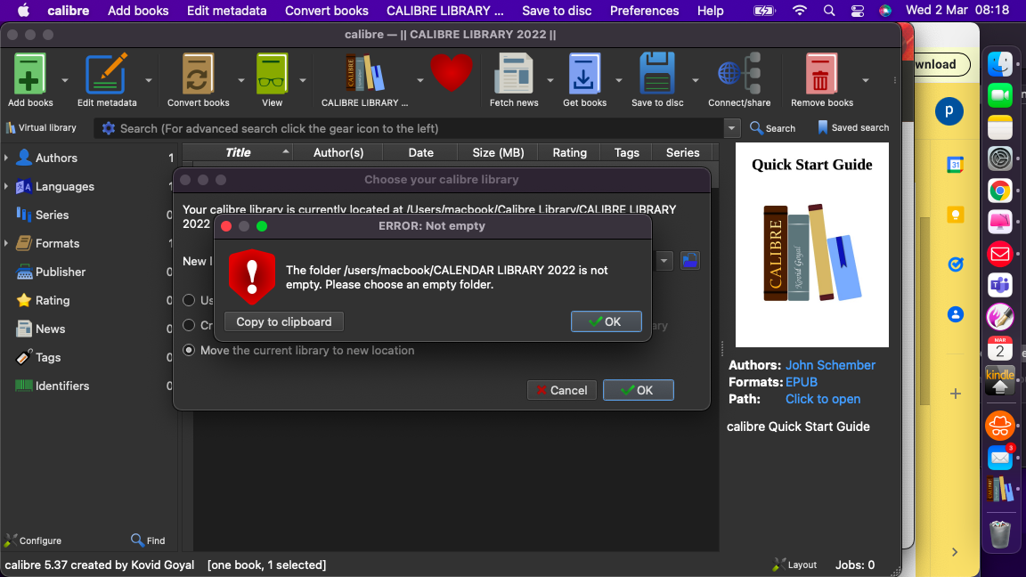

When I try to Switch/Create Library, I choose an empty subfolder. When I click OK, I am told that the subfolder cannot be. used. I attach screen-captures that I hope may make my predicament clear.

I just cannot get that to work. I have again attaached screenshots, which I hope will show what is happening. I am. truly grateful for your help.

Basically, check the new library folder and delete any files, directories, whatever that are in it. What calibre will expect to see is an empty directory. An example from Terminal is:
davidb@Davids-VMMac calibre % mkdir "Calibre Library 2022"
davidb@Davids-VMMac calibre % cd "Calibre Library 2022"
davidb@Davids-VMMac Calibre Library 2022 % ls -alr
total 0
drwxr-xr-x  3 davidb  staff  96  2 Mar 08:32 ..
drwxr-xr-x  2 davidb  staff  64  2 Mar 08:32 .
If ls -alr shows files/directories, you can use rm to remove files in the directory and rmdir to remove directories but be very careful that you are in the right place before doing this.

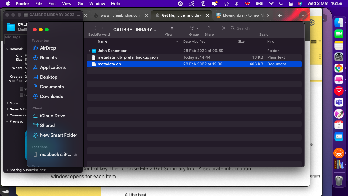

I have checked the identity of the folder using Get Info, and the result is as shown in the screenshot attached to this message. I thought that mdtadata.db WAS the Calibre Library, Again, my thans.

What this looks like is that you started a transfer and then it was not completed unless you have only one author in your calibre library . You might want to check if whatever books in that location are still in your old library. If so, just delete those files/directories. Otherwise, copy the author name folder elsewhere and then import the books in it after your main library is copied to the new location.

That is a fresh install, default New Library.
(that book is the users guide)
