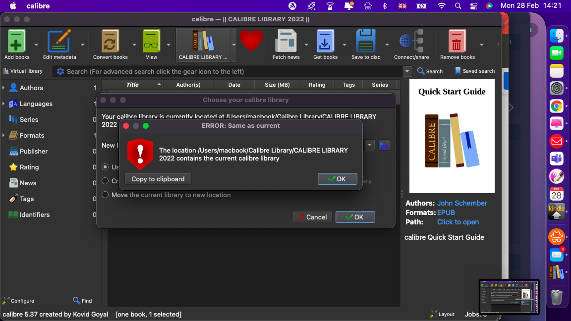

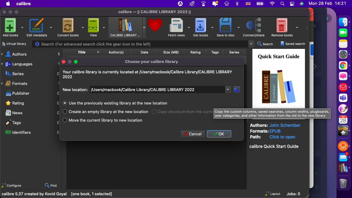

When I try to Switch/Create Library, I choose an empty subfolder. When I click OK, I am told that the subfolder cannot be. used. I attach screen-captures that I hope may make my predicament clear.
First create an empty folder.
He then tells calibre to create a new library.
(Second option) with the path of the folder that I created at the beginning.
What the first image says is that he is going to use an existing library in that place.

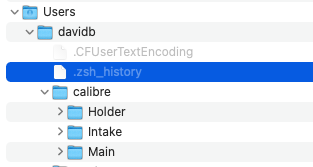

You are attempting to create a new calibre library inside an existing calibre library. I would suggest creating your new library as /Users/macbook/Calibre Library 2022 instead. Or create a new directory called calibre and move the existing calibre library into that directory and creating a new library inside the calibre directory. See the attached image for what I mean (I use 3 libraries, Intake where books are imported and worked on, Main where most books live and Holder for books which I am having issues with.

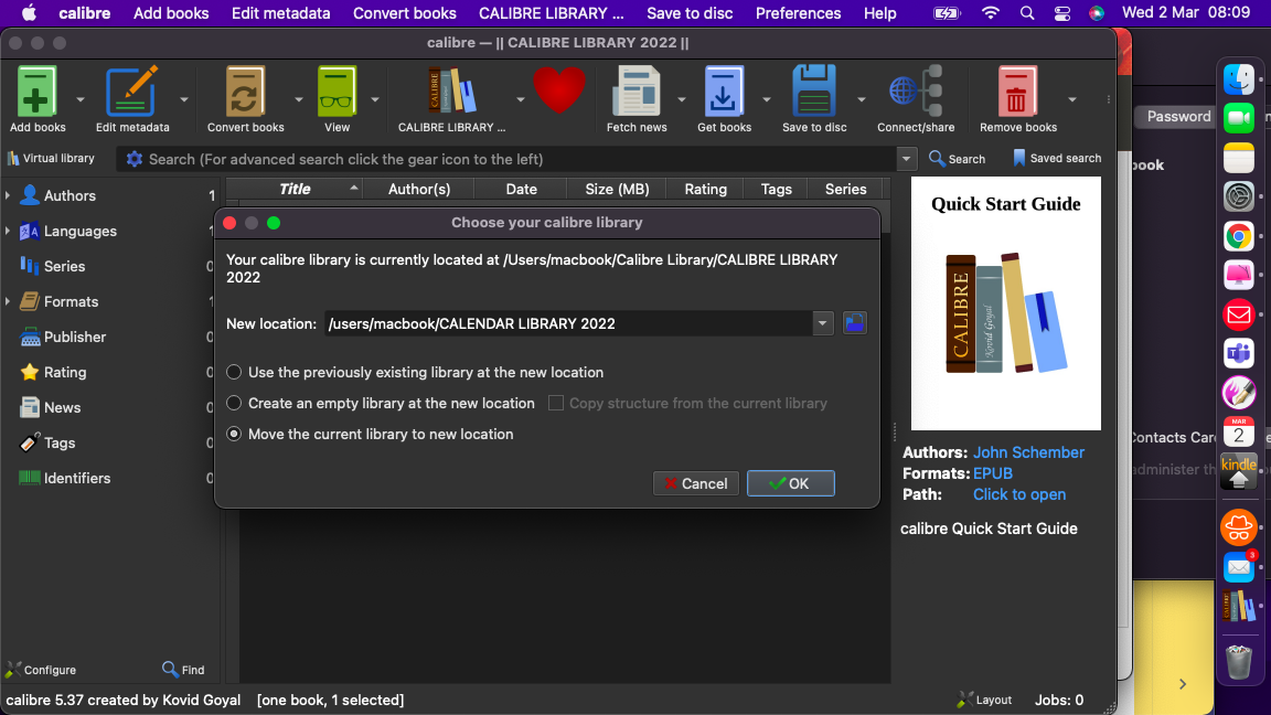

I just cannot get that to work. I have again attaached screenshots, which I hope will show what is happening. I am. truly grateful for your help.

Basically, check the new library folder and delete any files, directories, whatever that are in it. What calibre will expect to see is an empty directory. An example from Terminal is:
davidb@Davids-VMMac calibre % mkdir "Calibre Library 2022"
davidb@Davids-VMMac calibre % cd "Calibre Library 2022"
davidb@Davids-VMMac Calibre Library 2022 % ls -alr
total 0
drwxr-xr-x  3 davidb  staff  96  2 Mar 08:32 ..
drwxr-xr-x  2 davidb  staff  64  2 Mar 08:32 .
If ls -alr shows files/directories, you can use rm to remove files in the directory and rmdir to remove directories but be very careful that you are in the right place before doing this.
