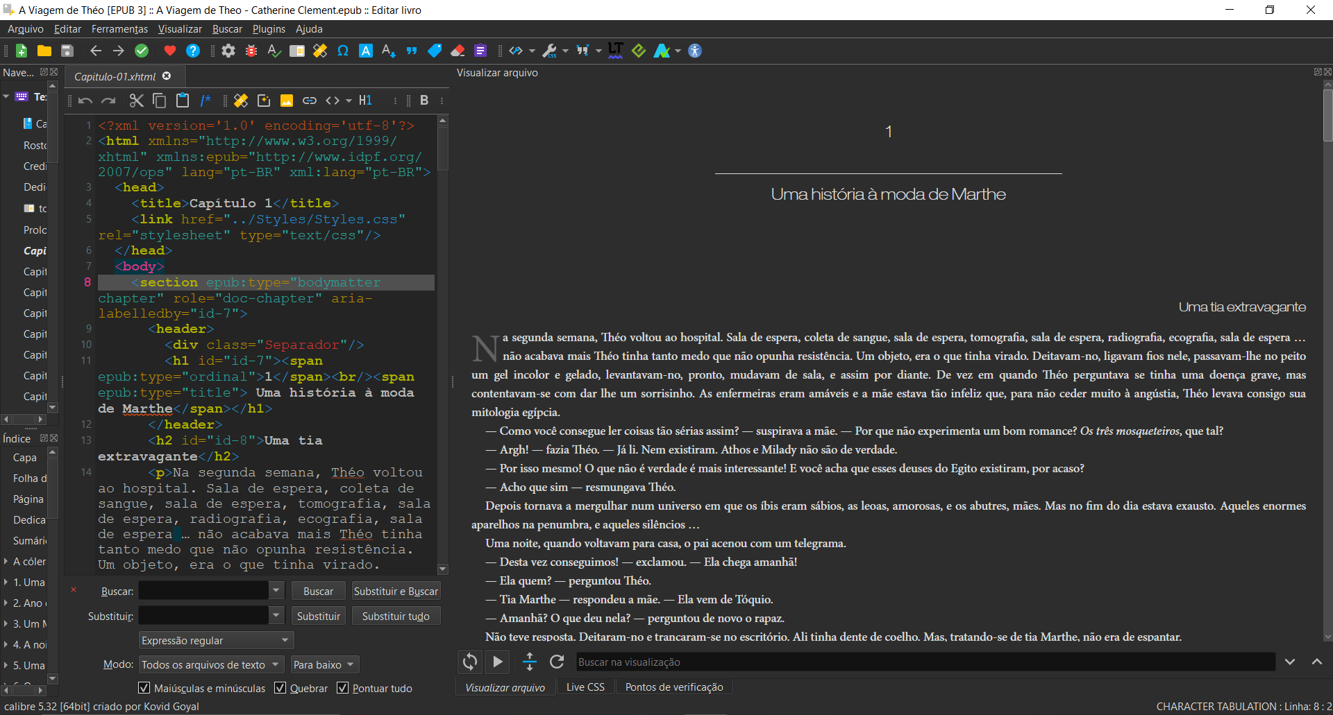

Hi I hope somebody can help, because it's driving me crazy. every time i open the editor the user interface is incredibly annoying. the sidebars are sized so i can effectively can't work with it and have to drag them back in place.
Most of the time i have to open multiple files, and every one i open it is back to the annoying dimensions.
is there a way to change or lock the borders?

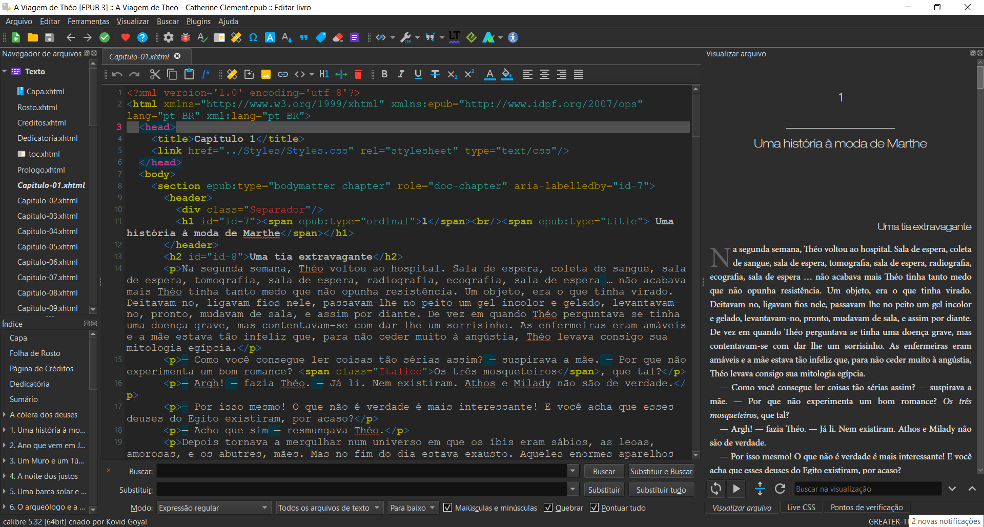

This is my setup:

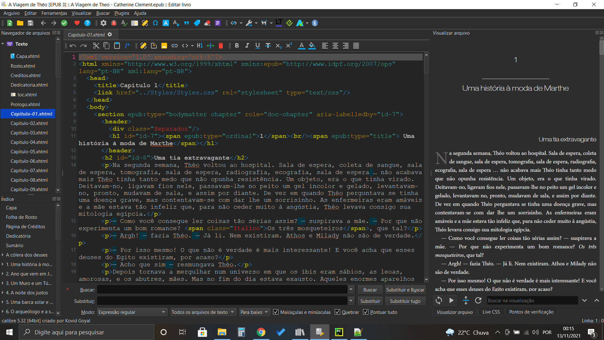

On Windows 10 Pro x64 this is what I get:
1) With the Editor open, press CTRL+F to open Find and Replace. The layout looks like this:
Name:	2021-11-13 (Before).png
2) Close the Editor just like on the image above.
3) Open the Editor, and now it looks like this:
Name:	2021-11-13 (After).png
This happens every time.
