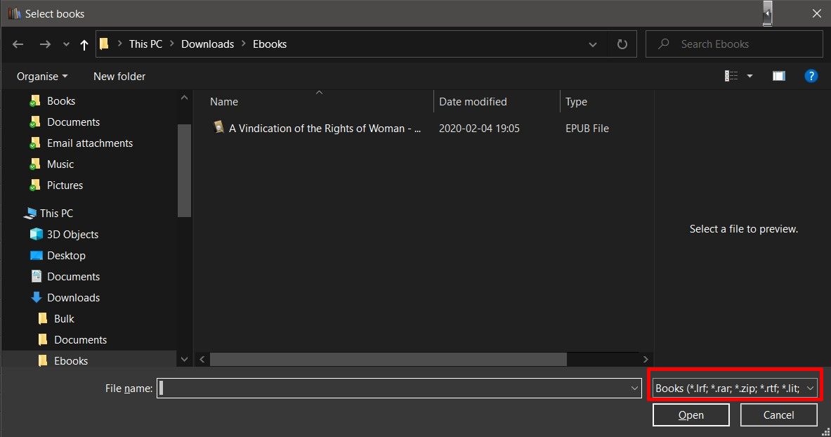

are there any ebook files in the folder
Name:	Screenshot 2021-11-10 104709.jpg
Try changing the file type selector to All files

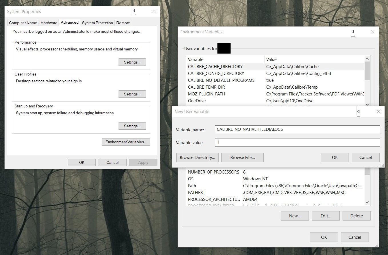

Originally Posted by abrogard View Post
User variable. thanks.
What name do I give the variable? I mean is that the name? Or I give any name and that is the 'value' ?
all kinds of files in the folder. It is a subfolder in my windows 'downloads' folder. I create them from time to time and shunt all the downloads off into them to clear a space.
so there's everything/anything in there.
p.s. the problem comes before any question of file types. the system won't allow that folder name into the selected file field.
Or any folder name. I should make that clear. It's any folder. I can't get it to accept a 'single folder' add books thing.
Name:	Screenshot 2021-11-10 161657.jpg
FWIW I don't use the Add Books dialogues, I prefer using File Explorer->Send To to add books.

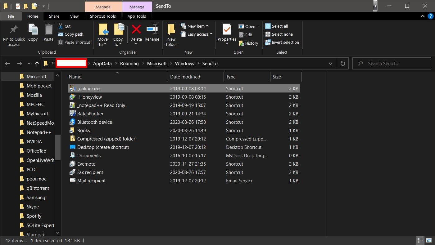

If you want to try my trick, you need to have a shortcut to calibre.exe in the SendTo folder. Easiest way to find the folder is WinKey+R, type shell:sendto and press Enter.
Create a shortcut on your desktop and move it to the sendto folder.
Name:	Screenshot 2021-11-10 211200.jpg

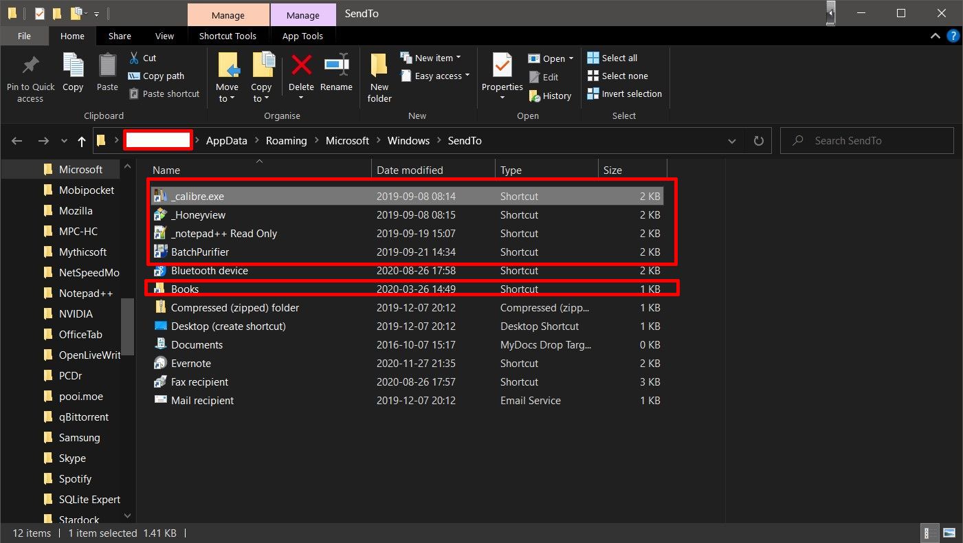

Could you post a screen shot of what doesn't work.
The boxed items in the attached screen shot were added by me, I'm not sure about the Evernote item, I may have added it, or the Evernote install might have added it. Can't recall why I added Books (it's a calibre library), but I will get rid of it, sending anything there will 'corrupt' the library
