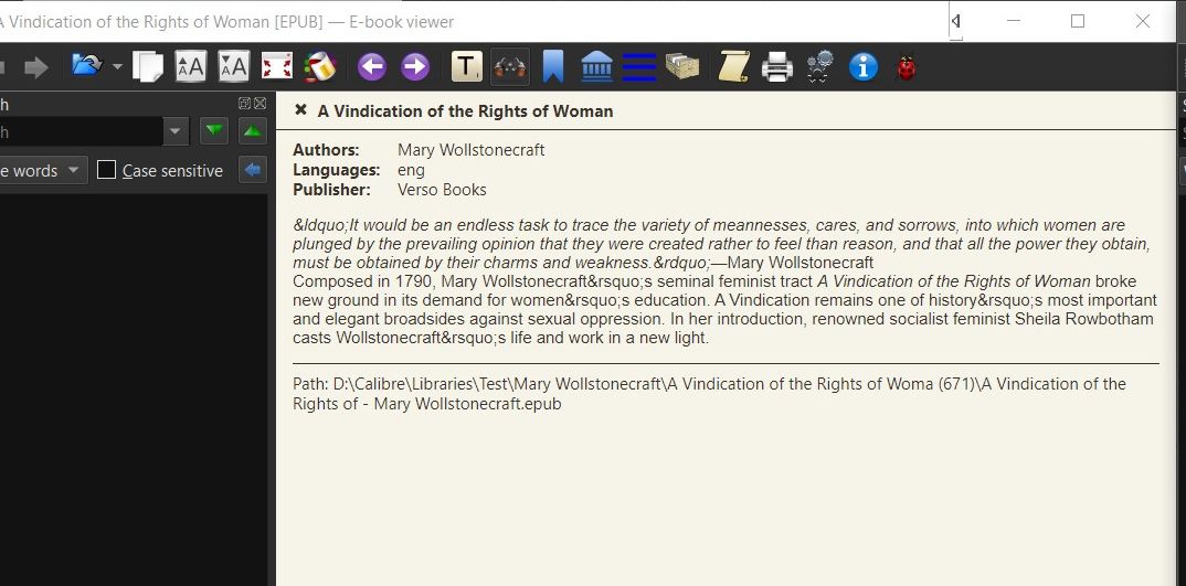

Originally Posted by Thom* View Post
Using the Viewer in Calibre v4 I could display the Meta Data and the "Description" was displayed.
I recently upgraded to Calibre v5 and the Viewer does not display the "Description" with other Meta Data.
Is that intentional, a bug, or am I missing something?
Ok here
Name:	Screenshot 2021-01-19 093450.jpg
Are you sure the Description is in the format your viewing, I just fell into that rabbit hole. It was in the library metadata database, but not in the epub. You need to use Polish Book to get it in the epub.
I clicked the blue circle 'i' to get that display, Ctrl+F11 to toggle the toolbar (same as always)
Oops, I can't get the attached file.
Oops too Read my modified post

As well as including Python 3, calibre version 5 includes a new version of the Qt libraries.
There were a number of issues in the new Qt that related to Comments. I can't recall the details, I suspect you've ran into one or more of them. In the example I posted it seems to have barfed on left/right double quote entities - no idea why, maybe it wants unicode - in the scheme of things a mere bagatelle
