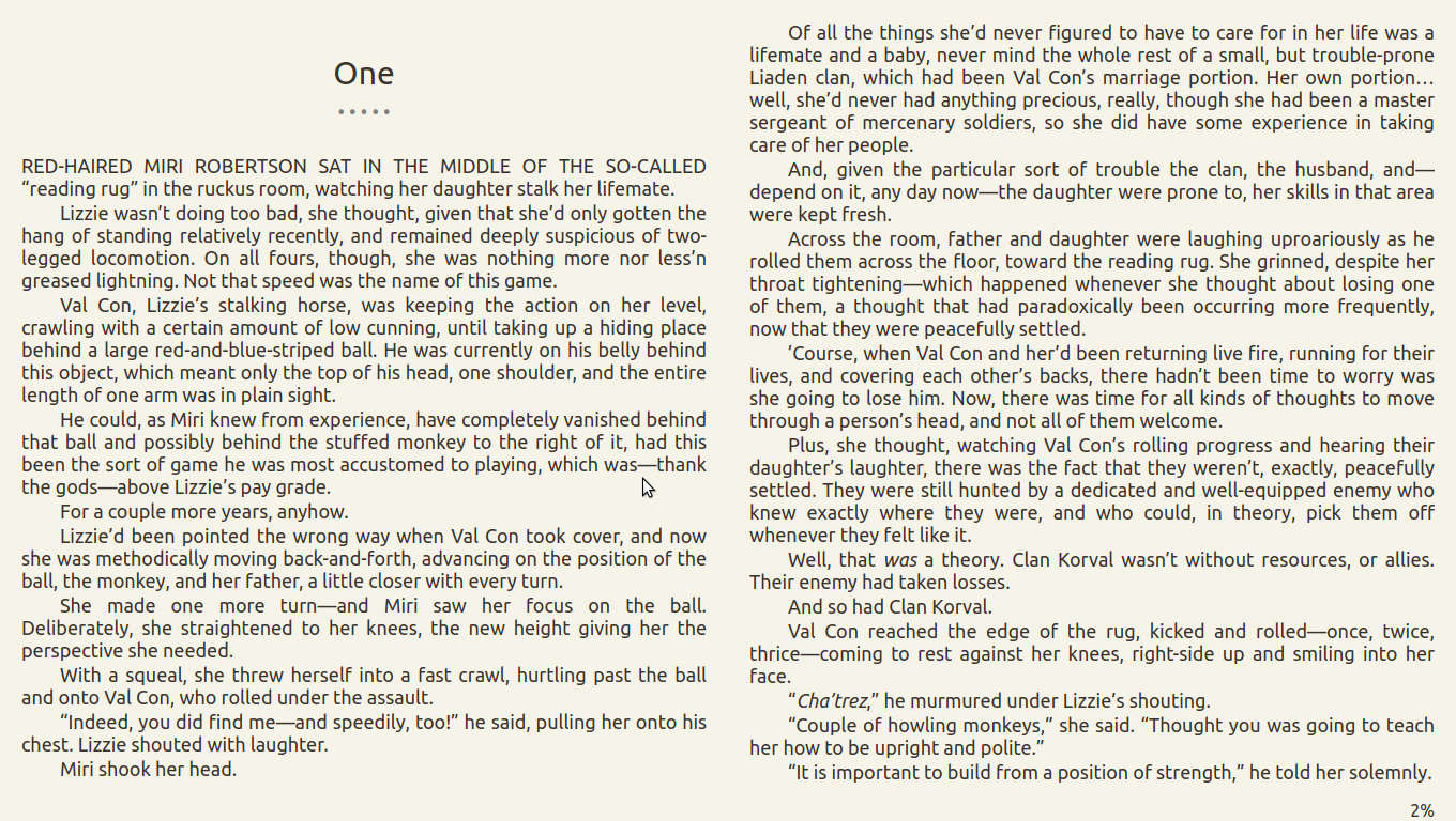

I'm reading the Kindle edition of Sharon Lee and Steve Miller's "Accepting the Lance" in Calibre. In Calibre 4.21 there is an issue with the first line of each chapter, wherein it extends several words beyond the right margin before the linebreak occurs.
Changing preferences in the calibre from "Paged" mode to "Flow" fixes the problem.
I have not been able to recreate the issue in Calibre 3.x. Likewise on my actual Kindle paperwhite it displays fine.
so I'm left to guess it is either a Calibre problem, or something weird in the CSS or html. While I'm no expert in either, they both look fine to me.

here's what it looks like on the page:

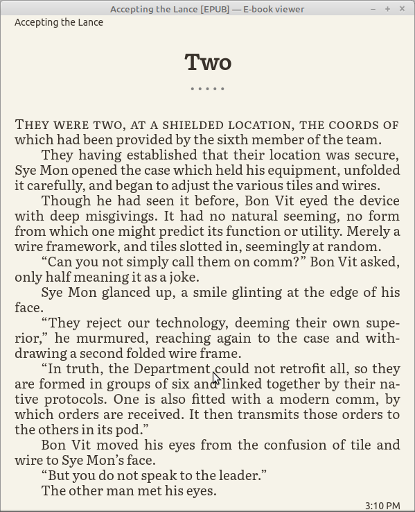

It appears to be a calibre viewer problem. This is what i did:
.pcalibre:first-line {
/* text-transform: uppercase;*/
font-variant: small-caps;
Name:	Screenshot from 2020-07-19 15-10-50.png
Using the unmodified epub shows normal in the server viewer.

@GBM, I didn't think of small caps, but may change it, if it works for you it'll likely work for me. thanks!
@JSWolf
AZW3, or AZW3 converted to EPUB. works the same way on both.
