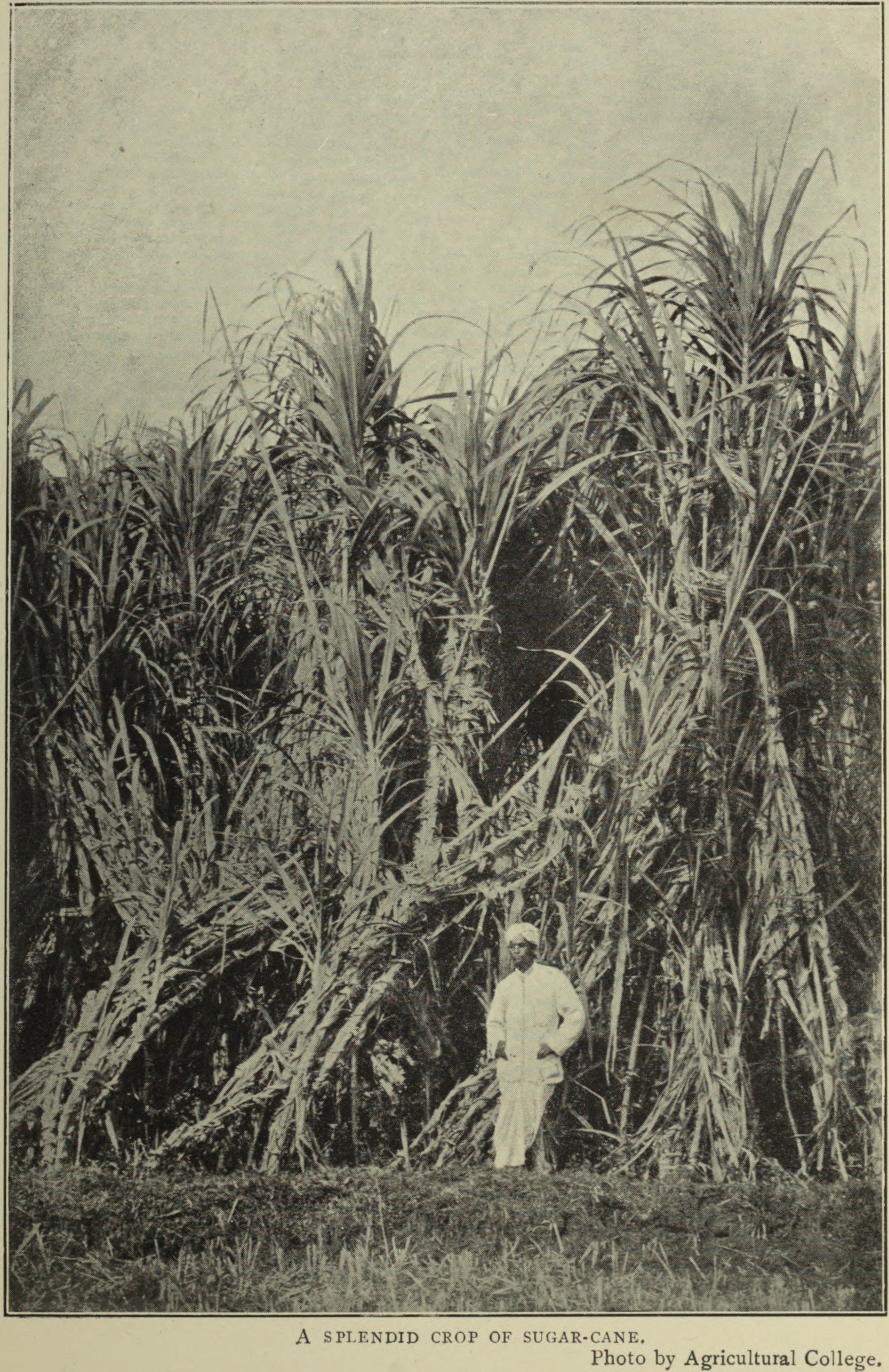

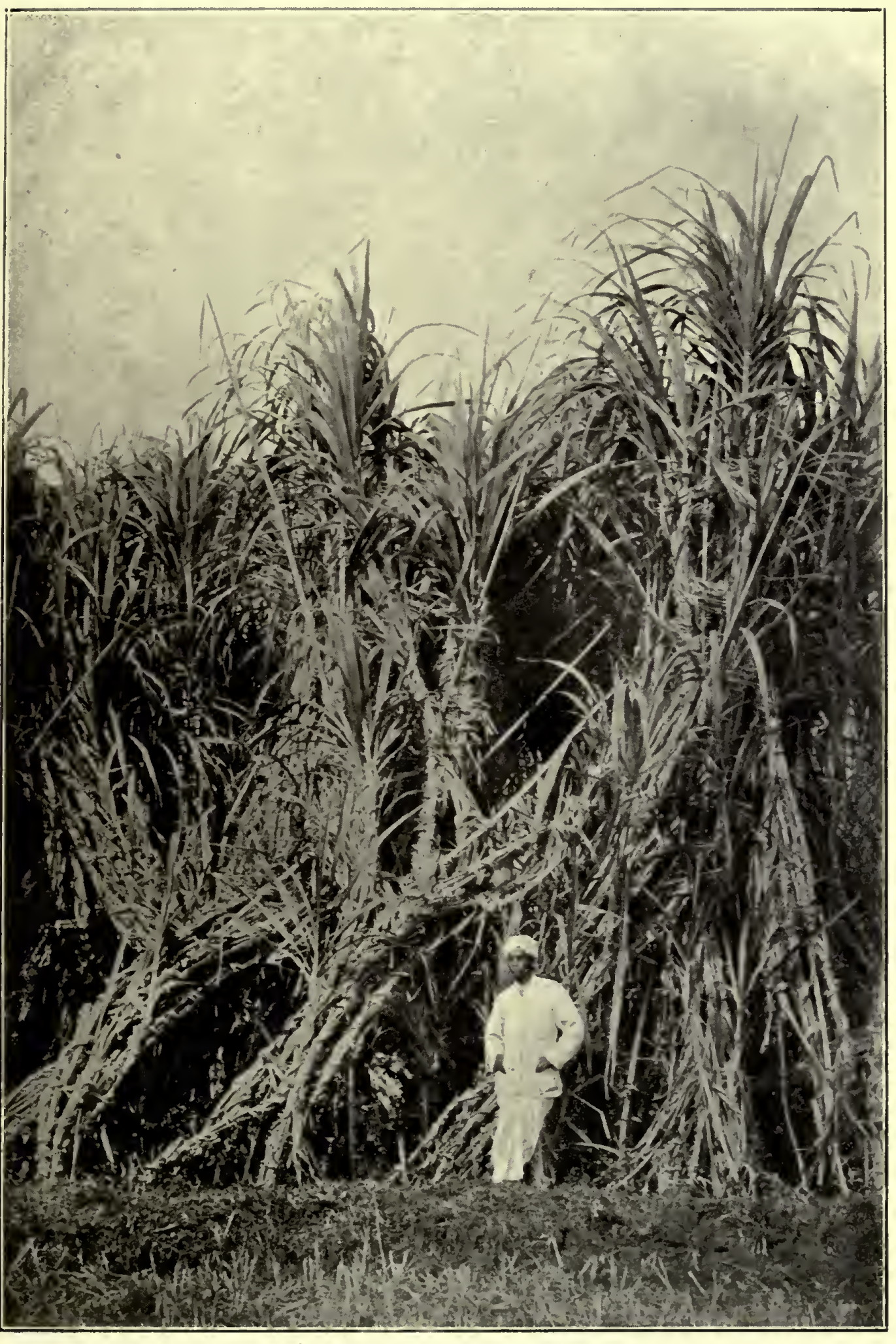

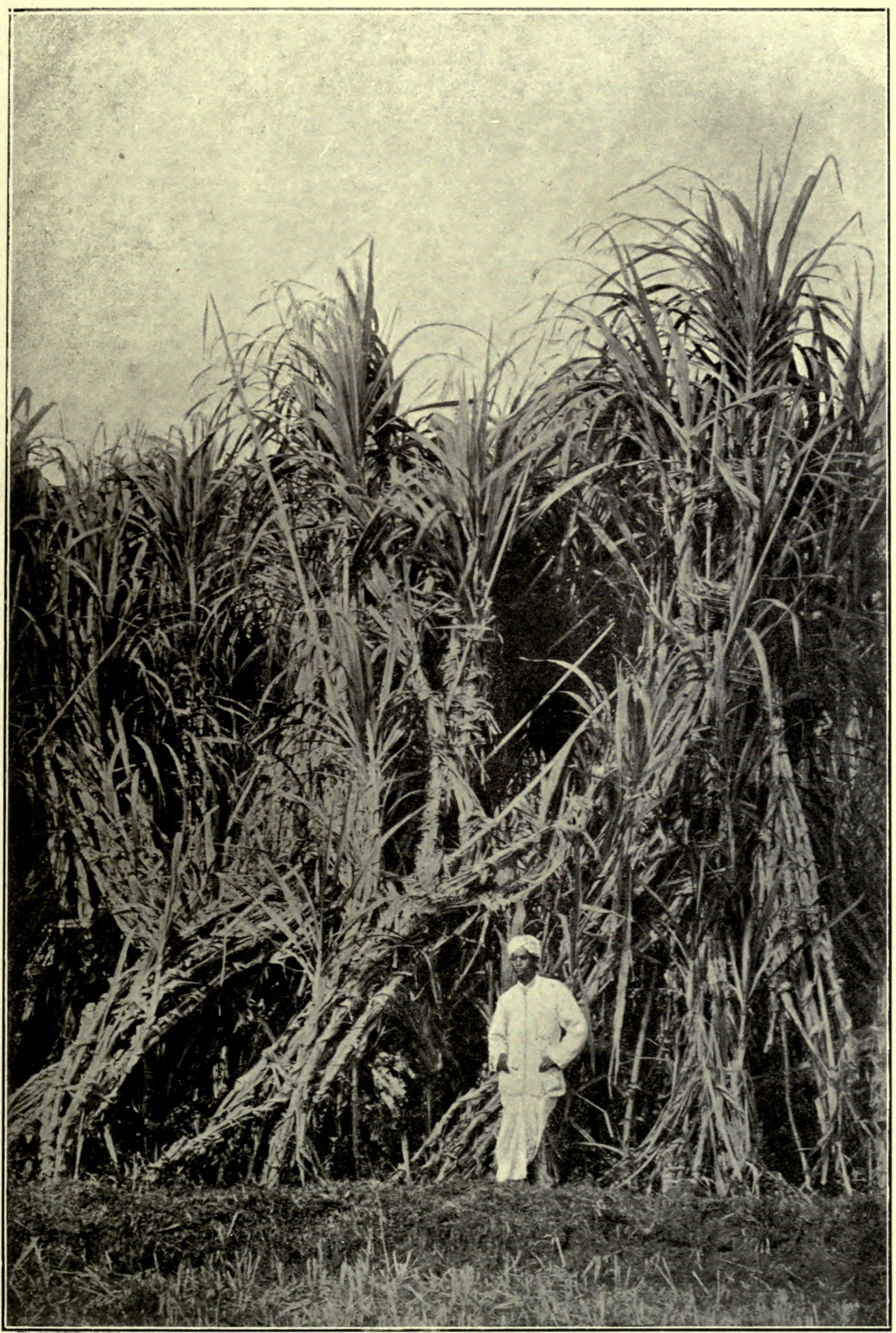

Compare the "Color PDF" vs. the "JPEG 2000" image on page 6:
ID:	177623 Click image for larger version
If you zoom in, you can see the detail was completely mangled in the PDF version.
From there, you may want to do further image cleanup. (Removing the yellowing, restoring to grayscale, etc.)
Here are a few topics where that was discussed:
GrannyGrump's fantastic thread "What’s your “image rehab” routine?"
SBT's "Image cleanup tips"
(Everyone has different ways/methods/tools.)
If you want quicker/easier cropping, you could also use Scan Tailor Advanced. I wrote about it just a few weeks ago in:
Optimize PDFs from archive.org for E-Ink devices
but you would have to convert those JPEG2000 files into PNG or TIFF.
Using Scan Tailor Advanced, here's the image I was able to crop within a few minutes:
