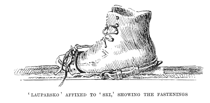

This is a continuation of a discussion started on the "ebooks we're working on" thread:
Originally Posted by SBT
Since that posting, I've discovered the wonderful world of the G'MIC plugin for GIMP, which can make a lot of difference, especially for line drawings.
G'MIC offers an overwhelming number of filters. Which ones are best suited for the rehabilitation of line drawings and what settings do you usually use?
My aim when restoring a scan of a line drawing is:
  • Remove noise.
  • Increase grayscale range, i.e. make the white parts white and the black parts black.
Short walk-through with gimp with G'MIC plugin installed:
Used this image from "First crossing of Greenland", F. Nansen.
  • Crop image
  • Select Colors->Desaturate: Luminosity

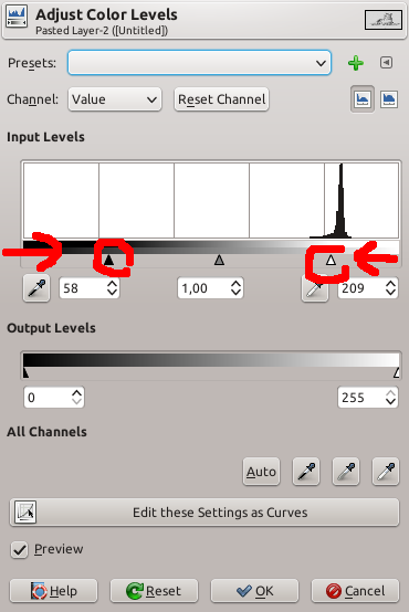

  • At this point, I used to just clip the greyscale range using Colors->Levels. Problem is, this easily either removes bits of the drawing, or leaves noise in place. So..

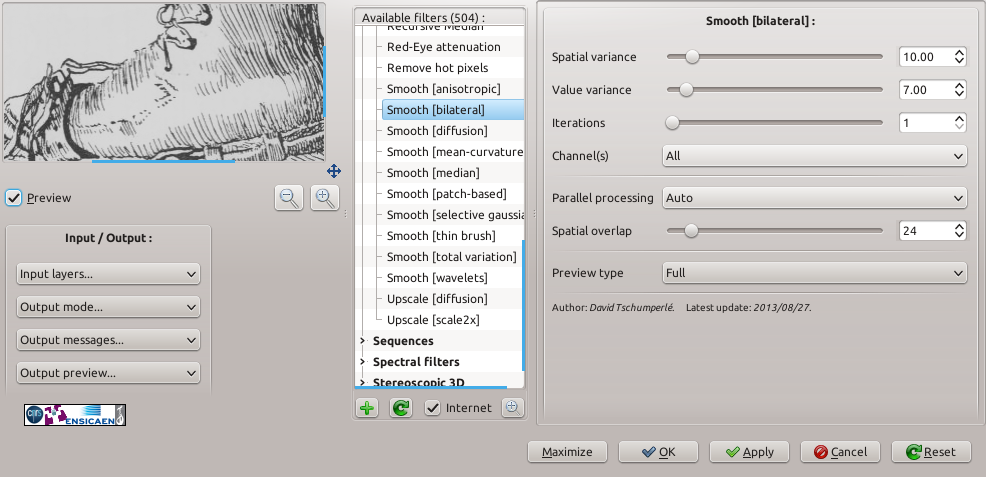

  • Select Filters-G'MIC:Smooth->Bilateral. You can reduce the default settings if you like, one iteration is probably sufficient. Click "Apply"
  • Still in the G'MIC window; select Details->Sharpen[Inverse diffusion]. Click "OK"
  • Now, go to Colors->Levels, and reduce the range to make the white bits white and the black bits black.

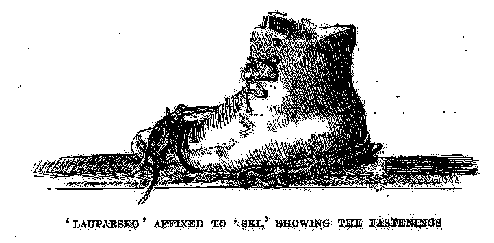

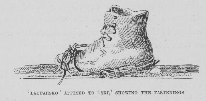

I would recommend some additional touches.
First, convert the image to true grayscale (may save some bytes, speed up processing, and avoid adding unwanted colour): Image -> Mode -> Grayscale.
Add a new black layer on top, and change its mode to "Burn" (I think that's the right English name, my Gimp is translated). This will show all the pixels either black or white, everything that's pure white in the image, stays white, but the slightest off-white becomes black. I find this very useful to detect noise and speckles that would be more noticeable in an e-ink screen.
Make sure you select the bottom layer (the image), or add an empty intermediate layer (to make it easier to correct mistakes, compare before/after, etc.), and paint white the areas in the background that should be white. Zoom in if necessary. When in doubt whether a particular spot should be white or not, disable the black layer to see the real image, it should be clearer then.
When you are done, disable or delete the black layer and save the cleaned up image.
This is especially useful when you are going to make the background transparent, but in any case it will also save additional bytes (plain speckleless background compresses better).
