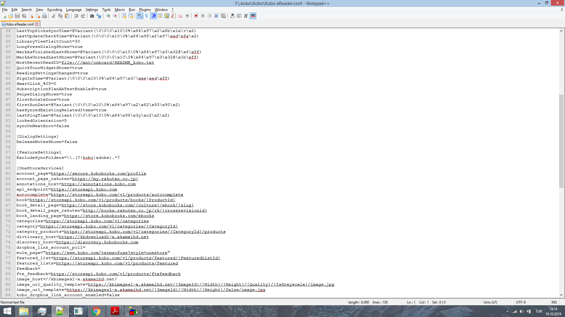

I just got my Libra and i am trying to install koreader on it. However, I couldnt make it
The steps i took are:
I have downloaded koreader-kobo-2019.09.3-84
I have installed KFMon by extracting its files. Then my libra rebooted so i think it was successful .
Then I extracted the koreader i have downloaded to libra's root file but it did not rebooted so i have read the note at the one click install thread which say i have to prevent nikel from checking hidden files. To do that i have appended the code given to do that to Kobo eReader.config file. It looks like in the picture at attachment.
Later, i have deleted koreader from Libra, and unplugged libra. Then i plugged it again, extracted the koreader files again .However, it still did not reboot .
I feel like i am missing a simple thing.
I will be very happy if anyone can help.Thank you

@akifcaglar:
Originally Posted by NiLuJe
NOTE: For proper Kobo Libra H2O support, you'll need to use KOReader version 2019.10 or newer.
(https://github.com/koreader/koreader...orma-libra-h2o)

Well, you could wait until @NiLuJe updates the one-click package with KOReader 2019.10, but I think it should be as simple as:
1. Use the one-click install package as instructed. (At this moment KOReader should fail to start properly on the Libra.)
2. Overwrite the /mnt/onboard/.adds/koreader directory (or wherever it's installed to) with the latest release.
Edit: four minutes too late.

Wow you guys are fast, thank you so much to both <3
It worked with version 10 ^^. Actually, i have seen that version 10 warning but i also have seen people who got managed to make it work with other versions, so i have tried too.
KOReader looks avesome, thank you so much for such a nice app <3
