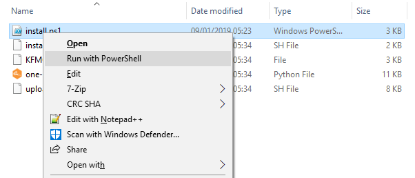

Windows:
  1. Check the previous message, and download the ZIP package that you're interested in.
  2. Download the Windows install script, in the same folder.

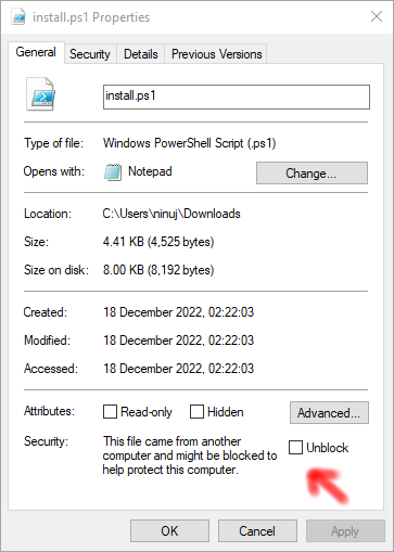

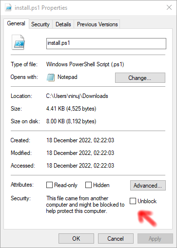

  3. On recent Windows versions (i.e., when running PowerShell >= 7), you'll have to "unblock" the script to allow it to run. (Right Click > Tick Unblock in the bottom-right corner).
    That should look like this (before ticking the box):
  4. Run the install.ps1 script with PowerShell (Right Click > Run with PowerShell).
    That should look like this:
  5. Follow the on-screen instructions.
  6. Safely eject your Kobo, watch it process & reboot .

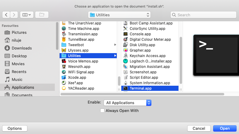

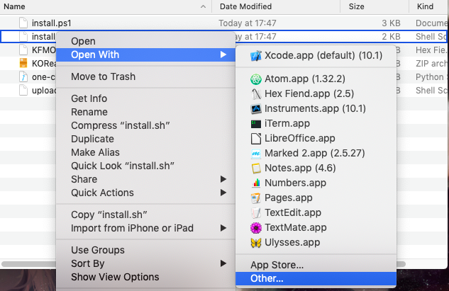

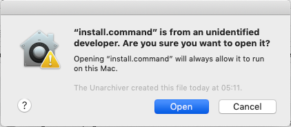

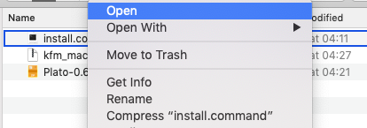

macOS:
  1. Check the previous message, and download the ZIP package that you're interested in, remembering the macOS/Safari quirks I mentioned above.
  2. Download the macOS install script archive, and unzip it in the same folder.
  3. Run the install.command script (Right Click > Open > Then click Open in the GateKeeper popup).
  4. Follow the on-screen instructions. Close the window when it's done.
  5. Safely eject your Kobo, watch it process & reboot .

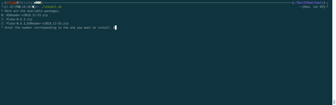

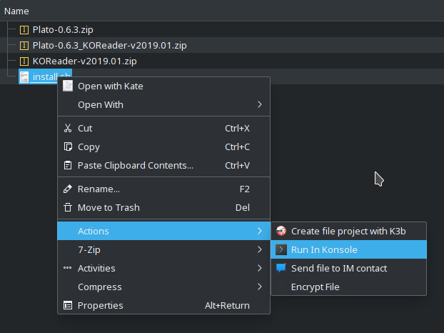

Linux:
  2. Download the Linux install script archive, and unzip it in the same folder.
  3. Run the install.sh script with your favorite terminal emulator.
    Here's how it looks like on KDE:
And that's it! For reference, here's how the script's output could look like:

Is it compatible with kobo forma? And also can't download Window install script.
