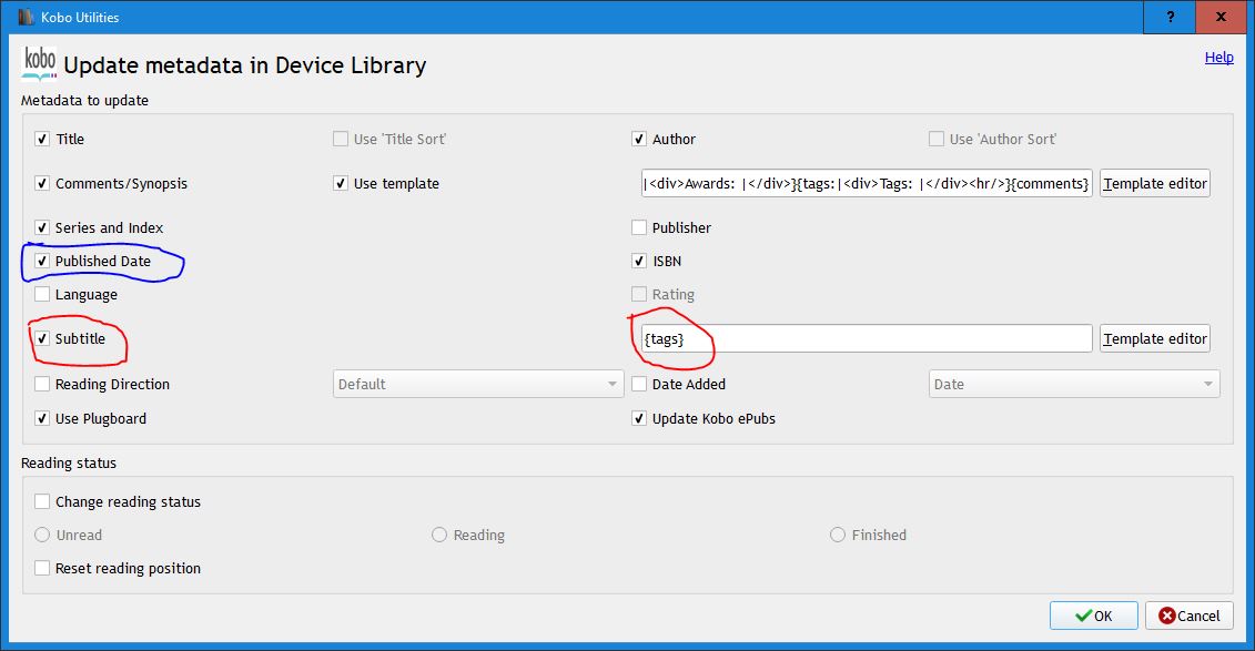

Yes. There are a couple of ways you could try. Both of them will need you to also install the Kobo Utilites calibre plugin. Then use its option labelled 'Update metadata in device library'.
Which one you use would depend on whether you prefer to see the tags info in the main book list or whether you want to see it appended/prepended to the book synopsis when you look at book details via the Kobo View Details menu option.
The former (in booklist) is the simpler option if you're not comfortable with calibre's metadata plugboards. See the 2 red circles in the attached screencap. The tags info will appear in the book list, under the book title. As a bonus it will also automatically appear under the book title shown on the View Details page.
See the blue circle in the attached screencap for a very simple way to show calibre's publication date in the Kobo book details (DETAILS tab in the Publisher field).
Exactly what I was looking for. I had read through the forums and searched quite a bit, but just could not find it. Thanks so much!
