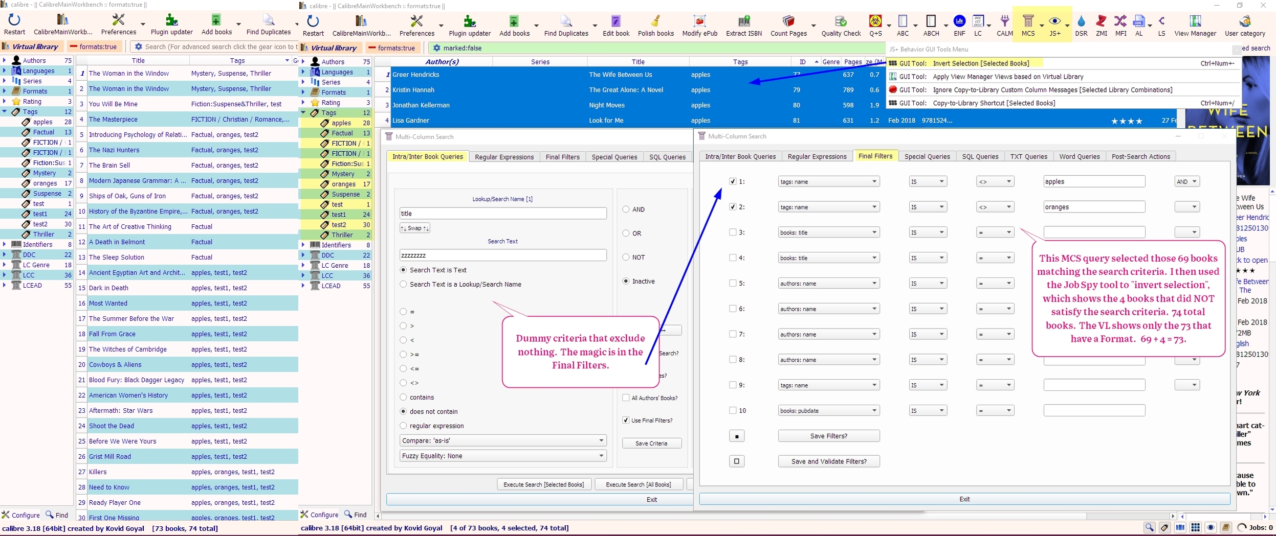

Originally Posted by Adoby View Post
DaltonST: Your description does not seem to match how it works when I try to reproduce the problem. Or perhaps I have gremlings in my computer as well...
See the attached image that proves that my logic is sound.
DaltonST

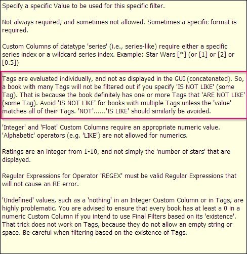

I take into consideration that Tags have an attribute of is-multiple equal to True. That means that there is a separate table entry in books_tags_link for each Tag for each Book. 5 Tags, 5 entries in that table. Each Tag is evaluated separately. 5 evaluations. For a Tag of "apples, oranges, peaches, pears, grapes" then the OP's search results for a book with that Tag would be "False, False, True, True, True". The Trues would cause the book to be selected, even though the first 2 Tags were not desired and returned a False viz a viz returning that book as "selected".
Added: see the image of the MCS ToolTip for Final Filters. I should have attached this image previously, since a picture is worth 1,000 words.
DaltonST
Last edited by DaltonST; 02-28-2018 at 11:34 AM. Reason: Added another image, ToolTips for Final Filters
