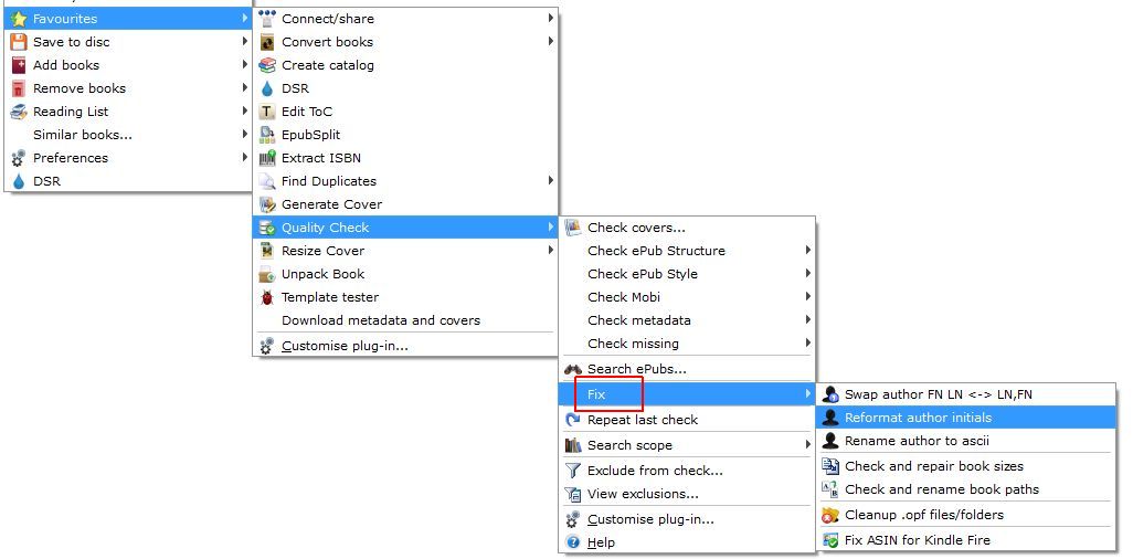

Thanks! I do use that plugin...very helpful. I had not tried it on this problem, tho, so learned something new!
It will indeed find all the XY initial entries so I can then put them into a virtual library to work on, but it won't actually make the change, so it is still a manual process at that point. Am I missing something the Quality Check plugin can do that will fix the Initials problem?
If I can get the Metadata Editor regex to work, it will easily scan the entire library for those XY occurrences and take care of them in fewer steps.

Originally Posted by MontyJ View Post
[. . .] so it is still a manual process at that point. Am I missing something the Quality Check plugin can do that will fix the Initials problem?
try this one ==>> Click image for larger version

try this one ==>> Attachment 157441
Well, I certainly missed that one! And it works. Fantastic plugin!!
And Thanks!!
