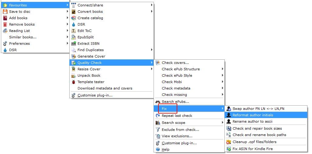

Old 06-21-2017, 12:21 AM   #4
Posts: 22,684
Karma: 33011292
Originally Posted by MontyJ View Post
[. . .] so it is still a manual process at that point. Am I missing something the Quality Check plugin can do that will fix the Initials problem?
try this one ==>> Click image for larger version

Old 06-21-2017, 01:26 AM   #5
MontyJ
MontyJ began at the beginning.
Posts: 224
Join Date: Jul 2012
try this one ==>> Attachment 157441
Well, I certainly missed that one! And it works. Fantastic plugin!!
