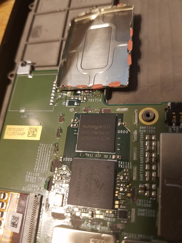

Well, I just finished trying to remove one of the RF shields, and it went poorly - I got too impatient.
Debating wether it is worth owning a hot air gun or not, it probably is - or I can just buy a new kindle for the same price :-)
One from Best Buy or similar would probably have the older firmware on it.
I wont try removing the rest of the shields without one though, but I do want to try to backup my device properly.
