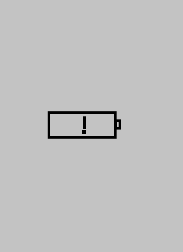

Water damage: fully functional, but battery really bad - replace?
TL;DR - Dropped in pool, cleaned and dried, battery lasts about 3 days while not used and in airplane mode.
Is the battery actually being drained by something busted on the logic board, or just the battery busted.
So, I dropped my kindle in the pool on vacation, and pulled it out really fast.
It crashed and restarted and crashed again , and eventually it stopped responding - classic water problems.
I pull the front face of it off and let it sit in the sun for about 4 hours, so I'm convinced it was dry before I tried to plug it in again.
Plugged it in and charged it up till it came on - and everything appeared to work.
Unplugged it, and in a matter of hours the battery was fully drained, and was on a Battery Icon With Exclamation Point - not the normal "your battery is dead".
I can not find any images of this online, so I have attached a recreation.

	Line 6233:  170412:235914 powerd[1702]: I def:battinfo-misc:batt_type = PRIMARY caprep=28%, capmix=34%, mAhav=470mAh, mAhmix=483mAh, reason_for_log=Battery log due to high delta voltage:
	Line 6244:  170412:235944 powerd[1702]: I def:battinfo-misc:batt_type = PRIMARY caprep=28%, capmix=34%, mAhav=470mAh, mAhmix=483mAh, reason_for_log=Battery log due to high delta voltage:
	Line 6633:  170413:000944 powerd[1702]: I def:battinfo-misc:batt_type = PRIMARY caprep=28%, capmix=33%, mAhav=461mAh, mAhmix=475mAh, reason_for_log=Battery log due to regular timer:
	Line 6895:  170413:001945 powerd[1702]: I def:battinfo-misc:batt_type = PRIMARY caprep=27%, capmix=33%, mAhav=455mAh, mAhmix=468mAh, reason_for_log=Battery log due to regular timer:
170411:144822 powerd[1702]: I def:suspenddelta:Battery Type = PRIMARY, sec=8342, cap=-6, mAh=-92, volt=-33, bp=0:Suspend delta
170411:163926 powerd[1702]: I def:suspenddelta:Battery Type = PRIMARY, sec=6594, cap=-4, mAh=-72, volt=-29, bp=0:Suspend delta
170411:173728 powerd[1702]: I def:suspenddelta:Battery Type = PRIMARY, sec=3414, cap=-3, mAh=-38, volt=-37, bp=0:Suspend delta
170411:201504 powerd[1702]: I def:suspenddelta:Battery Type = PRIMARY, sec=9387, cap=-6, mAh=-105, volt=-55, bp=0:Suspend delta
170411:221906 powerd[1702]: I def:suspenddelta:Battery Type = PRIMARY, sec=7374, cap=-4, mAh=-56, volt=-23, bp=0:Suspend delta
170411:231802 powerd[1702]: I def:suspenddelta:Battery Type = PRIMARY, sec=3457, cap=-1, mAh=-23, volt=-11, bp=0:Suspend delta
170412:073507 powerd[1702]: I def:suspenddelta:Battery Type = PRIMARY, sec=29159, cap=-12, mAh=-189, volt=-88, bp=0:Suspend del
170412:074845 powerd[1702]: I def:suspenddelta:Battery Type = PRIMARY, sec=742, cap=-1, mAh=-5, volt=-5, bp=0:Suspend delta
170412:201205 powerd[1702]: I def:suspenddelta:Battery Type = PRIMARY, sec=44530, cap=-17, mAh=-286, volt=-79, bp=0:Suspend del
170412:231108 powerd[1702]: I def:suspenddelta:Battery Type = PRIMARY, sec=10676, cap=-4, mAh=-67, volt=-11, bp=0:Suspend delta
And just another report with the lines labelled "suspend delta"
coplate is offline   Reply With Quote
Old 04-13-2017, 11:31 PM   #9
knc1
Going Viral
knc1's Avatar
Posts: 17,212
Karma: 18210809
Location: Central Texas
Device: No K1, PW2, KV, KOA
That battery is worn out.
Which is why charging raises the temperature rather than storing the energy.
Luckly, the battery management chip is smart enough to keep it from bursting into flames.
Buy new battery.
Probably not associated with its bath.
The batteries are normally sealed "gas tight" which also keeps out liquids.
Old 04-13-2017, 11:42 PM   #10
coplate
coplate ought to be getting tired of karma fortunes by now.coplate ought to be getting tired of karma fortunes by now.coplate ought to be getting tired of karma fortunes by now.coplate ought to be getting tired of karma fortunes by now.coplate ought to be getting tired of karma fortunes by now.coplate ought to be getting tired of karma fortunes by now.coplate ought to be getting tired of karma fortunes by now.coplate ought to be getting tired of karma fortunes by now.coplate ought to be getting tired of karma fortunes by now.coplate ought to be getting tired of karma fortunes by now.coplate ought to be getting tired of karma fortunes by now.
Posts: 645
Karma: 1888888
Device: prs-505, Kindle Keyboard 3g, PW3
Buy new battery.
It definitely did not act like this before it's bath, and its only 9 months old.
Those temperature errors on the 11th were while it was unplugged and discharging, not while it was charging up.
I guess I would try to decide if the bath shorted the battery too long out, and that's what killed it.
Otherwise, if it's really not associated with the pool, I might be able to try to swing a warranty replacement.
Do you know how many moisture indicators are inside the PW3 :-)
But yeah, The battery is shot, I'm trying to decide if I feel comfortable trying to use the Kindle trade-in, or if water damage is a killer on that, it only asks if it works and holds a charge, not if it holds a long charge.
Or if I want to try to buy a replacement battery that's already the right size, or try surgery like geekmaster in this post: https://www.mobileread.com/forums/sh...d.php?t=274761

If it is not being charged at the time of those messages, it is most certainly bad.
I can only go by the things you post, I can not see over your shoulder or (like Amazon) channel into your mind.
Nowhere do you mention what model Kindle you are writing about and your info block mentions a K3 and a PW3.
So how was I suppose to know if the Kindle you are writing about is still in warranty?
Did you see this line in your cut and paste?
170413:075145 [38359.733251] KERNEL: I pmic:fg suspend battinfo:current=-51mA, volt=3766mV, capav=027%, mAh=451mAh:
And this one:
170413:075145 [38359.983968] KERNEL: I pmic:charger chgina::charger connected
Which occurred about 2/10's of a second apart.
Either you are extremely fast plugging it in, or it was on the charger when it resumed.
I stand by my answer to your thread topic, your battery is really bad.
How you go about changing that situation is your own business.
Old 04-14-2017, 09:05 AM   #12
Dr. Drib
Dr. Drib's Avatar
Posts: 46,354
Karma: 61420445
Location: Peru
Keep in mind I'm not an expert, but here's my opinion. You may take it or leave - as you see fit:
There may be a possibility of that battery expanding due to having gotten wet. IF that happens, you're going to have a gooey electronic mess. It could even be a fire hazard.
I think you should immediately remove that battery and search for a new one.
Old 04-14-2017, 09:55 AM   #13
jswinden
Nameless Being
I agree with Dr Drib.
The first logical thing to do after an electronic device gets wet is to remove the energy source immediately. An item that is plugged into an AC wall socket should be unplugged. A device that is running on batteries should have the batteries removed. However, with devices like Kindles it is not easy to remove the batteries. The fact that the Kindle kept rebooting immediately after its bath is not good. The faster you can disconnect a device from power, the better, but Amazon made it difficult with the Kindles.
Lithium batteries are notoriously dangerous when they go bad, so like Dr Drib said, get that sucker out of the Kindle and dispose of it in a safe non-combustible manner. Will the Kindle be okay with a new battery? Who knows. The Kindle likely overheated and likely had multiple short circuits in the initial few minutes. I doubt it will ever be totally normal again, but it might be usable.
  Reply With Quote
Old 04-14-2017, 12:07 PM   #14
knc1
Going Viral
knc1's Avatar
Posts: 17,212
Karma: 18210809
I agree.
Peel off the bezel of your PW3, unscrew the Kindle's frame from the case back, turn over, unscrew the battery hold-down screws.
The PW3 is an easy tear-down, use stiff pieces of plastic, such as a cut up credit card, to work under the bezel when pulling it off.
That plus a tiny screw driver, and your all set.
Note:
Watch out for screws hidden under black tape, IIRC the PW3 has several of them.
Old 04-14-2017, 12:50 PM   #15
coplate
Posts: 645
Karma: 1888888
Thanks knc and everyone, I know I've gone back and edited my posts with everything people have asked for ( kindle type etc. ), so hopefully this thread remains useful for people searching in the future.
In the first post I mentioned I "took it completely out of the frame and removed the battery, but did not separate the screen from the logic board", So I have all the tools to pull the bezel off, just not the smaller screwdriver to get the screen seperated form the board.
There was just 1 screw under the black tape on mine, but it took me WAY too long to realize why i couldn't pull it out. I was like "Are there clips I can't see, is it just in there really tight, whats going on. then I finally realized, oh, there's probably another screw. It was a good 4 minutes.
Other than that post I linked from geekmaster ( I see knc1 was in there ), has anyone had any experience buying new aftermarket batteries? It doesn't look like amazon has official ones.
I can see many on ebay in the proper form factor with official looking labels, but I've never bought a replacement battery for anything that wasn't from Best buy or Ebay.
They are all about $15 on ebay, and $30 on <wildcard>Battery<wildcard>.com
