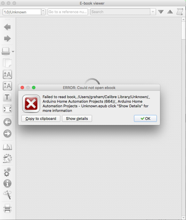

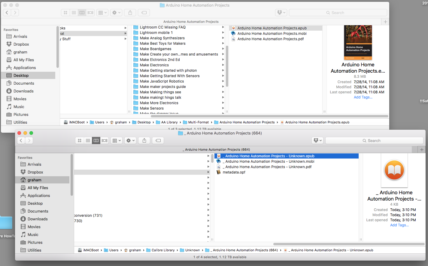

Yes, completely new. Updated today to the 2.60.0 release. I don't believe I added any plugins. I'm trying to import a file structure that has multiple versions (pub, mobi, and pdf) so i created the structure you can see in the screen shot below (top). This WAS on a separate portable drive plugged in via USB. I copied the whole library structure to the desktop, to try and remove that as a possible problem.
I get the same problem. When I import using 'Add Books, (One book per directory) I get the result you see in the screenshot, lower window.
I get the error seen in the other screenshot: I can open the books in the source folders with no problems.

The book name (title) begins with a _
Maybe that is not expected

The copy in the calibre library has shrunk from 8.3 MB to 4 KB.
That is very not normal. calibre is not doing it, though, so you will have to find out what is.
It *could* be a failing hard drive on your Mac.
Or possibly some other program is interfering with calibre. Perhaps, messing around with the temporary folder when calibre is staging the book to be added?
