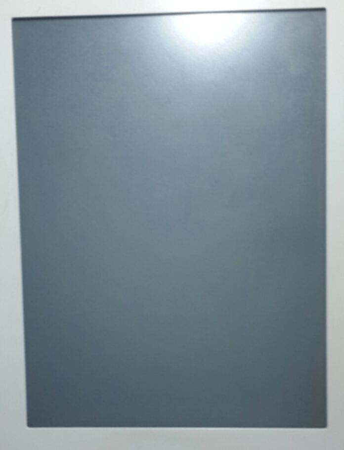

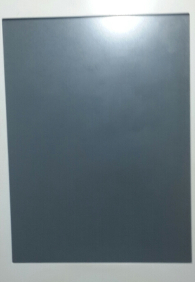

ID:	140122   Click image for larger version
Don_Karnage is offline   Reply With Quote
