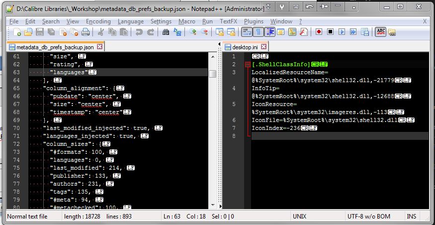

On occasions I've had to edit the metadata_db_prefs_backup.json file to get rid of the 'malformed' data
That step is probably beyond my skill level. I tried a quick internet search and didn't find much. With windows explorer I can see the file in the Calibre directory (very small 46kb compared to the much larger multi-MB metadata.db file) and I can open and read the unformatted data stream with a basic text editor, but wouldn't know how to determine what was malformed data. It also seems risky to do any direct editing of the file and it seems more like an output data stream rather than a structured input data stream.
But I digress from the main topic in this thread and, inexplicably, the problem appears to have gone away. Hopefully it will not return. : / ...THANK YOU.

Hmmmm - that's three problems that have 'disappeared' for no apparent reason in recent days.
Rob557 - JSON files are 'unix' files (lines endings are LF only), sounds like you used an editor that wants 'dos' files (lines endings are CRLF), e.g. Notepad.
I use Notepad++, this is what I see - unix file on the left, dos file on the right.

JSON files are 'unix' files ... I use Notepad++ (displaying) unix file on the left, dos file on the right.BR
I've just downloaded Notepad++ and can now see the structure, primarily the parameters for the columns in Calibre as well as recent search criteria etc. Thanks for the tip on Notepad++ BetterRed.
