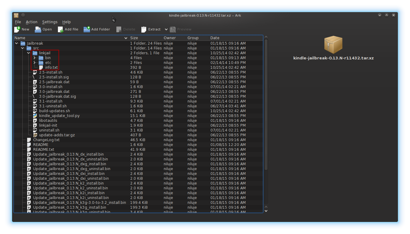

Manually restore the linkjail folder from the JailBreak source package (i.e., the one from the snapshots). Then restart your device, and try again.

No, just put the linkjail folder from the src packages back to the root of the Kindle, and restart. Forget about the JB install .bin file.

That's the usual "JB-not-installed" error code. Gonna need to look at some logs to try to guess what's going wrong, since restoring the linkjail folder should have done the job.
Enter ;dm in the Homescreen's search bar, and PM me the log files it'll dump in the documents folder.
Don't be confused, that's the expected behavior after a factory reset on a K3, the JB is slightly more convoluted than usual on that model. Factory resets on Kindles are very 'soft', and actually touch very few things (for good reason: they really don't need to do much more than what they currently do on vanilla devices), which doesn't prevent them from breaking a lot of custom stuff in fun & interesting ways .
EDIT: Actually, no, that's not the expected behavior after a factory reset, that would be stupid. That's the expected behavior if you were using yifan's JB, but not mine. Got confused, my bad. Doesn't change the fact that looking at logs will shed more light on everything though .
Which means I'm also gonna need more details on what exactly you meant by "messing stuff up"...
Since you had USBNetwork installed, you can also try the same trick, restore the usbnet folder from the source package.
