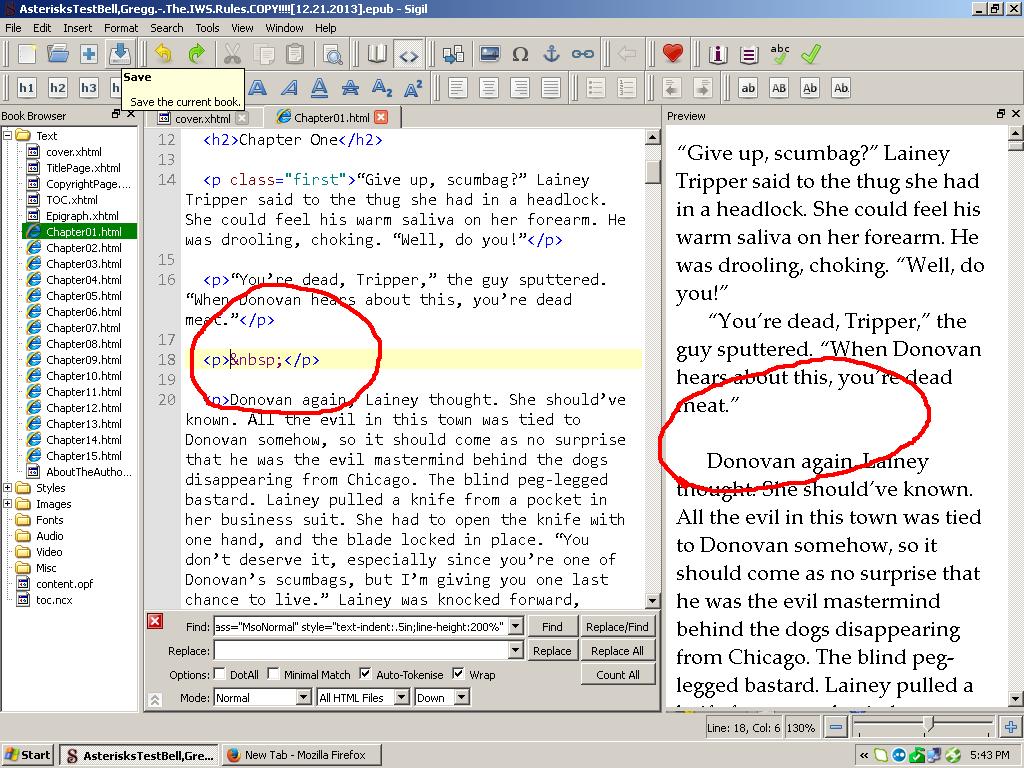

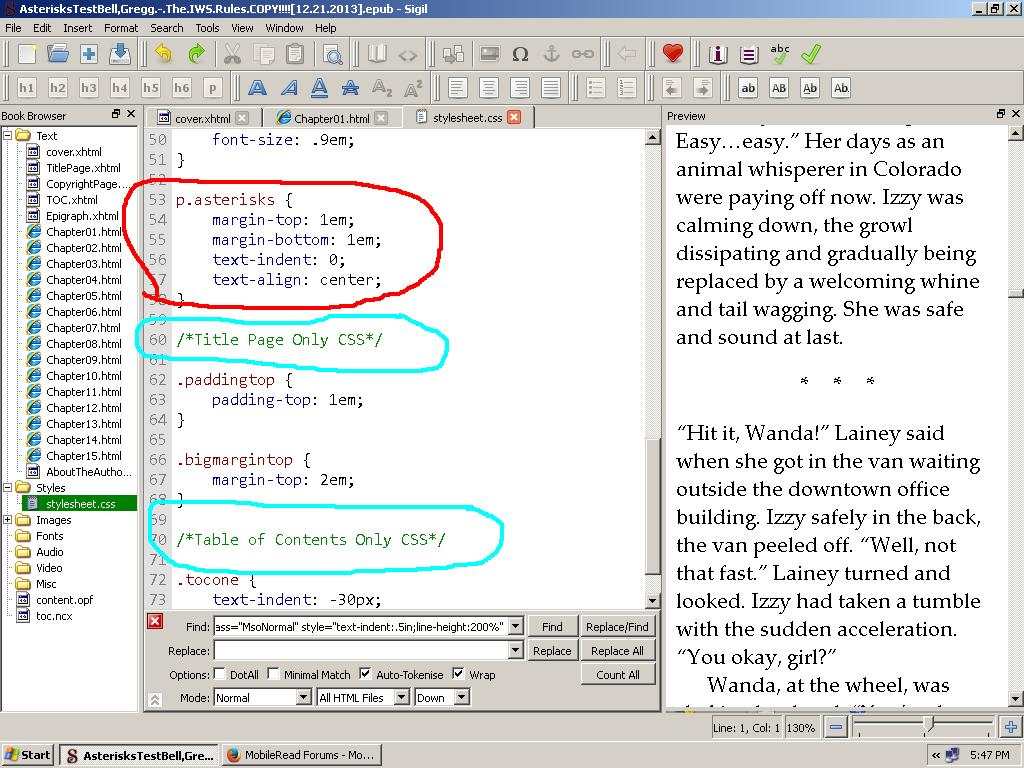

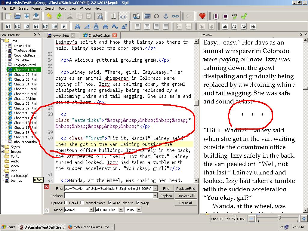

  issue in 0.7.2
eschwartz in another thread said:
One issue you probably DO care about is 0.7.2 converted   into a regular space, thus breaking the blank paragraphs sometimes used as scene breaks. That was fixed in 0.7.3
I went (I'm using 0.7.2) and experimented with this, and it seemed to me that the non-breaking spaces were functioning like they always did. I've enclosed three screenshots, showing:
1) a simple   functioning as a break between paragraphs
2) the  s used in my asterisks
3) the css style sheet for the asterisks
It all seems normal to me or am I missing something?
As a side question: On that style sheet screen shot, those two things I've circled in blue (someone else did this style sheet for me). Why are those comments even in there? I mean, doesn't the style sheet (as long as it's linked) apply uniformly?
Thanks.
ID:	118027   Click image for larger version
ID:	118028   Click image for larger version

Well, I base this all on what I've heard, but I believe the problem happens with multiple saving instances.
As far as the comments on the css, I would guess your source grouped the styles according to where they are used -- i.e. the "Title Page only CSS" will apply anywhere that class is used, but it is only being used (theoretically) in the title page. And same goes for the ToC only css.
In other words, it is a suggestion that those styles should be used exclusively for formatting the title page. Some non-DRM'ed books I've gotten do similar things in the stylesheet. Personally, I would think there is greater clarity (and safety) in making three stylesheets, then linking each one where they belong, but who says life has to make sense?
Perhaps someone else will pop up here to elucidate the matter further. I just play with the books I've bought -- other people here (like you) do this for a living and have far more experience with Sigil.

0.7.2 had/has no issues with the nbsp entity. It was the UTF-8 non-breaking space character that was being converted to a normal space.

Here is the problem, which I had to navigate myself while making Edit Book for calibre:
1) Qt internally converts the unicode nbsp character u+00a0 into normal spaces, when extracting text from QPlainTextEdit. This can be worked around by overriding appropriate methods in the QPlainTextEdit sub-class
2) Instead of doing the overwriting Sigil chose to convert unicode nbsp into   to workaround the bug
3) Named entities like   are invalid in XHTML without a proper doctype
4) Therefore Sigil before 0.7.3 could take a valid epub and by converting the nbsp characters into named entities render it invalid (if it did not declare a doctype, which is optional and many epubs do not). Of course this "invalidity" was only with respect to the useless epubcheck. The epubs continued to work fine in all actual epub readers.
5) This was fixed by converting the nbsp characters into *numeric* instead of named entities in Sigil 0.7.3
The best approach is of course to fix Qt as I did for Edit Book, but I dont know if any Sigil developers have any interest in doing that.

Kovid's explanation of what happened is correct. It documents what happened from 0.7.2 to 0.7.4.
If, however (for the O.P.), your source does not make use of any non-breaking space characters (which it seems like it doesn't), 0.7.2 isn't going to cause you any issues in that regard. Your nbsp entities are safe.
0.7.3 was an attempt to fix the issue, but unfortunately introduced the problem where xhtml without a doctype (valid xhtml, mind you) was being invalidated by converting the non-breaking space characters to entities (with no regard for whether that conversion needed a DTD present to be valid).
0.7.4 was released to alleviate the doctype conundrum that 0.7.3 unwittingly introduced.
