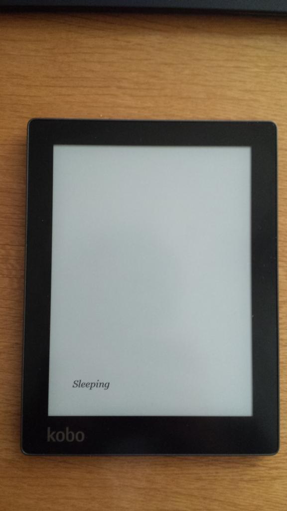

found it, it's affiliate=mondadori (the store name).
changed it to kobo, and now the screen is blank, with a little "sleeping" tag on the lowerleft of the screen (is this the default screensaver for kobo purchased readers?)
-with affiliate=kobo (screesaver)

anyway, i did change the line in affiliate to kobo, and the screensaver was a blank page with "sleeping" written in italics in lower left corner. is that the default screensaver for the readers that have affiliate=kobo from the start, or was it a placeholder in case the screensaver went missing/corrupt?
powered off it was similar, a black page with "powered off" at the bottom.
i changed the line back (by the way, the changes take place instantly, there is no need to restart it after changing just this time, but i did it anyway, to see full process). when i restarted the device, the same savescreen appeared, but with a "kobo in" written before it, in place of a small graphic symbol of the store. also, when shut down, the normal store screensaver appeared,but inverted colors.

this is the store screensaver (out of box)
[Click to enlarge.]
the screensaver after changing to affiliate=kobo
[Click to enlarge.]

cosmo666: That is the screensaver with no options selected. Go into the settings and open the "Sleep, Power and Light" page. This should now have options to use the cover as the screensaver and how big it is. For some of the affiliates, these options are not available.
