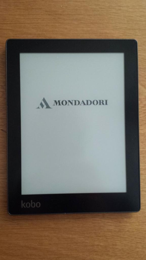

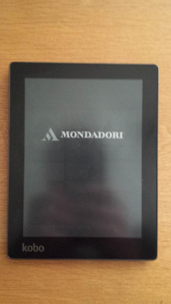

Old 10-31-2013, 08:14 AM   #11
cosmo666
cosmo666 began at the beginning.
Posts: 13
Join Date: Oct 2013
Device: prs-650, kobo aura
found it, it's affiliate=mondadori (the store name).
changed it to kobo, and now the screen is blank, with a little "sleeping" tag on the lowerleft of the screen (is this the default screensaver for kobo purchased readers?)
-with affiliate=kobo (screesaver)
(Click to enlarge.)
-with affiliate=mondadori (screensaver)
(Click to enlarge.)
(when shut down, it's identical to the screensaver, but inverted colors)
also, during bootup, there's another image with a "kobo in" in place of the symbol, comming out to be "kobo in mondadori".
so there should be at least 2 if not 3 different images hidden somewhere. (i would have agreed to the fact that it could just be a normal font written on a blank screen, but that symbol implies graphics)
any further ideeas of where/how to dig?

Old 11-01-2013, 03:03 AM   #12
cosmo666
Posts: 13
Join Date: Oct 2013
added a response yesterday, documenting it with pictures, but it went into "pending aproval status", and it hasn't appeared since.
anyway, i did change the line in affiliate to kobo, and the screensaver was a blank page with "sleeping" written in italics in lower left corner. is that the default screensaver for the readers that have affiliate=kobo from the start, or was it a placeholder in case the screensaver went missing/corrupt?
powered off it was similar, a black page with "powered off" at the bottom.
i changed the line back (by the way, the changes take place instantly, there is no need to restart it after changing just this time, but i did it anyway, to see full process). when i restarted the device, the same savescreen appeared, but with a "kobo in" written before it, in place of a small graphic symbol of the store. also, when shut down, the normal store screensaver appeared,but inverted colors.
i will try to link the pictures after this post to make it clear.
i believe the store-based secreensaver is not a text just thrown over a blank page, but an actual picture due to the graphic in it.
the next order of business would be to find where the image is stored on the device and change it with our image keeping the same format and name, and the device should be able to point to it natively. any ideeas on how to search for it? is there a hidden file that can be decompressed, or something?
L.E. tried to a make a 2nd post with the pics, but it went to aproval instead, so it will take a while untill it's verified. ah well...
cosmo666 is offline   Reply With Quote
Old 11-01-2013, 03:11 AM   #13
cosmo666
Posts: 13
Join Date: Oct 2013
this is the store screensaver (out of box)
[Click to enlarge.]
the screensaver after changing to affiliate=kobo
[Click to enlarge.]
powered off store screen
[Click to enlarge.]
powering on, the small triangle was changed to a "kobo in". but that made everything all letters, so it may not have been an actual picture. (didnt' manage to take a pic of it, but will if it's required)
so, there should be at least 2 pictures hidden somewhere (the screensaver and the powered off screen)

Old 11-01-2013, 05:46 AM   #15
davidfor
Posts: 24,905
Karma: 47303828
Location: Sydney, Australia
cosmo666: That is the screensaver with no options selected. Go into the settings and open the "Sleep, Power and Light" page. This should now have options to use the cover as the screensaver and how big it is. For some of the affiliates, these options are not available.
