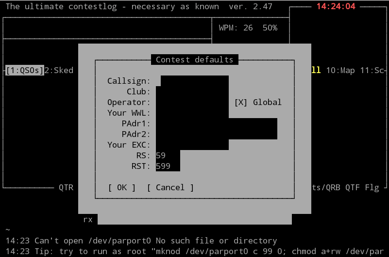

From the looks of that screenshot in the upper right (and some of your configure args) I think you will also need a terminal emulator (so the k3 keyboard will work).

I have successfull build but program not working... I'm getting "Forcing core dump" when i'm trying run tucnak from kindle.. Where can i find dump ?? Does anyone have strace for kindle3 ??

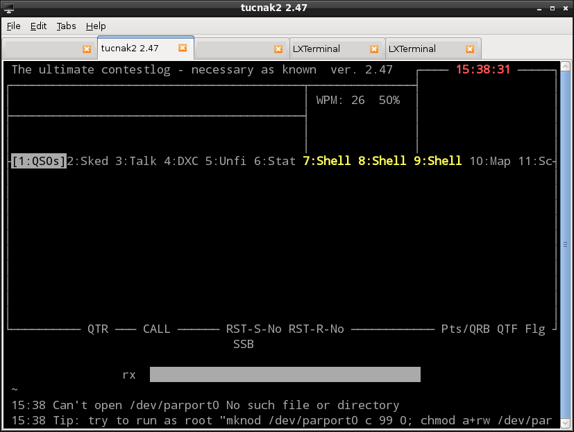

I have added one for the TOUCH here...
as this is possible with the work done so far.
This works no problem on the touch.

------ Settings: --------
version: tucnak2-2.47
prefix: /usr
sharedir: /usr/share/tucnak2
interface: ifconf
compiler: gcc 4.6
sizes: int=4, long=4, long long=8, void*=4
endianity: little
CFLAGS: -g -O2 -pthread -I/usr/include/glib-2.0 -I/usr/lib/arm-linux-gnueabi/glib-2.0/include -I/usr/include/SDL -D_GNU_SOURCE=1 -D_REENTRANT -I/usr/include/libpng12
LDFLAGS: -z now
LIBS: -lm -lutil -lusb -pthread -lgthread-2.0 -lrt -lglib-2.0 -L/usr/lib/arm-linux-gnueabi -lSDL -lpng12 -lsndfile -lasound -lftdi
libc: yes glibc 2.13 (2.13)
libglib2: yes 2.32.0
libsdl: yes 1.2.15
libpng: yes 1.2.47
iconv: libc
libgpm: disabled
libsndfile: yes 1.0.25
alsa: yes 1.0.25
libftdi: yes 0.20 new
libhamlib: no
libfftw3: no
ppdev: yes
pedantic: no
leak debug: no
instrument: no
opts: -O2
ID:	98821   Click image for larger version
Name:	tucnak2 2.47_075.png

Tucnak working..
There is first working build on my K3. To install make directory tucnak in your kindle put content of attached zip inside. Run myts and go to tucnak directory and ./run
In Tucnak switch to bw mode - F10 menu and then Setup -> Terminal options.
There is problem with colors, bw mode is not 100% ok and need some work to make it 100% compatible with kindle display..
But tucnak working on kindle...
