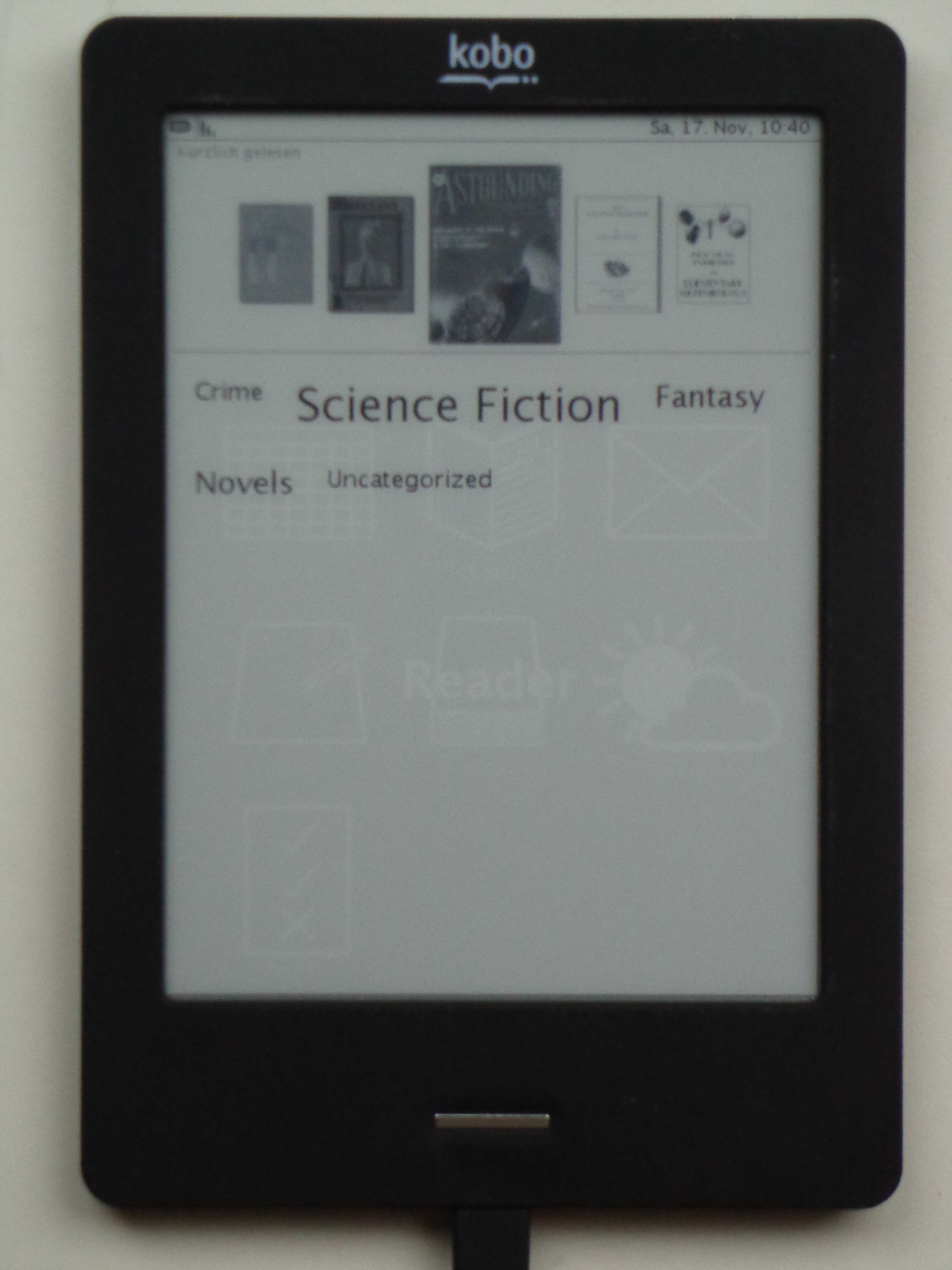

Hi all,
As promised a few days ago in this thread https://www.mobileread.com/forums/sho...d.php?t=195514, I provide some pictures of my nickel replacing Java application on my Kobo Touch. The idea for this application is based on the work by Michael Zucchi (http://a-hackers-craic.blogspot.be/search/label/kobo)

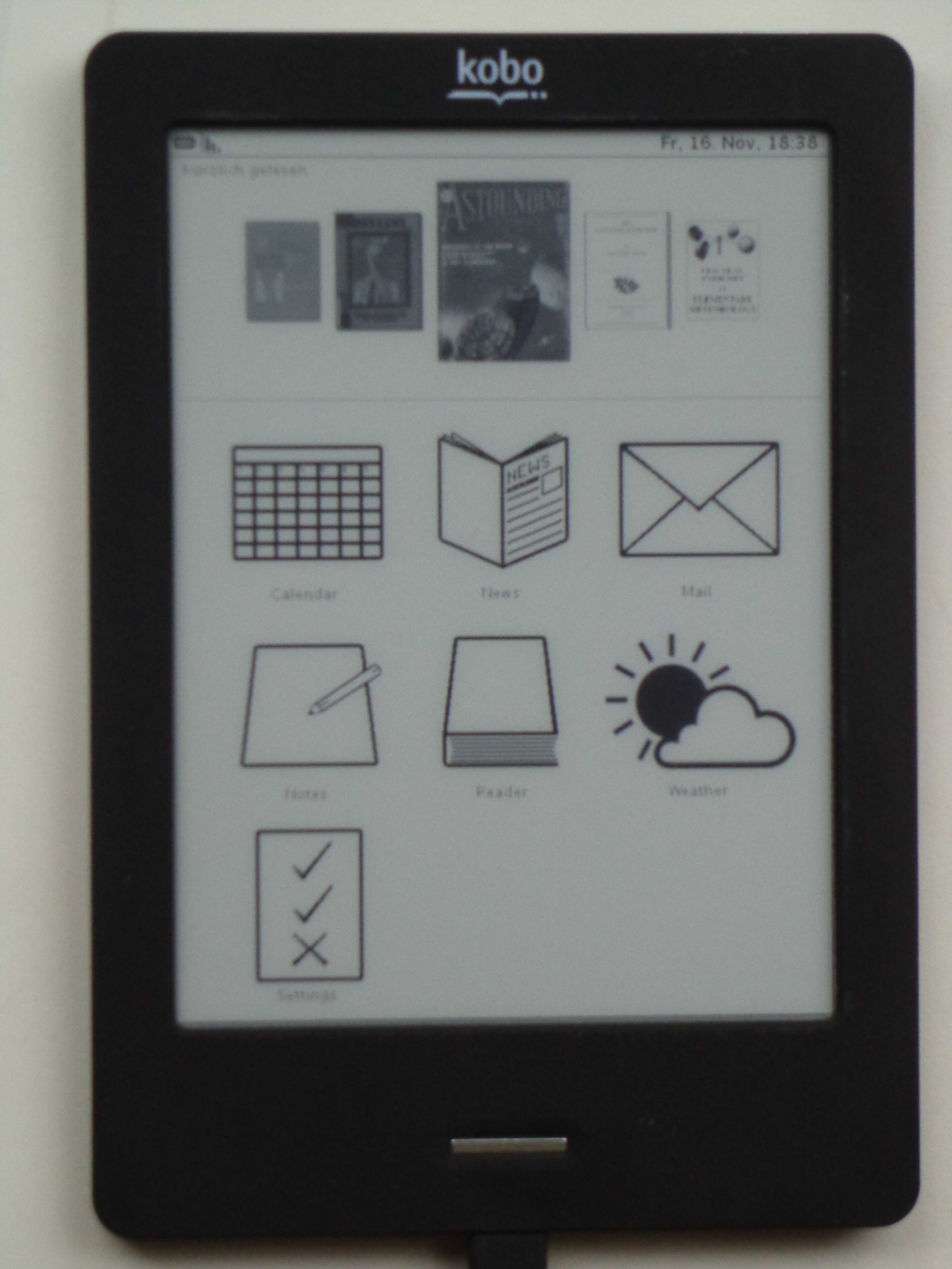

The first one is the Home Screen.
The upper part of the screen shows a list of recently read books. The lower part contains icons for several "Applets", e.g. Calendar, News, Mail or Reader.

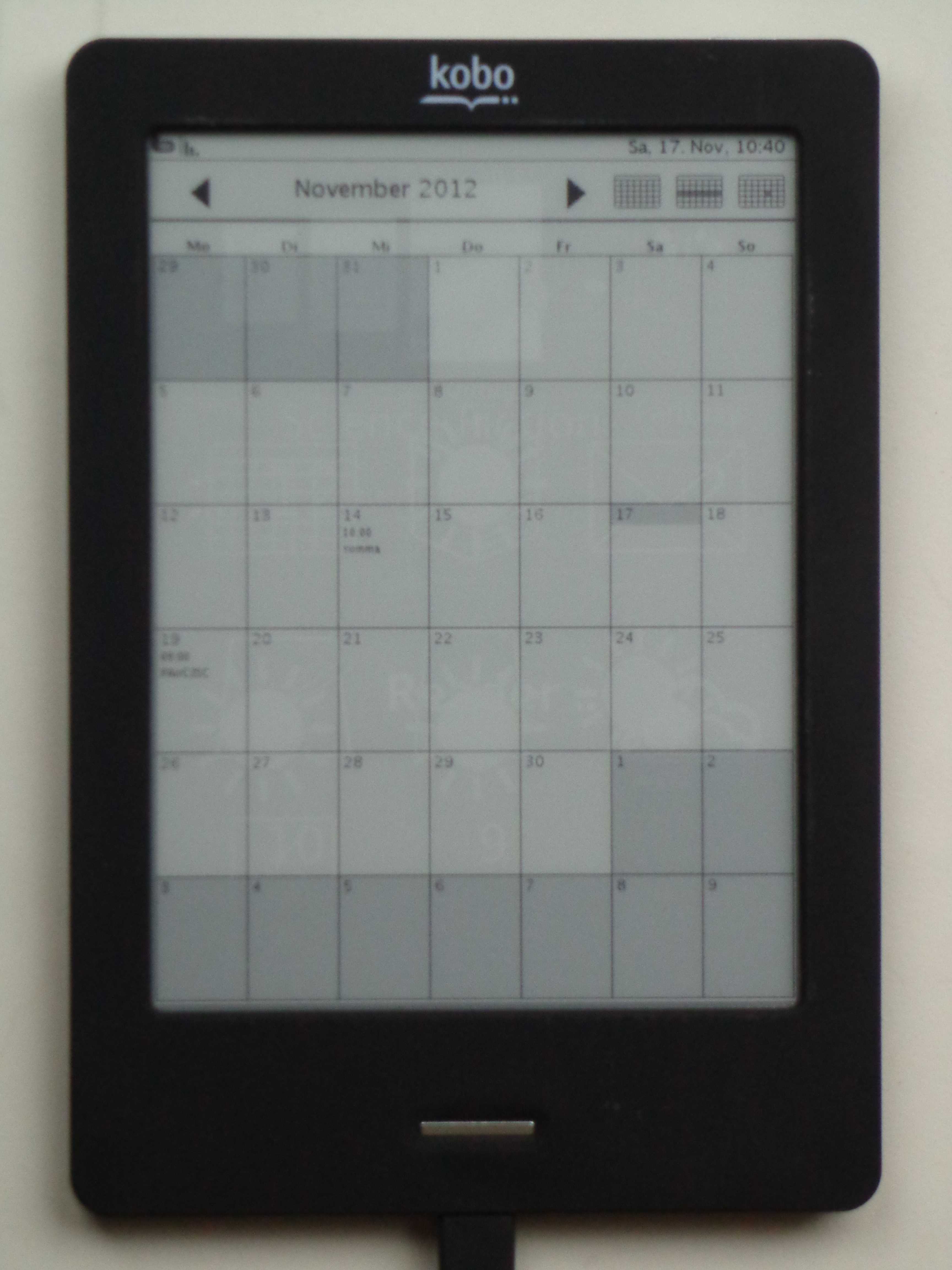

The Calendar can be displayed in a month, week or day view. One can switch through the different views by tapping on the icons at the right part of the menu bar. With a swipe to the left or to the right one can go a month, a week or a day back or forward.
ID:	96349Click image for larger version

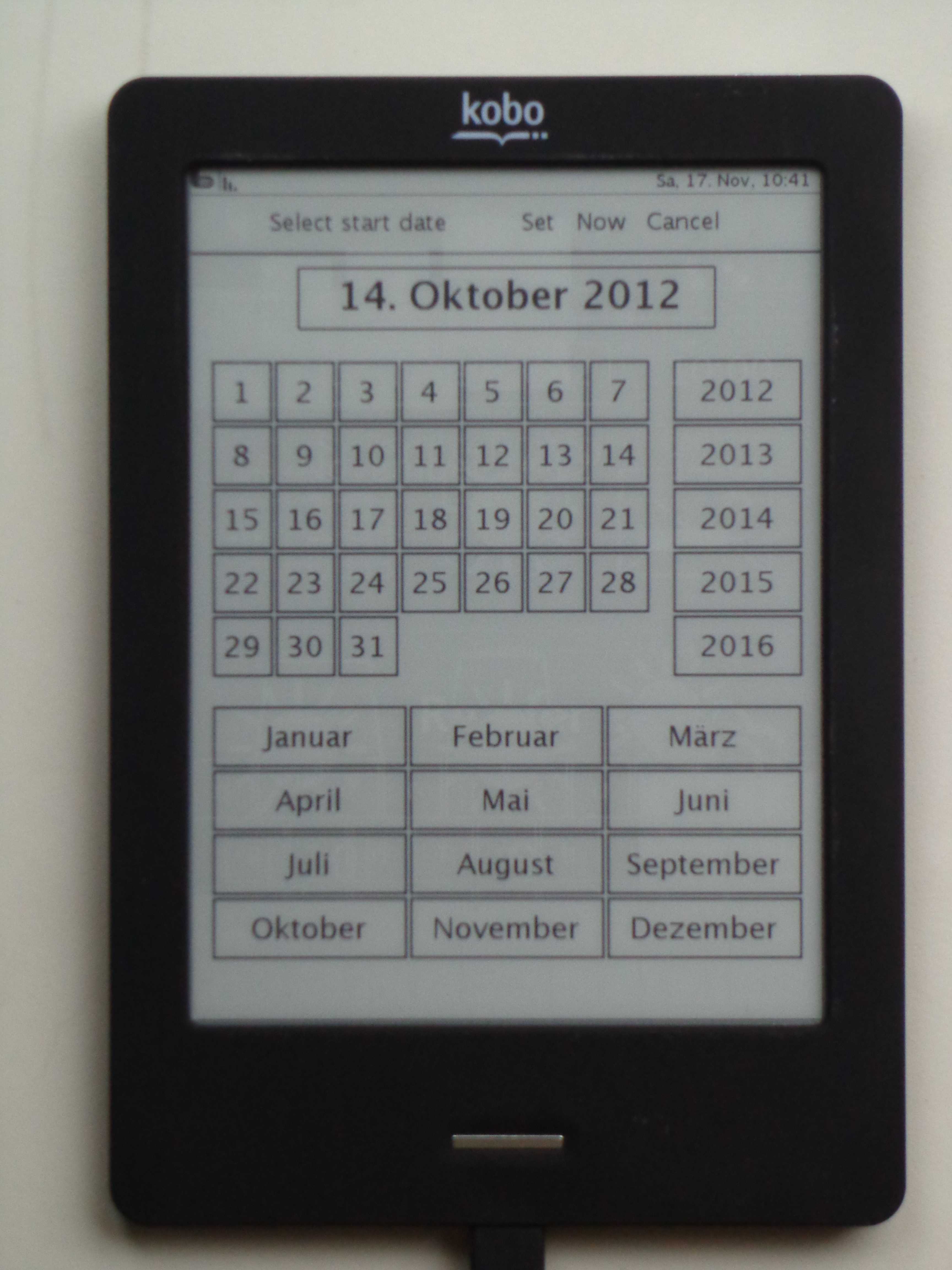

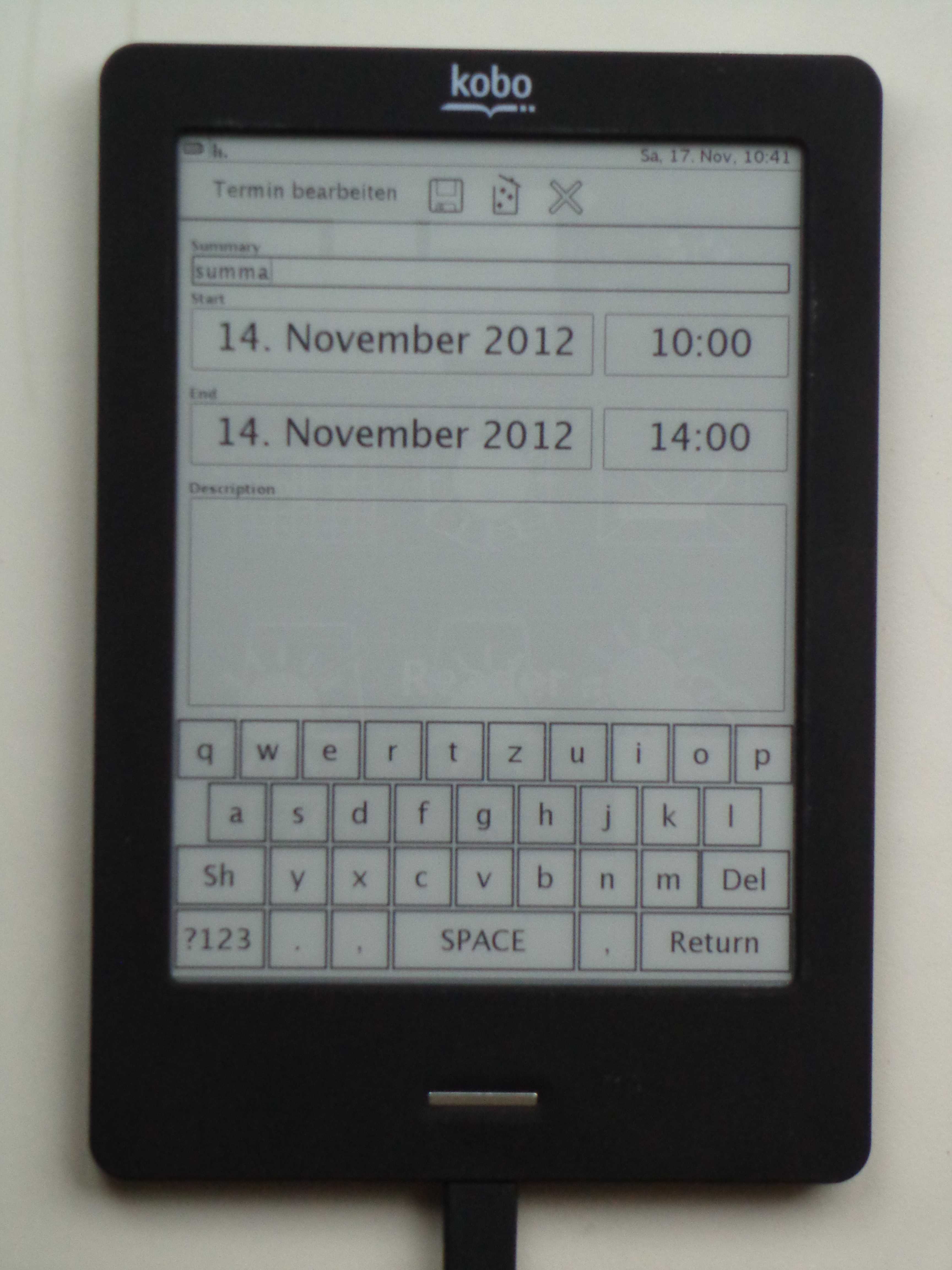

By a long tap one can create a new event, by a normal tap on an existing event one can modify the details of the event.
ID:	96351Click image for larger version

The events are stored in a file in XCAL (XML iCal)format. I hope to implement in future a synch mechanism for my thunderbird calendar at home.
The Reading Applet shows the existing book categories as a tag cloud considering the number of books in a particular category. Currently the category structure is file system based, that means each category is a directory in file system. That makes it easy to manipulate categories and add or remove books.
After a tap on a category, a list of the books in that category is diplayed to select the book to read (I haven´t finished this work yet).

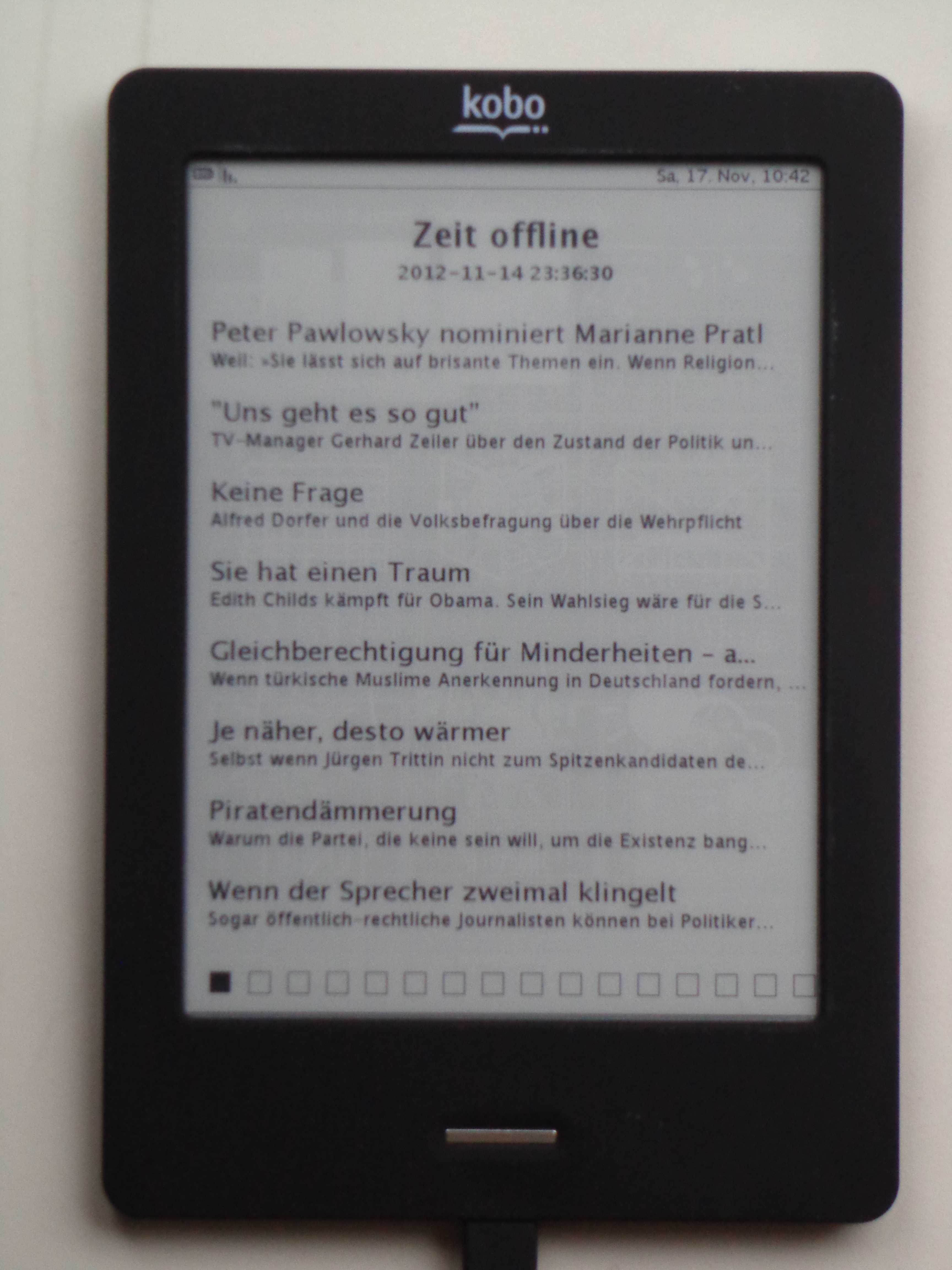

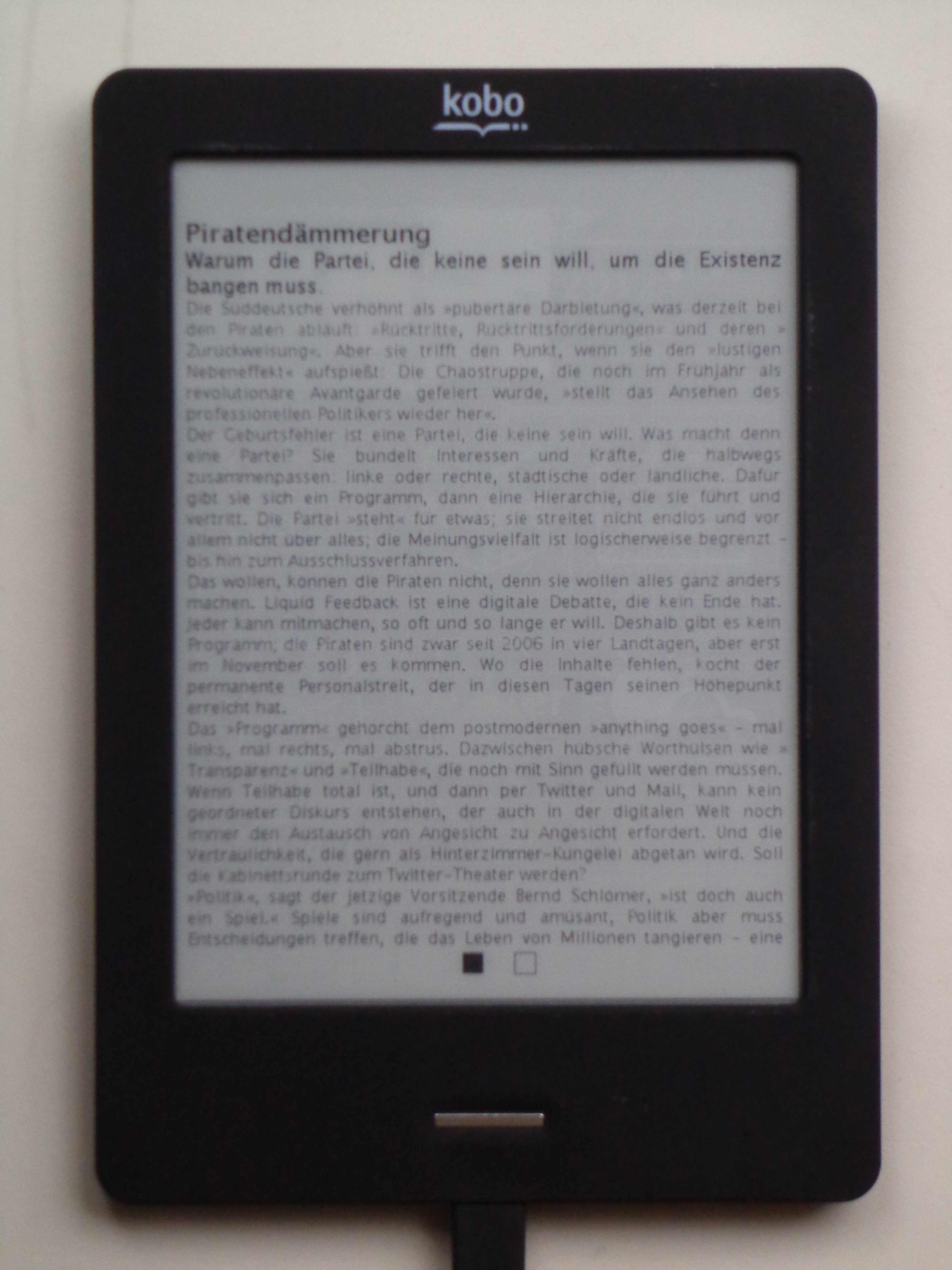

The News Applet displays my favorite online news. A separate application crawls the news webpages and compiles an ePub (without advertisements and pictures).

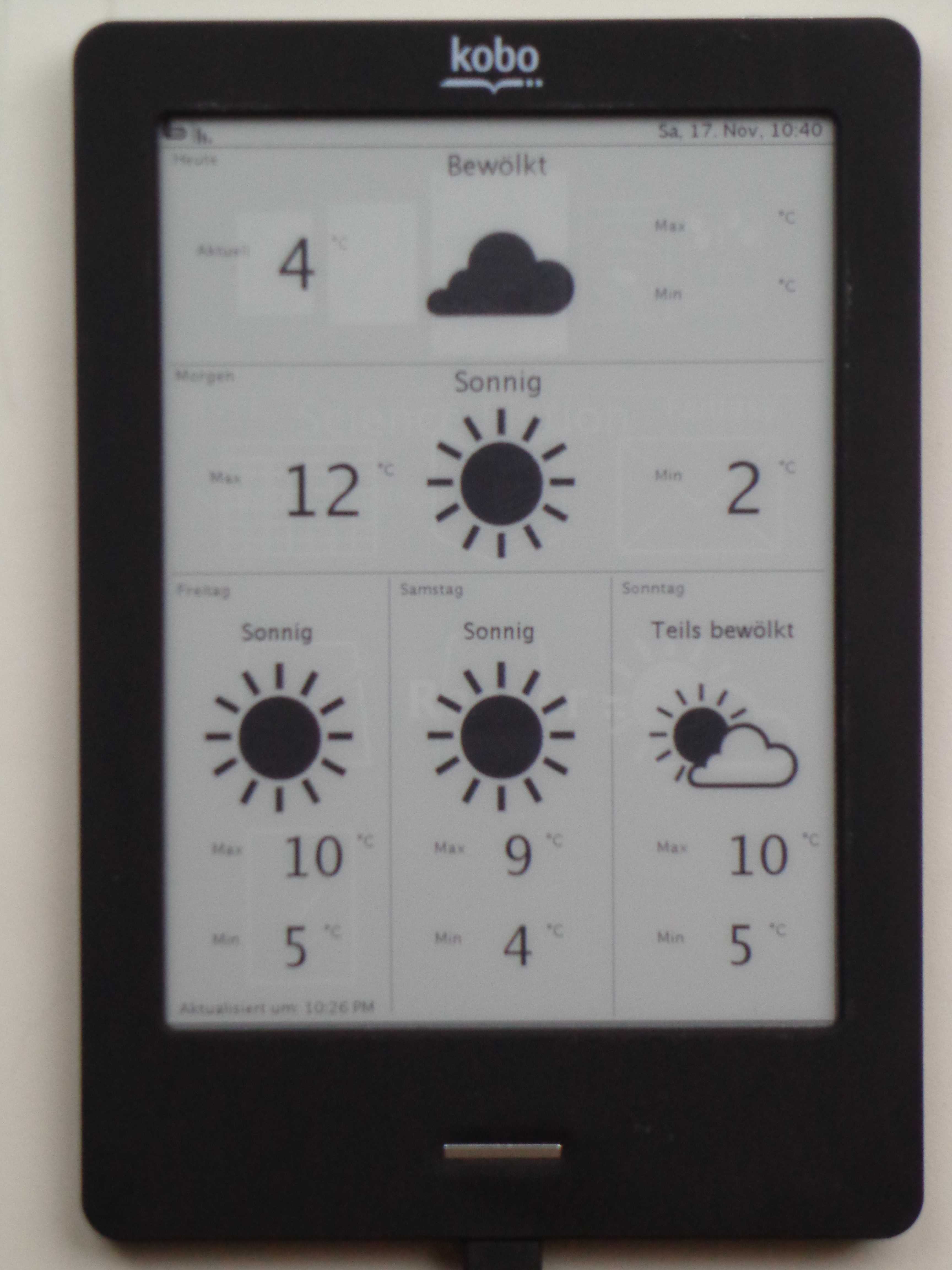

The Weather Applet is inspired by the great work of KevinShort https://www.mobileread.com/forums/sho...d.php?t=194376
As it can be seen on the pictures the User Interface is not consistent yet, some menu items are displayed as icons some as text. I am to date not sure what will be the best solution.
Also one can notice a lot of ghosting on the pictures, but this will be fixed in the future. All in all, there is still much room for improvement and a lot of work to be done.
