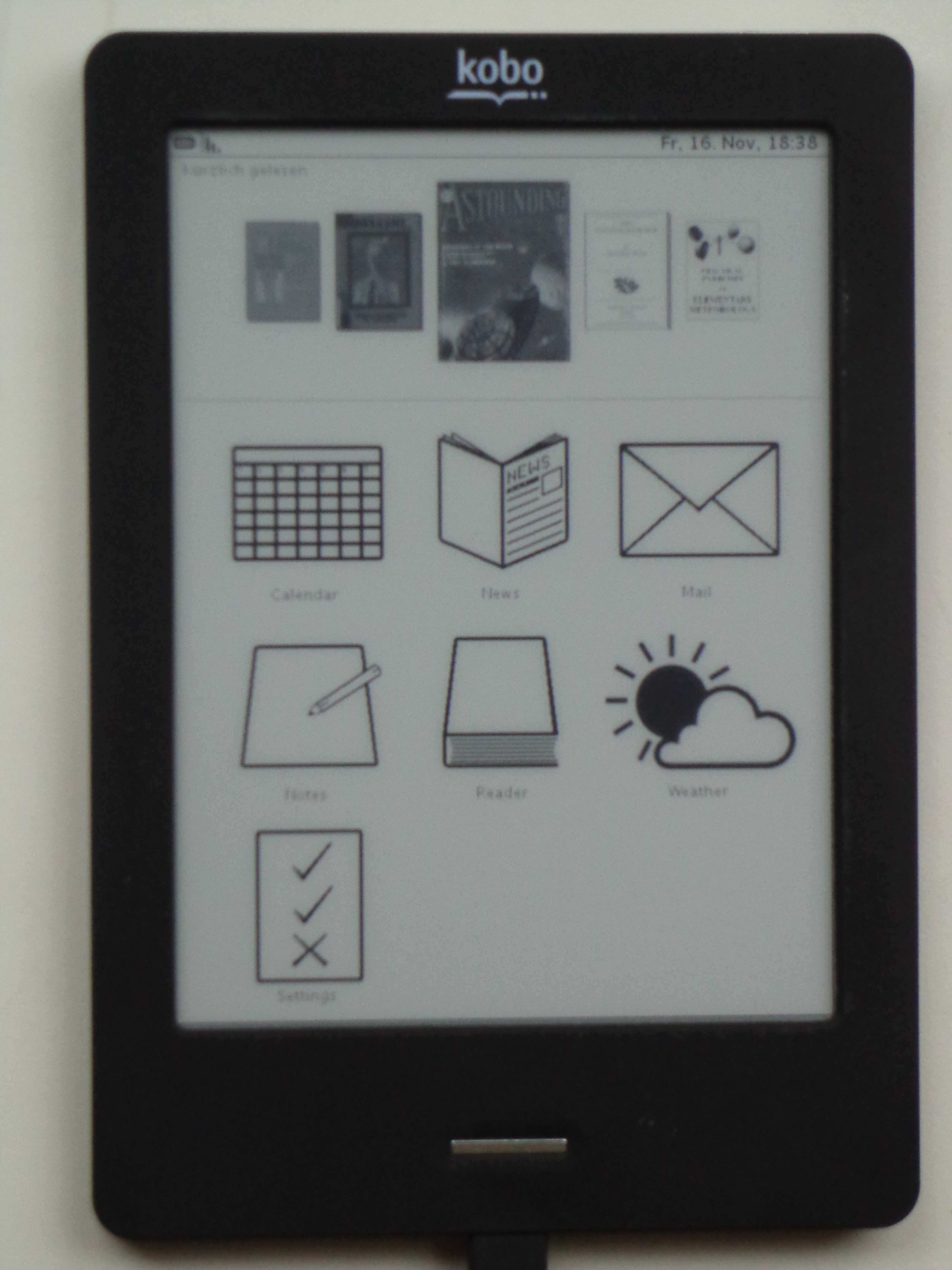

As promised a few days ago I provide some pictures of my nickel replacing Java application on my Kobo Touch.
The first one is the Home Screen.

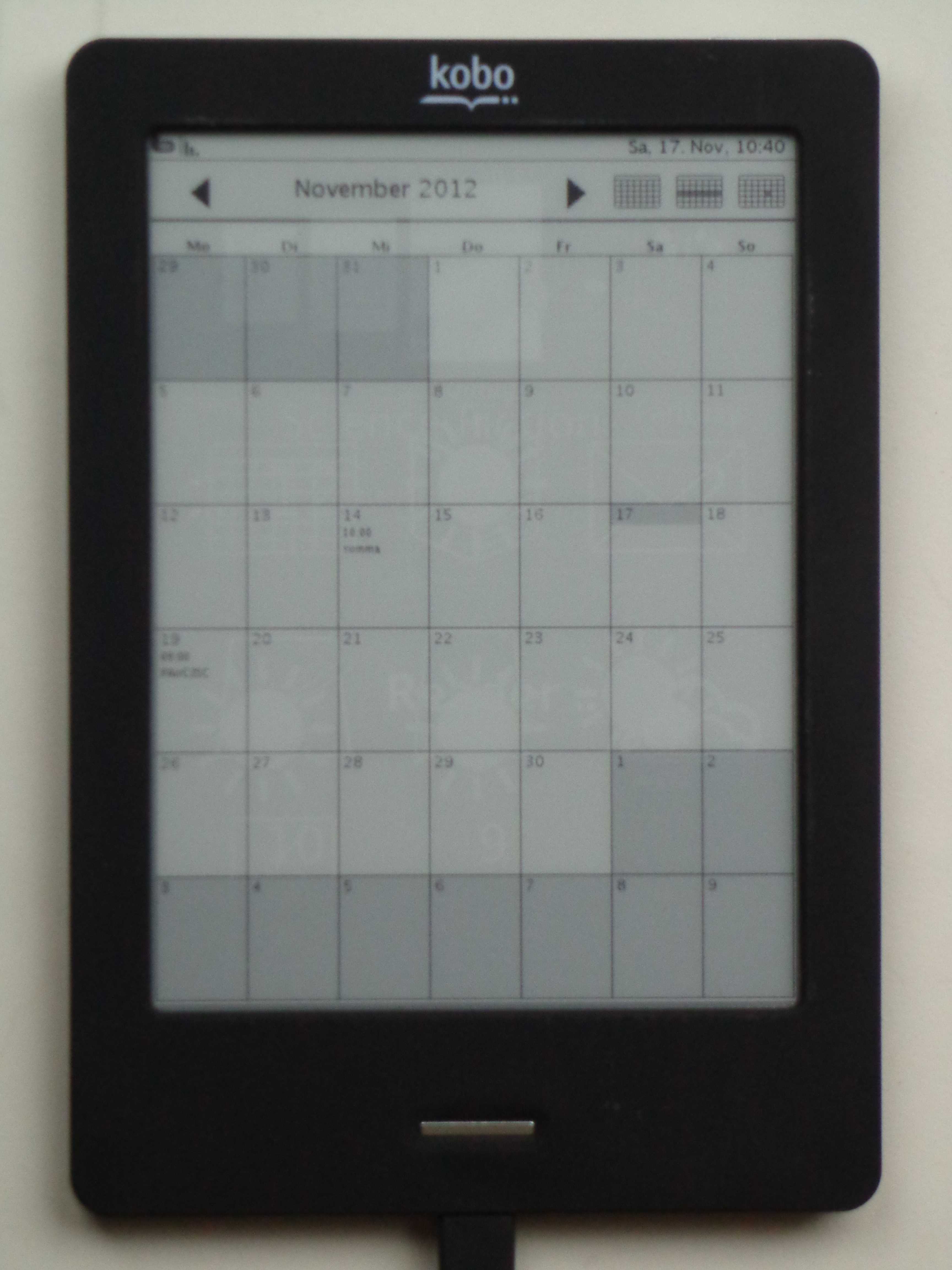

The upper part of the screen shows a list of recently read books. The lower part contains icons for several "Applets", e.g. Calendar, News, Mail or Reader.
The Calendar can be displayed in a month, week or day view. One can switch through the different views by tapping on the icons at the right part of the menu bar. With a swipe to the left or to the right one can go a month, a week or a day back or forward.

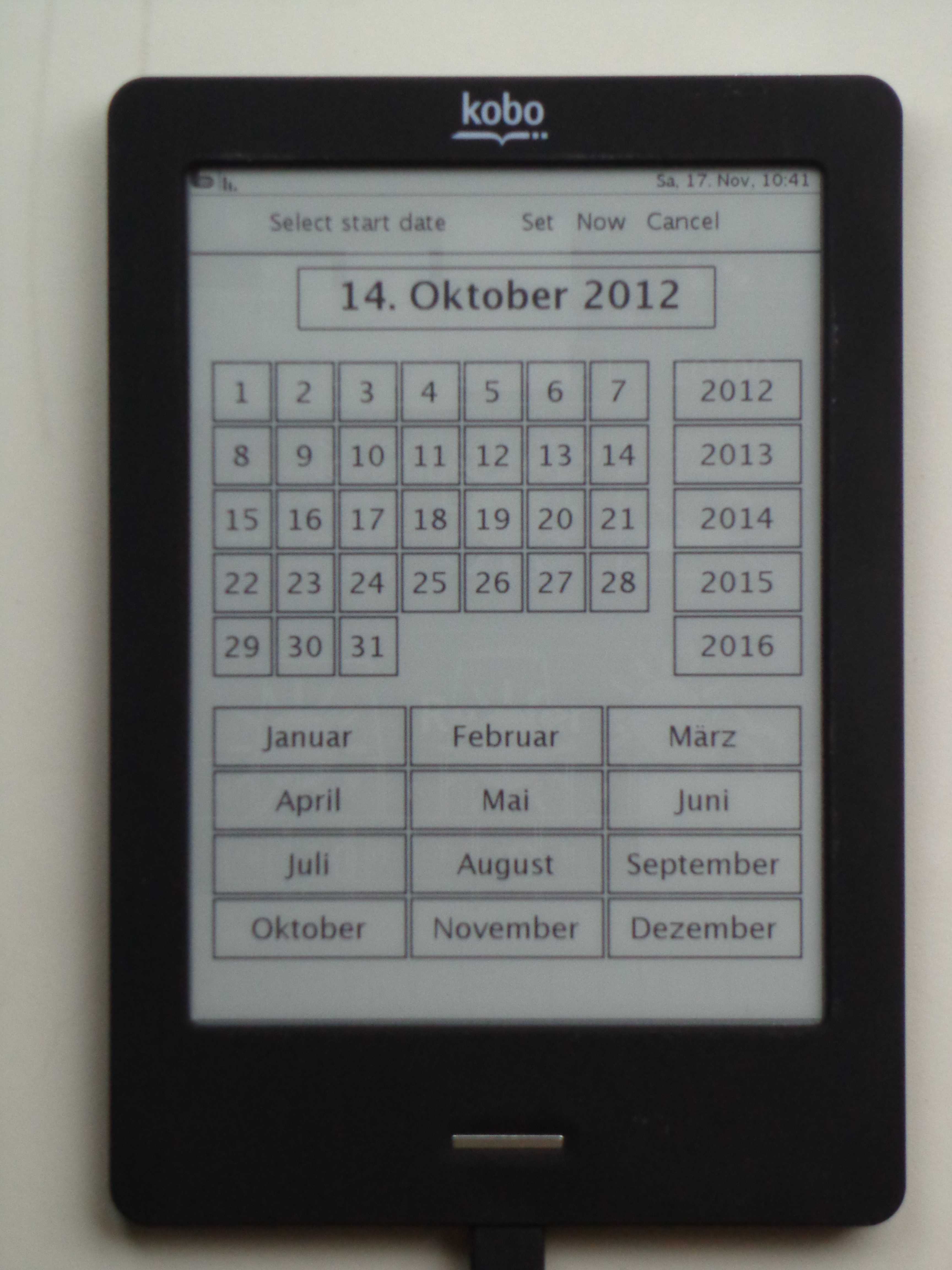

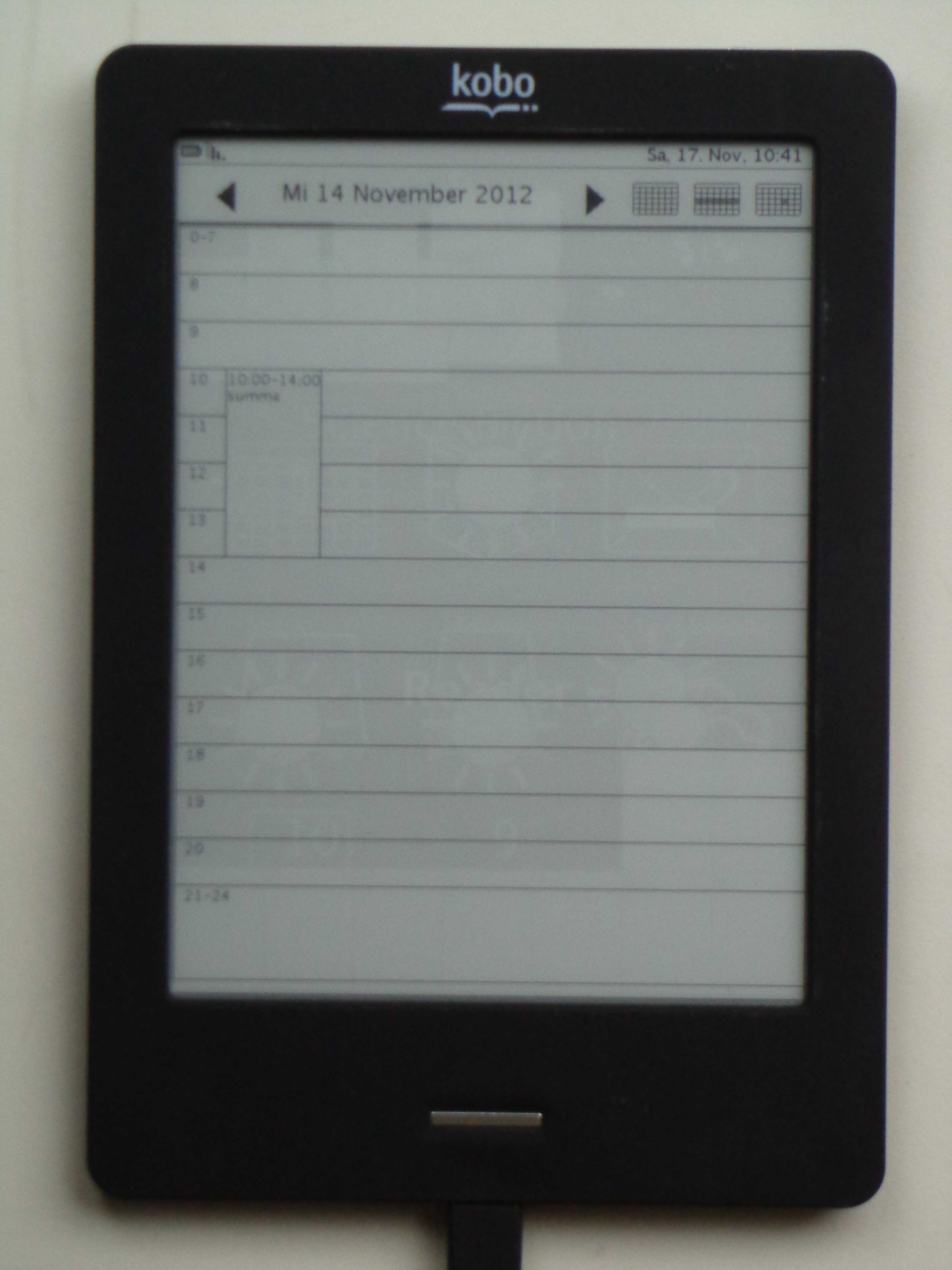

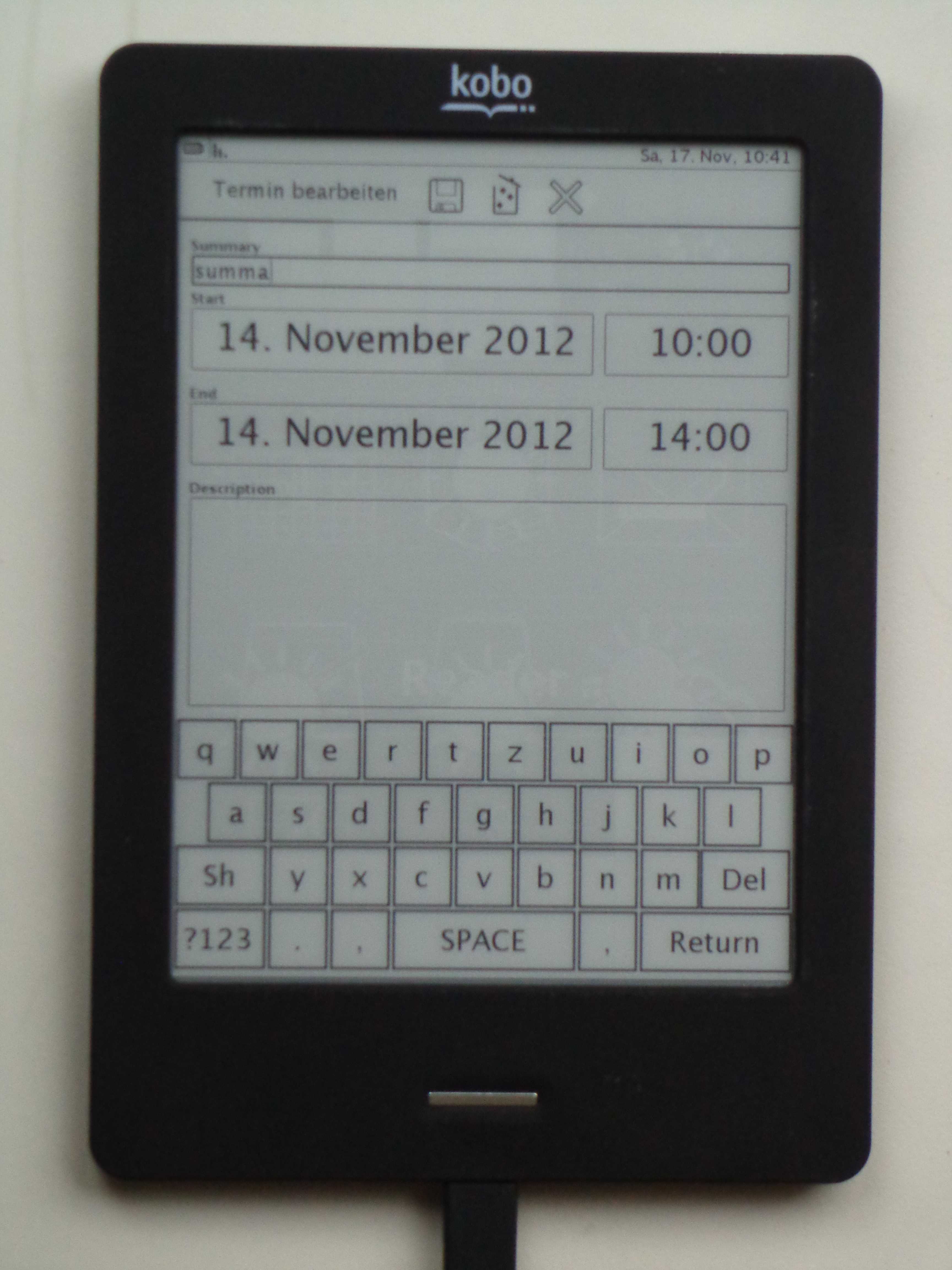

By a long tap one can create a new event, by a normal tap on an existing event one can modify the details of the event.
ID:	96308Click image for larger version
The events are stored in a file in XCAL (XML iCal)format. I hope to implement in future a synch mechanism for my thunderbird calendar at home.

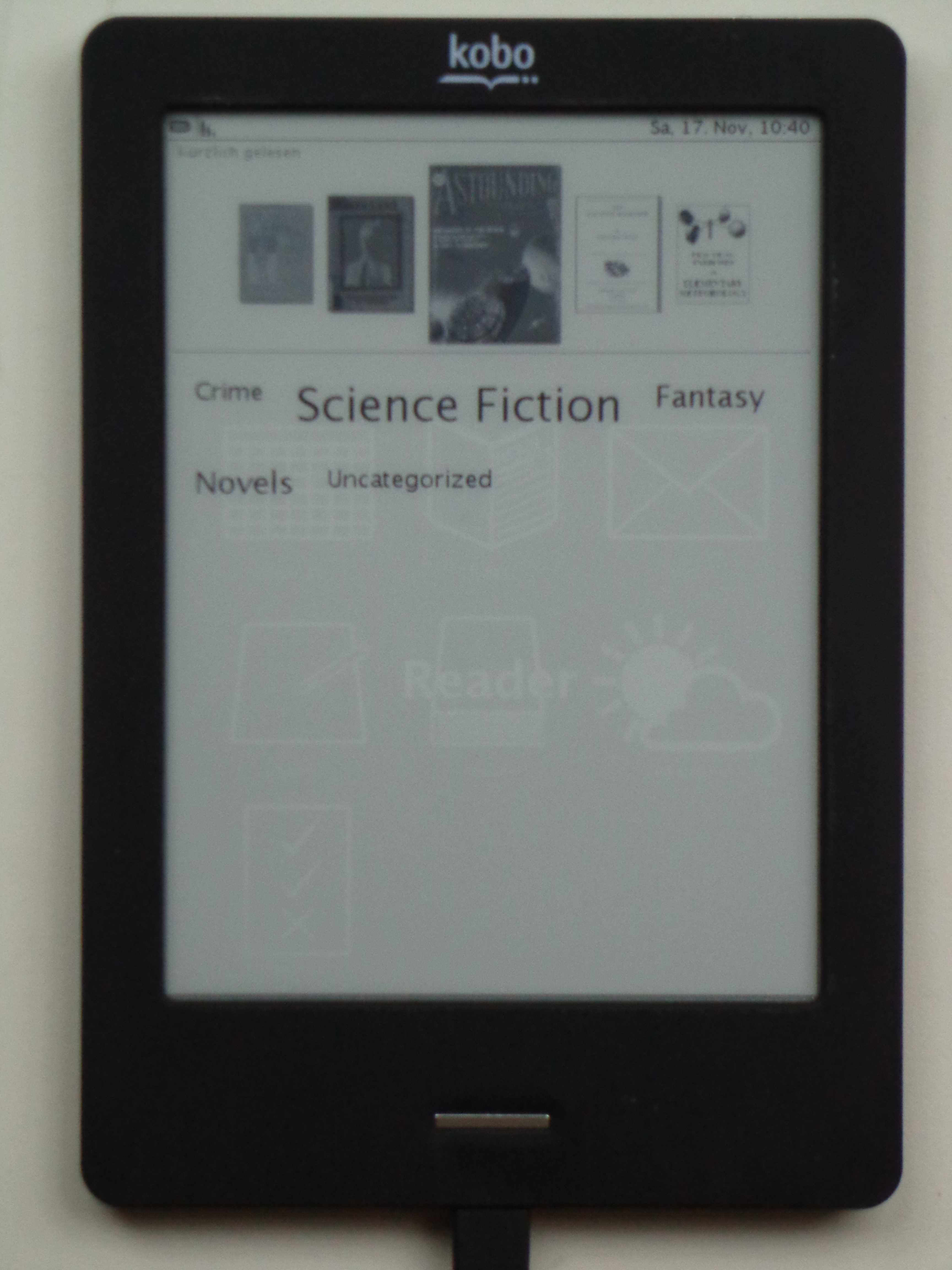

The Reading Applet shows the exiting book categories as a tag cloud considering the number of books in a particular category. Currently the category structure is file system based, that means each category is a directory in file system. That makes it easy to manipulate categories and add or remove books.
After a tap on a category, a list of the books in that category is diplayed to select the book to read (I haven´t finished this work yet).

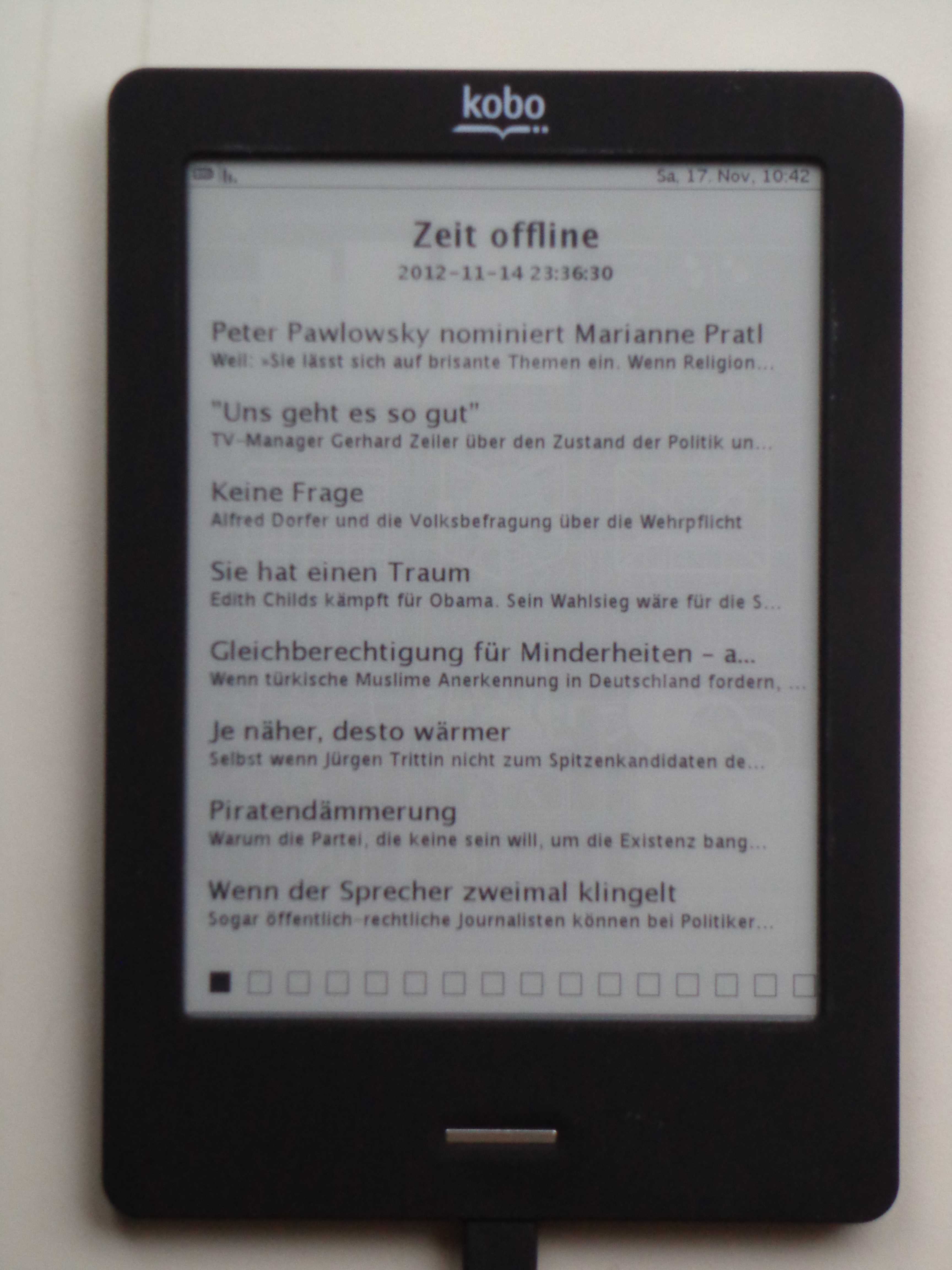

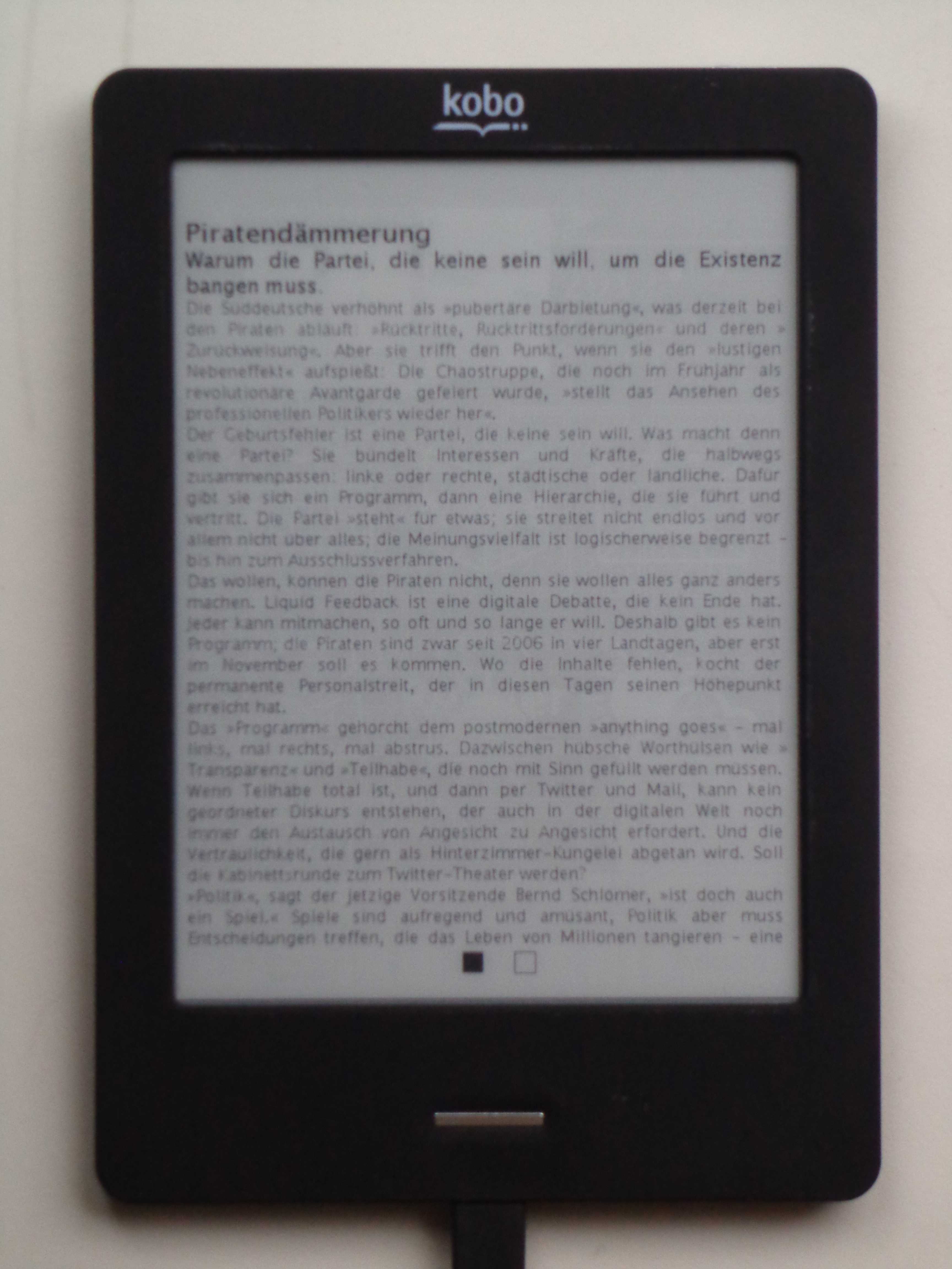

The News Applet displays my favorite online news. A separate application crawls the news webpages and compiles an ePub (without advertisements and pictures).

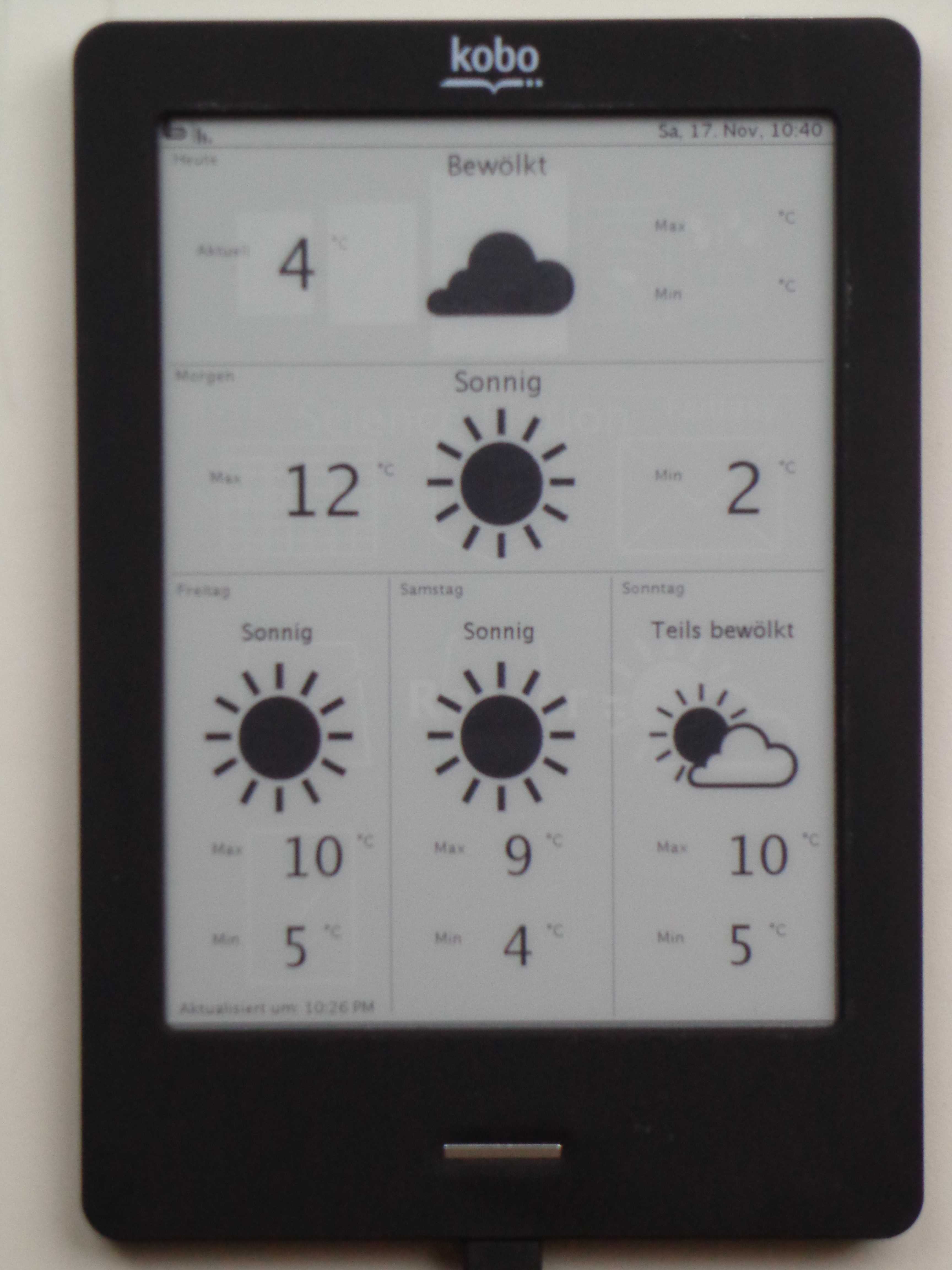

The Weather Applet is inspired by the great work of KevinShort https://www.mobileread.com/forums/sho...d.php?t=194376
As it can be seen on the pictures the User Interface is not consistent yet, some menu items are displayed as icons some as text. I am to date not sure what will be the best solution.
Also one can notice a lot of ghosting on the pictures, but this will be fixed in the future. All in all, there is still much room for improvement and a lot of work to be done.

Hello,
for me the japanese part works as-is - but nickel needs to be down.
I went a step further and also shut down the whole wifi interface again after I don´t use it anymore.
#!/bin/sh
killall wpa_supplicant
wlarm_le -i eth0 down
ifconfig eth0 down
rmmod dhd
rmmod sdio_wifi_pwr
My setup is based on an hourly cron job (during the day) with
  1. starts Wifi
  2. call an image generator php-script on my NAS
  3. downloades the ready-converted raw.gz
  4. shutdown wifi
The battery is now up for almost 1 week already - I still need to do a precise runtime measurement.
I am using this to read various temperature sensors in the house + a forecast from wunderground.com
The complete setup is being shown here

hello,
this is how it currently looks like (the battery level on right-top)
regarding the php-script:
  • basically its creating an image
  • filling it with e.g. a lot of imagettftext
  • rotating it
  • saving it
  • and executing a shell command to convert it
$im = ImageCreate (800, 600);
$rotate = ImageCreate (600, 800);
$rotate = imagerotate($im, 90 ,0);
imagepng($rotate, "kobo.png");
$convert = shell_exec("sh ./kobo.sh");
the shell script (on QNAP) is:
/mnt/ext/opt/medialibrary/bin/ffmpeg -i kobo.png -vf transpose=2 -f rawvideo -pix_fmt rgb565 -s 800x600 -y kobo.raw < /dev/null
gzip -c kobo.raw > kobo.raw.gz
z000ao8q is offline   Reply With Quote
