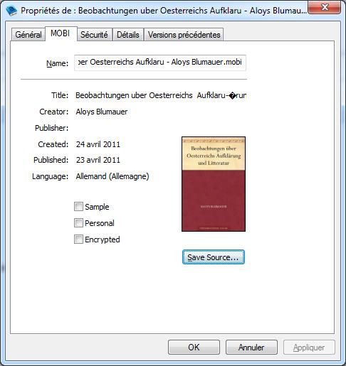

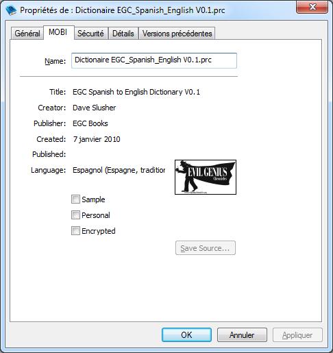

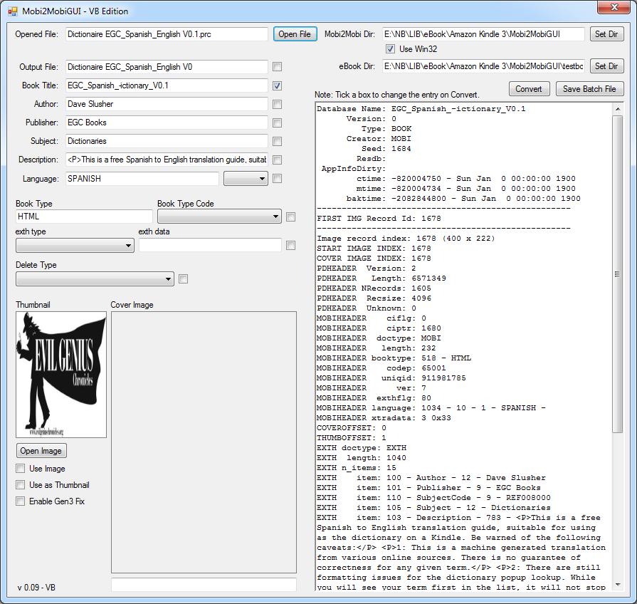

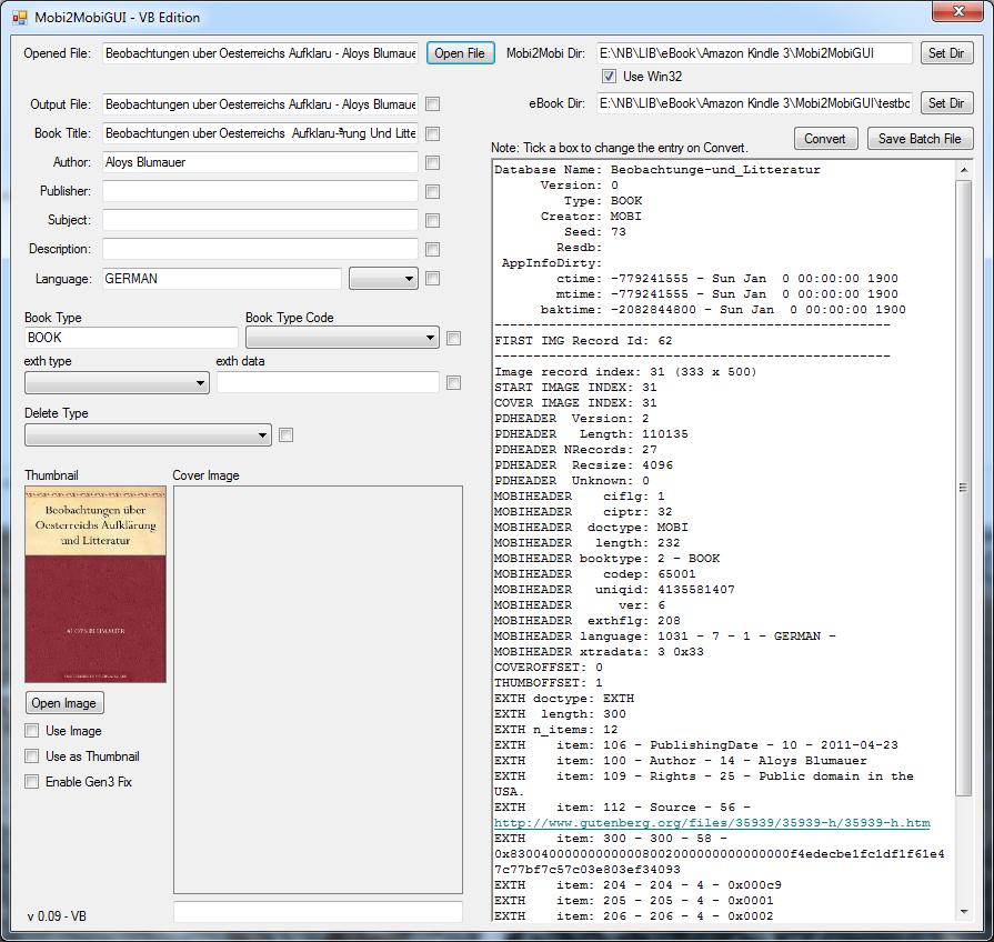

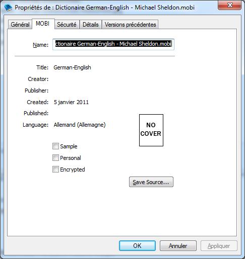

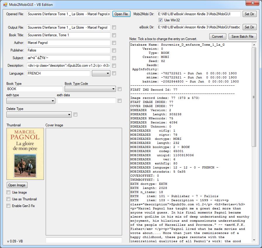

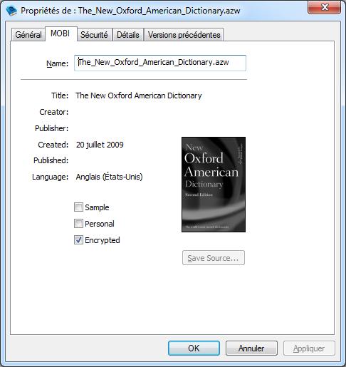

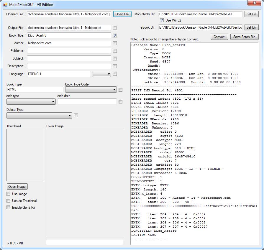

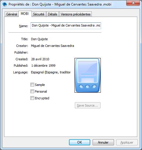

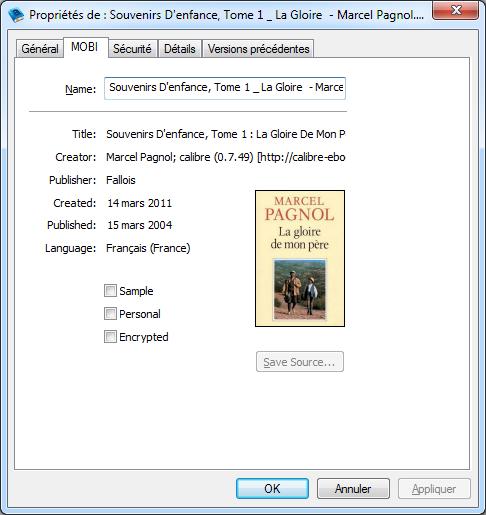

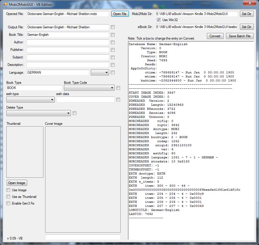

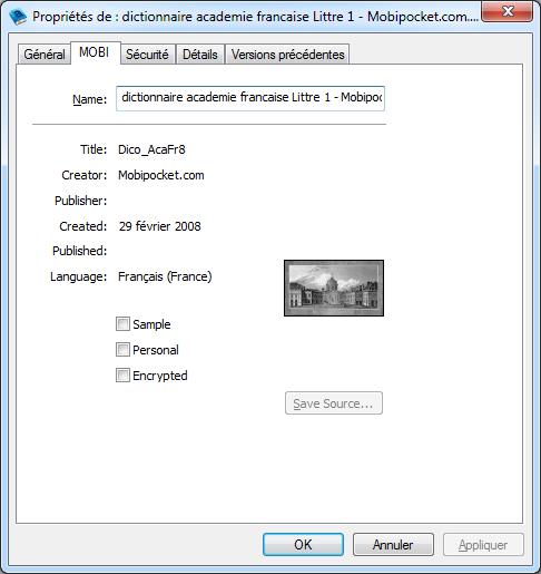

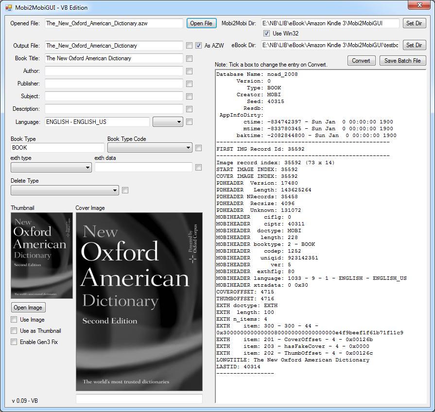

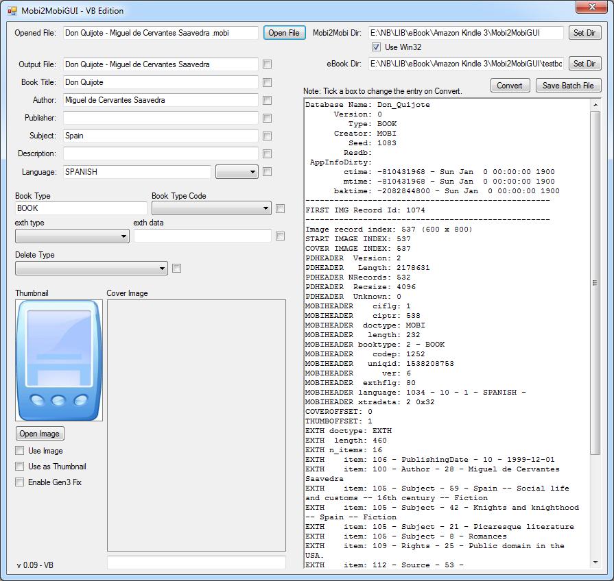

Well, I am still a bit struggling with this, an unable to pinpoint my problem:
- On my Kindle Wi-Fi 3.1 I have loaded several dictionaries and books in different languages.
- My default dictionary is the builtin English American dictionary.
- When I read books in french or english, the expected dictionary is automaticaly invoked. Good.
- When I read books in spanish or german (though I don't realy speak these languages I wanted to test further) only the default english dictionary is invoked. Bad.
I used Mobihandler and Mobi2Mobi to document the language metadata of the books and dictionaries. I think they indeed match:
FRENCH:
Dic:Click image for larger version
Name:	dictionnaire academie francaise Littre 1 - Mobipocket.com.prc Mobihandler (Français France).jpg
ID:	70731 Click image for larger version
Name:	dictionnaire academie francaise Littre 1 - Mobipocket.com.prc Mobi2Mobi (1036-12-1 French).jpg
ID:	70730Book: Click image for larger version
Name:	Souvenirs D'enfance Tome 1 _ La Gloire  - Marcel Pagnol.mobi Mobihandler (Français France).jpg
ID:	70733Click image for larger version
Name:	Souvenirs D'enfance Tome 1 _ La Gloire  - Marcel Pagnol.mobi Mobi2Mobir (12-12-0 French).jpg
SPANISH:
Dic: Click image for larger version
Name:	Dictionaire EGC_Spanish_English V0.1.prc Mobihandler (Espagnol Espagne).jpg
ID:	70735Click image for larger version
Name:	Dictionaire EGC_Spanish_English V0.1.prc Mobi2Mobi (1034-10-1 Spanish).jpg
ID:	70734Book: Click image for larger version
Name:	Don Quijote - Miguel de Cervantes Saavedra .mobi Mobihandler (Espagnol Espagne).jpg
ID:	70737Click image for larger version
Name:	Don Quijote - Miguel de Cervantes Saavedra .mobi Mobi2Mobi (1034-10-1 Spanish).jpg
GERMAN:
Name:	Dictionaire German-English - Michael Sheldon.mobi Mobihandler (Allemand Allemagne).jpg
ID:	70739Click image for larger version
Name:	Dictionaire German-English - Michael Sheldon.mobi Mobi2Mobi (1031-7-1 German).jpg
ID:	70738Book:Click image for larger version
Name:	Beobachtungen uber Oesterreichs Aufklaru - Aloys Blumauer.mobi Mobihandler (Allemand Allemagne).jpg
ID:	70744 Click image for larger version
Name:	Beobachtungen uber Oesterreichs Aufklaru - Aloys Blumauer.mobi Mobi2Mobi (1031-7-1 German).jpg
ENGLISH:
Name:	The_New_Oxford_American_Dictionary.azw Mobihandler (Anglais États-Unis).jpg
ID:	70741Click image for larger version
Name:	The_New_Oxford_American_Dictionary.azw Mobi2Mobi (1033-9-1 English US).jpg
Could that be the definition dictionaries are switched to automatically but not the translation ones? Or additional metadata that I am missing? Or... a bug in the Kindle software?

Originally Posted by PoP View Post
...Or additional metadata that I am missing?
I solved my own problem.
From https://wiki.mobileread.com/wiki/MOBI I noticed in that in the MOBI header, at offsets 96 and 100 are the input and output languages for dictionaries.
It seems that Mobi2Mobi is reporting the language locale field at offset 92 and ignores the two next fields.
I then used a Hex editor to patch these fields in my spanish dictionary to 1034 1034 and in my german dictionary to 1031 1031 (replicating the language locale field indicated by Mobi2Mobi from offset 92).
Now all my dictionaries are switched to properly depending on the language locale of the book read.

Counting from the "MOBI" character string at offset 16 and adding 76 one finds 3 fields of 4 bytes each in your attached screen capture:
at offset 92 x'0009' this is the language the book is written into (english),
at offset 96 x'0009', for dictionaries this is the language you are translating from (english) and,
at offset 100 x'0009' the language you are translating to (english) meaning, I guess, this is not a translation but a definition dictionary.
thank you very much. I succeed understand this wiki said https://wiki.mobileread.com/wiki/MOBI#MOBI_Header and I also found why '09' meaning English, because it's Locale IDs Assigned by Microsoft, find more at this
