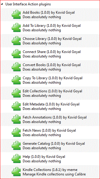

Is the plugin definitely installed?
go to Preferences->Plugins
then expand User Interface Action plugins
is Kindle Collections in the list - what version?
If it is in the list, then
go to Preferences->Toolbar
change the drop down box that says 'The main toolbar' to 'The main toolbar when a device is connected'
look in the icon list on the left or the right (you might have to scroll each list)
do you see Kindle Collections?
meme is offline
Old 05-15-2011, 04:04 AM   #820
belfastbiker
belfastbiker began at the beginning.
Posts: 20
Join Date: Oct 2009
Device: iPhone 3GS, Kindle 3, Mac, PC
"Kindle Collections (1.6.1) by meme"
look in the icon list on the left or the right (you might have to scroll each list) do you see Kindle Collections?
It's on NEITHER side for some reason. Of any of the menus for that matter. (TY BTW.)

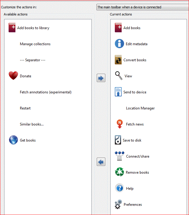

A mystery. Have you tried changing the drop down men to other settings? Can you screenshot the toolbar preferences window and post it - to see what is selected?
meme is offline
Old 05-15-2011, 04:29 AM   #822
belfastbiker
Posts: 20
Join Date: Oct 2009
Here you go.

That is definitely odd. And you've said you've uninstalled and re-installed. Well, Calibre does retain some information about the plugin between runs. Before we try to edit that file can you test another plugin.
Can you try installing one of the other plugins and see if you get their icon in your preferences->toolbar to select?
And just to recheck - do you have the 'Kindle Collections' menu in the text menubar above the main toolbar? If so, when you select 'menubar' in preferences->toolbar you should see the icon in the list.
meme is offline
Old 05-15-2011, 05:36 AM   #824
belfastbiker
Posts: 20
Join Date: Oct 2009
1. tested a goodreads addon, to sync things there, and getting an error message re: having to restart calibre before I can configure it.
2. I have no text menubar.
belfastbiker is offline
Old 05-15-2011, 05:47 AM   #825
belfastbiker
Posts: 20
Join Date: Oct 2009
Sorted. Both yours and the GoodReads plugins now appear to be there - uninstalled Calibre, downloaded from alt. location, installed it. No further need to reinstall plugins they just appear to work. TY for your help!
