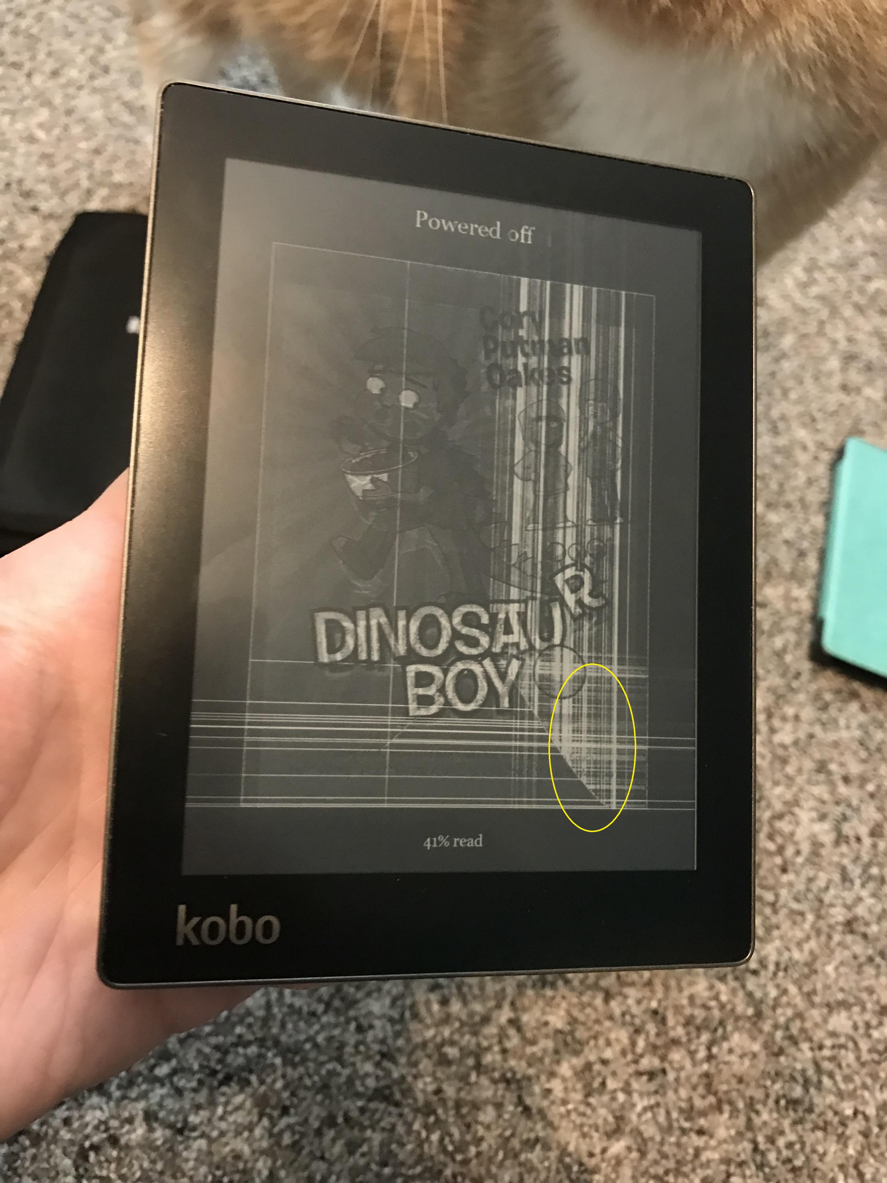

A broken substrate is noted for curved lines. Controller/cable issues are noted for straight lines.
This has no curved lines and does have straight lines.

This is not a broken substrate in this case, Jon. Please allow the conversation to move on to what it it actually might be.
Jon, take a look at the area I circled area in the image you posted.
