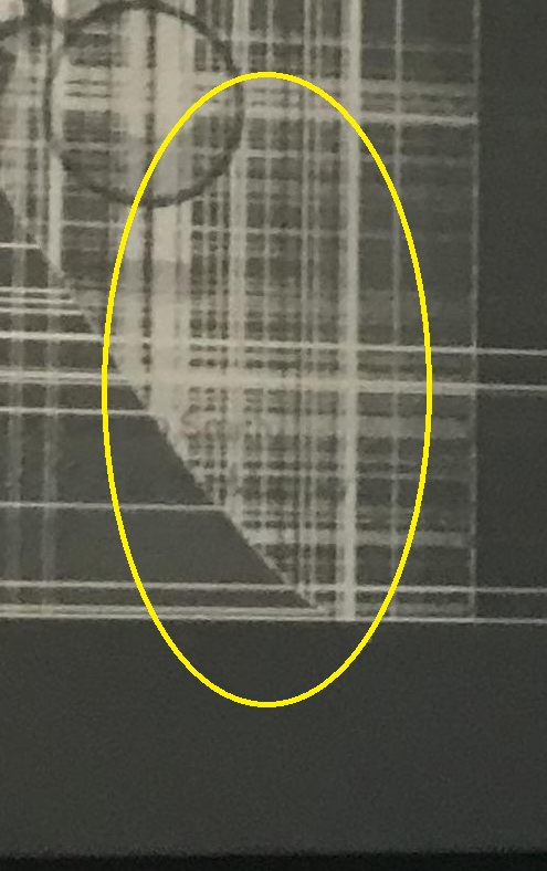

Old 06-19-2025, 08:48 AM   #40
Posts: 81,086
Karma: 150263703
A broken substrate is noted for curved lines. Controller/cable issues are noted for straight lines.
This has no curved lines and does have straight lines.
Old 06-19-2025, 09:00 AM   #41
DiapDealer
DiapDealer's Avatar
Posts: 28,938
Karma: 207302948
This is not a broken substrate in this case, Jon. Please allow the conversation to move on to what it it actually might be.

Old 06-19-2025, 09:28 PM   #44
Posts: 48,854
Karma: 174631580
Jon, take a look at the area I circled area in the image you posted.
ID:	216360   Click image for larger version
