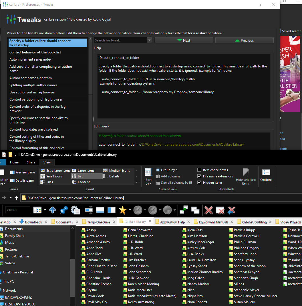

From this, you should be able to work out what directory is being mounted as a folder device. It will be the common directory for all these books. And it will have two files that calibre uses, "metadata.calibre" and "driveinfo.calibre", in it. But, there is a tweak in the preferences to automatically connect to a folder at startup. This is called "Specify a folder calibre should connect to at startup". Go to that in the Tweaks page of the preferences and you will see what directory is being used. And you can clear this by pressing the "Reset this tweak" button and applying the changes.

As you'll see in this screen shot below, the Auto Connect Startup folder was the exact same folder as my Library:
After pressing the "Reset this tweak" button and applying the changes Calibre no longer opens to a device.

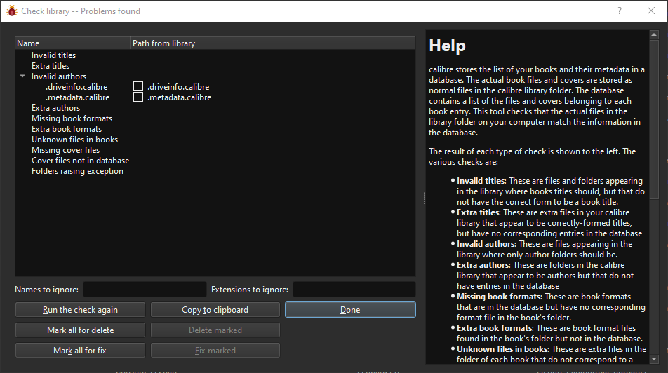

I'd also like to mention something else that I have observed all along and still do. When I run Check Library it states:
"Found no errors in your caibre library database. Do you want calibre to check if the files in your library match the information in the database?"
When I click Yes, the only issue that appears is within invalid authors section as shown here:
BTW, does this forum block images from IMGUR.com from being shown within a post? I asked because these links work everywhere except here even though I used the "Insert image" button. Since I can't get them to show, I've attached them instead.
And that is what was expected from comments made earlier. This was a very bad thing and you are probably lucky your library wasn't corrupted. The fact it wasn't was probably because you never tried to send a book to the device.
Because you are connecting to your library as a device, that is expected. Calibre creates those files to help track what is on the device. But, when it is treating the directory as a library, these files are not expected.

I was able to check the boxes for the invalid authors shown in the screen shot and then click the delete marked button. All is good now.
