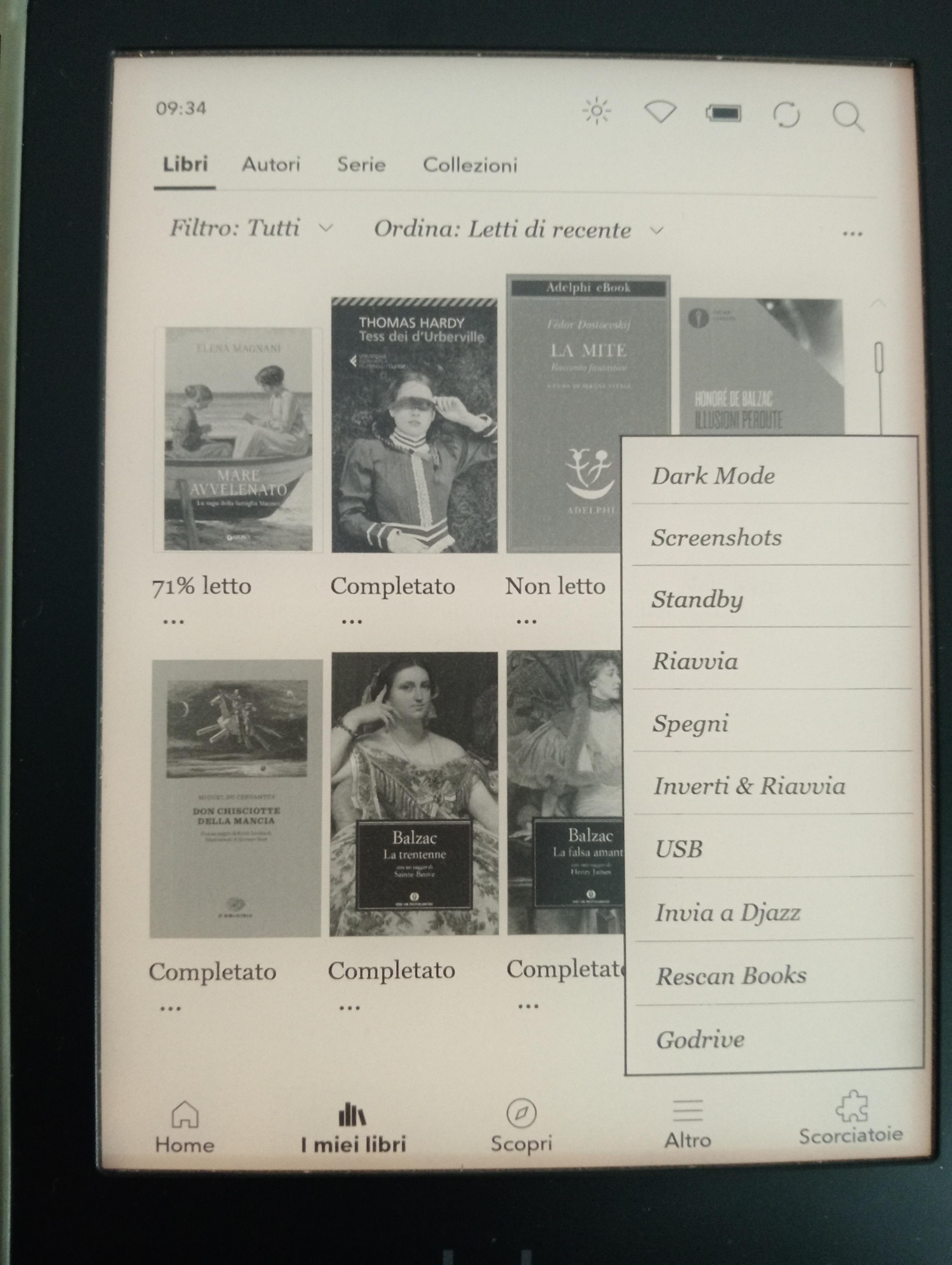

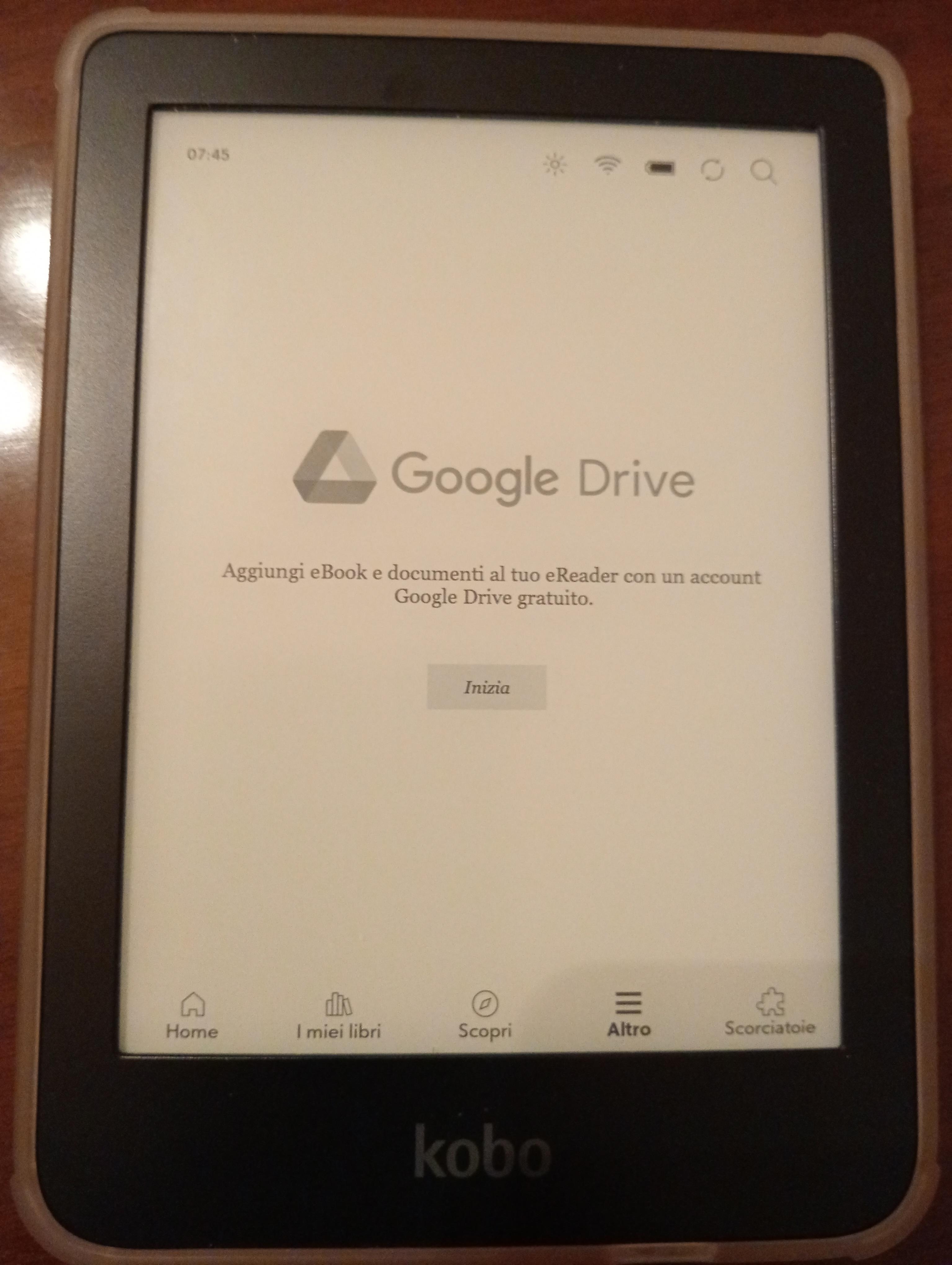

I finally connected my Kobo to Google Drive, gave all the authorizations asked, now there's even a Rakuten Kobo folder in my Google Drive etc... but now when I click on "Get started" in the Google Drive page on my kobo, it stops on a white "charging page" mode and couldn't even download any of the kepubs I have on the Rakuten folder despite the synchronization. I even tried to reboot my Kobo but it still doesn't work.

ID:	211592   Click image for larger version

Originally Posted by tokyoinovember View Post
I almost made it work!!!
Great!.
Kobo Claras (HD, 2E, BW, Color) doesn't have Google Drive or Dropbox section.
Turn on the WiFi and Use Nickelmenu to open Google Drive

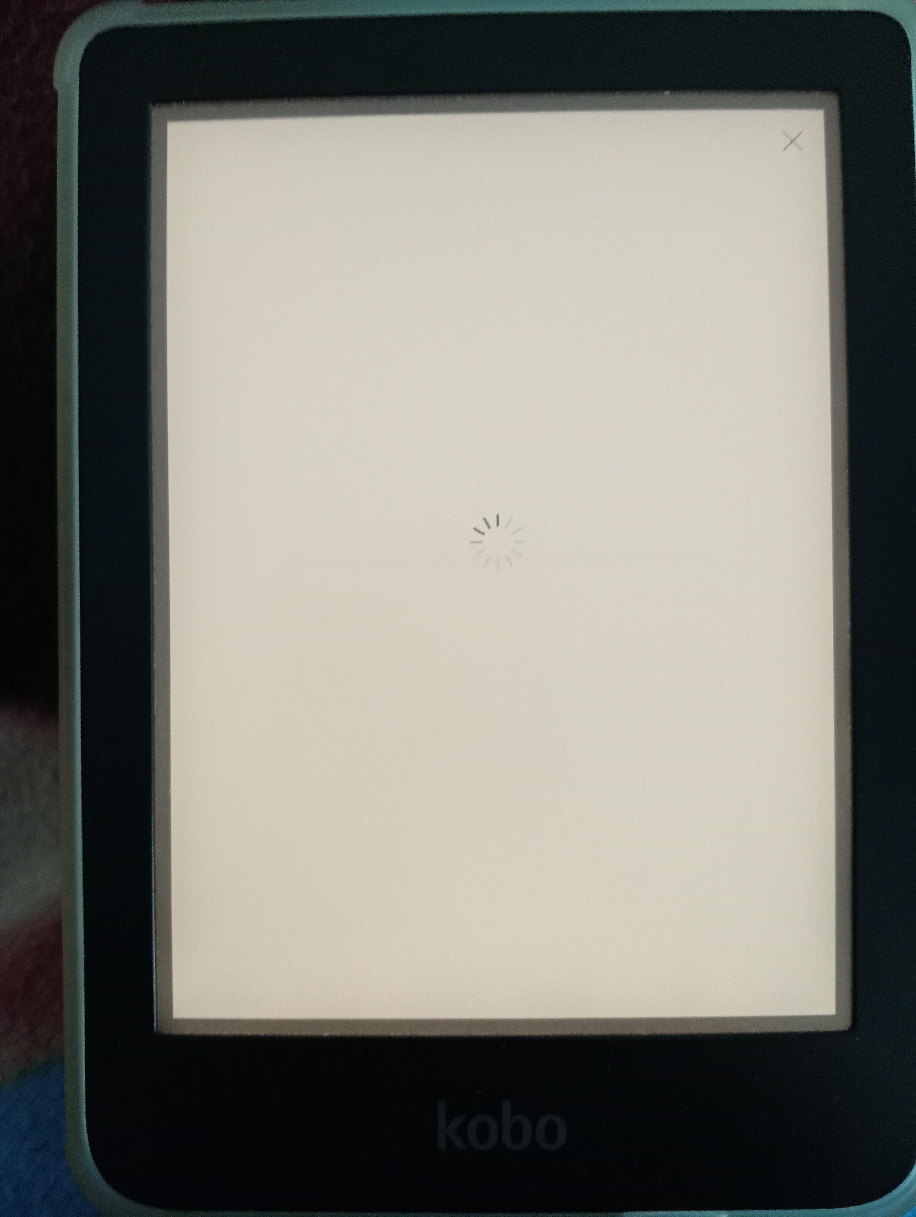

That's what I did but it doesn't go beyond the white charging page. Unless I'm missing something.

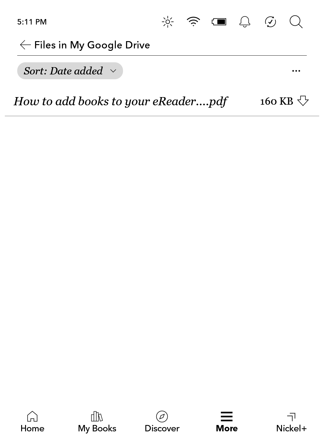

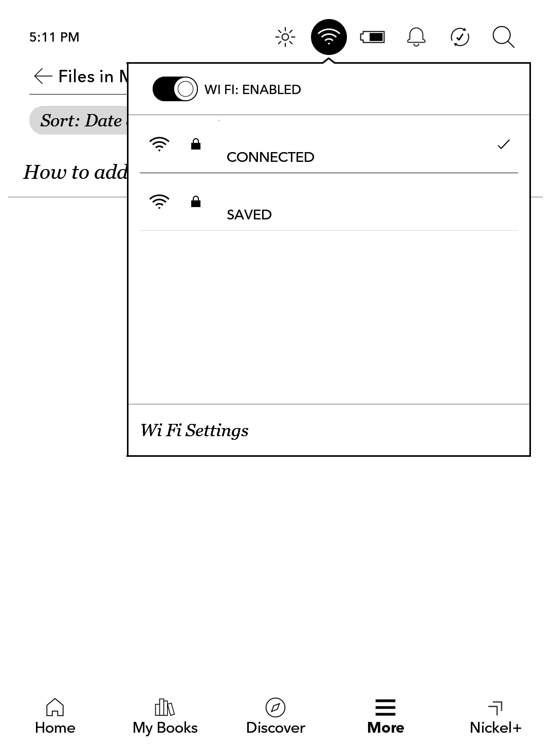

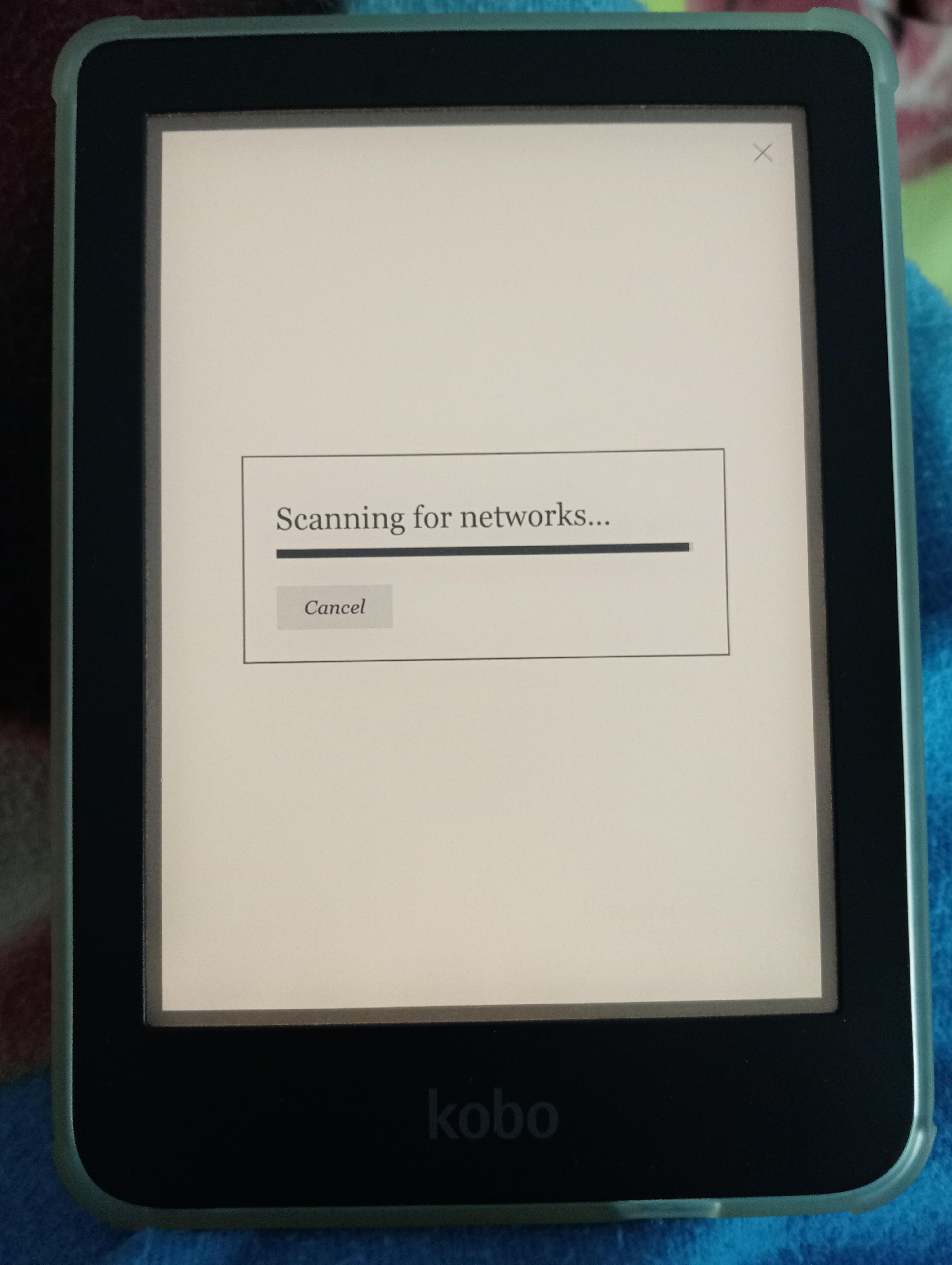

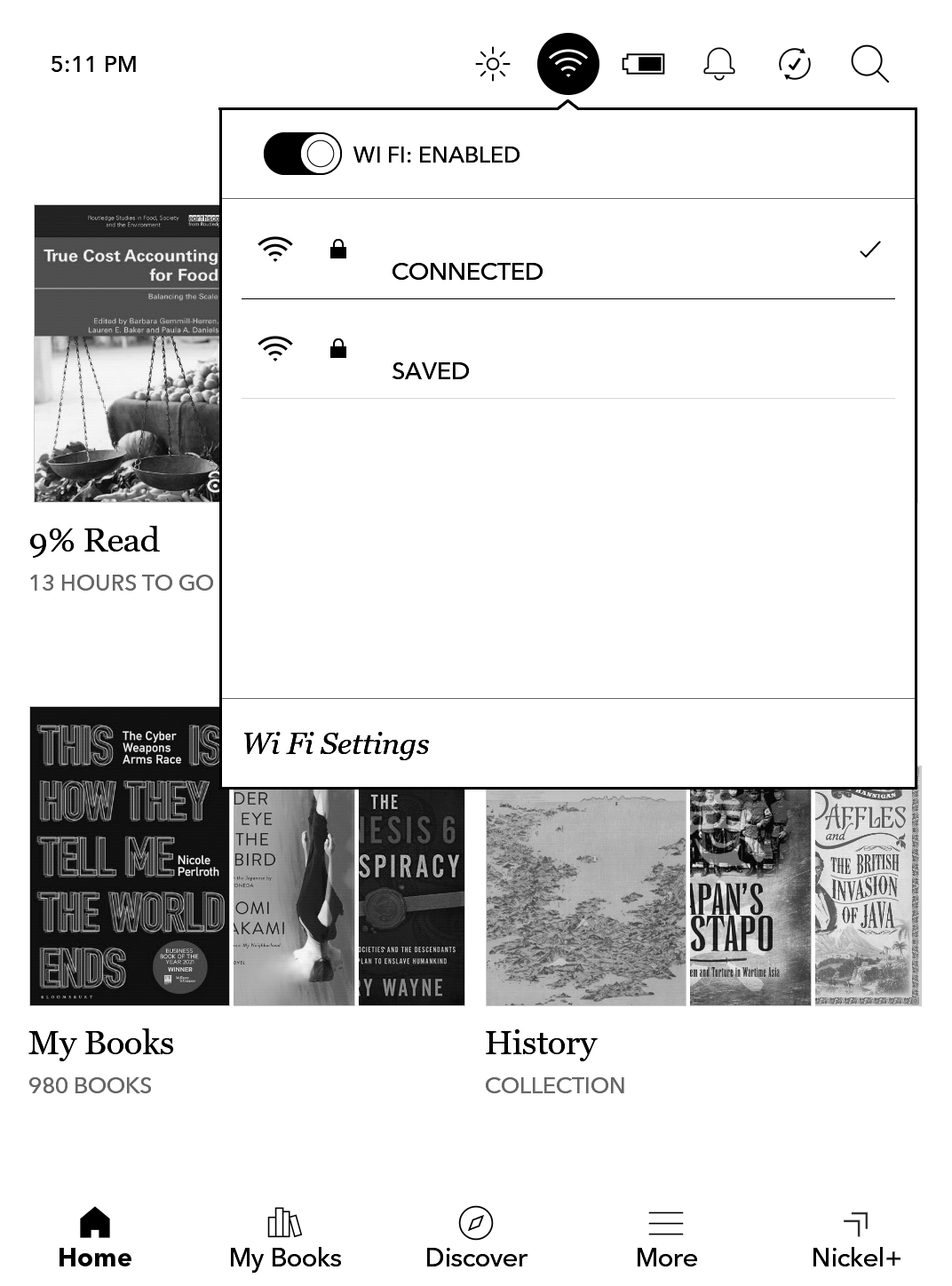

In my experience, if the white charging page appears, it means my Kobo Clara 2E's Wi-Fi connection is not connected yet (or is in the process of being connected).
Ensure the WiFi is connected and then open Google Drive (and Dropbox) through Nickelmenu.
ID:	211599   Click image for larger version
ID:	211600   Click image for larger version

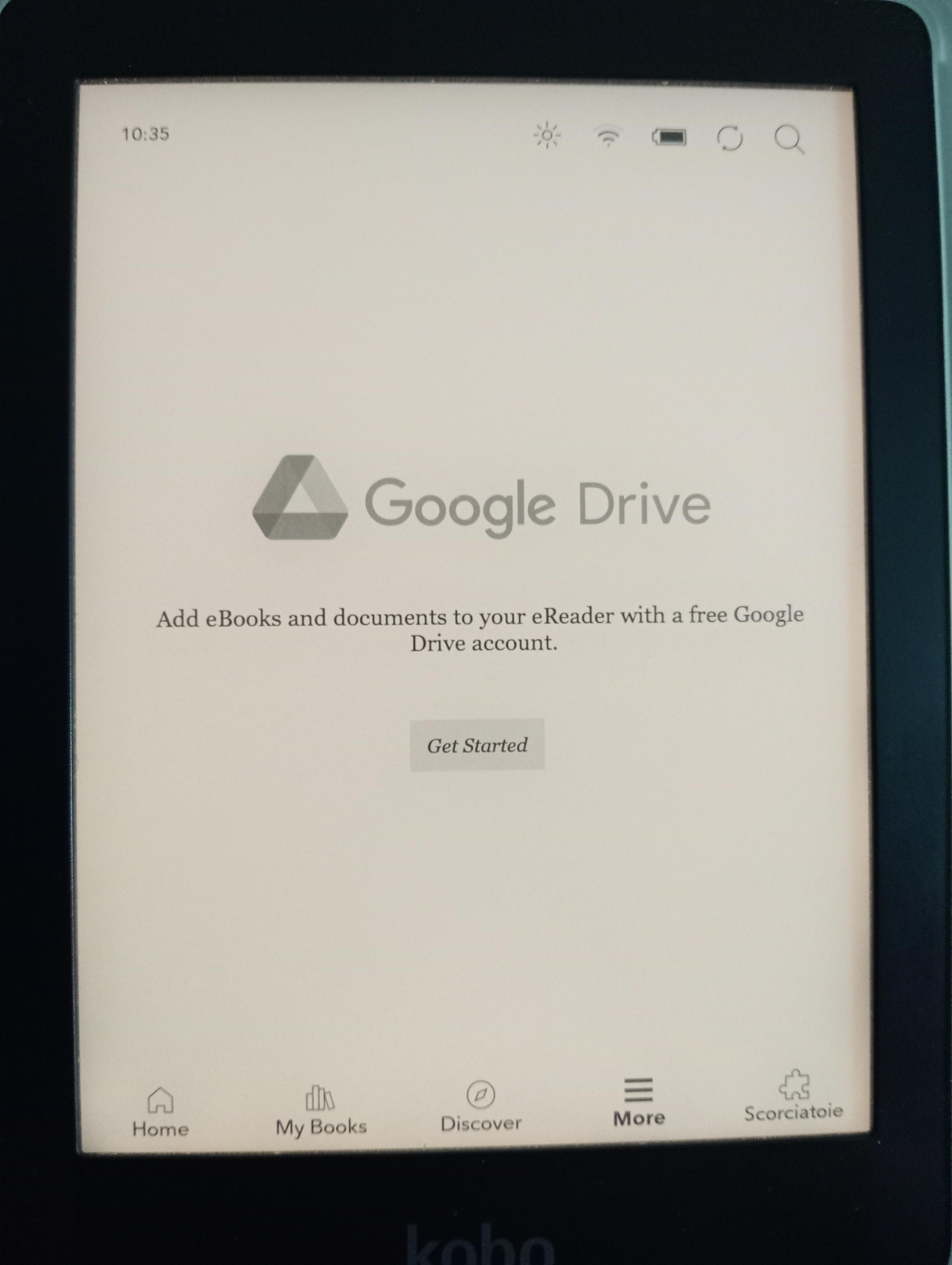

The WiFi is on and it works. It seems like Google Drive is not able to connect anymore. It's just stucked on the loading page.
Edit: Is it normal that in my eReader.conf the line I previously copied disappeared and the kobo_google_drive_link_account_enabled=True is now back on false?
Anyway, I tried to reinstall everything and nothing changed.
ID:	211602   Click image for larger version
ID:	211604   Click image for larger version

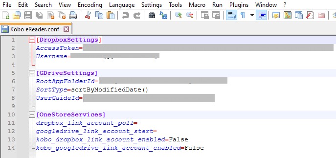

That is ok, see the attachment screenshot.
The pop-up window displays Scanning for networks, as shown in your attachment (image no.2).
It informs you that WiFi is not connected yet so you will have a blank page (image no. 3).
Make sure the WiFi is connected and stable before executing the Godrive command via Nickelmenu.
Note:
When Kobo is successfully authorized to Google Drive and Dropbox.
You will find the new lines for Google Drive and Dropbox settings in the Kobo eReader.conf file as shown in the attached screenshot.
If you find no authorized line for Google Drive, you may need to set it up as per post nbr.7

Edit: I don't know if this matters but another thing that I've noticed in the conifg file is that these lines
googledrive_link_account_start=https://authorize.kobo.com/{region}/{language}/linkcloudstorage/provider/google_drive AND kobo_googledrive_link_account_enabled=True
other than combing back to the way they were written before (aka without the part I had to add) they also aren't one under the other despite me having copy pasted them exactly as suggested.
Those lines should be under [OneStoreService]. When you run Google Drive, you will go through the authorization process again.
Once the authorization process is successful you will be directed to the Google Drive page that shows the list of your books on Google Drive.
In the Kobo configuration file, you will have the GD authorization lines as shown in my previous comment.
That's what happen on my Clara 2E.

Device: Kobo Clara 2E
So, I created a folder in my Google Drive to download books from there and I enabled the option that says that everyone who has the link have access to that folder, but I've noticed that every time I try to open that link in my Kobo via NickelMenu (menu_item : main : Google Drive : nickel_browser : https:// ...) or the Browser itself (I either sent that link to my Gmail account and tried to open it from there and also tried to open my Google Drive account googling it) but it never works and it says "folder cannot be found" and it's still stucked on a charging mode.
I tried to open that link with other devices and it works, so the problem must be my device. I guess this is the same reason why any of my attempts to enable Google Drive on my Kobo didn't work. So weird!
