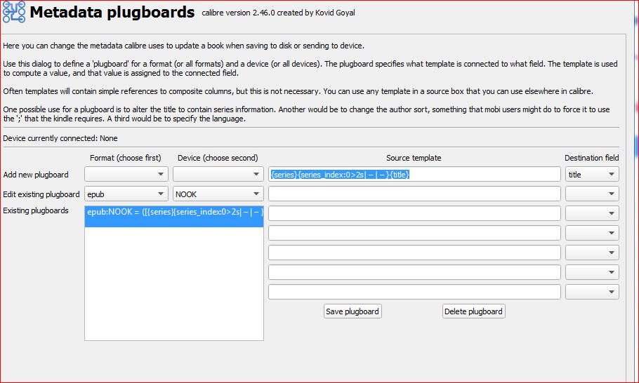

Hey again. As for "antique" I have a Simple Touch, not the original. The choices are NOOK or NOOK COLOR so I picked the first one. I will try the Any Device option and see what that changes.
When I am connected (device/cable/cablibre) it says Connected The Nook. Should I be doing anything with the device options I get when I click on the device drop down? (conifgure/update cached metadata) Note: some of the series I am trying to update with this series-title change were on the device formerly (pre-calibre loading), then deleted via the folder explorer, the reloaded with Calibre. Would that make any difference? My NOOK Simple Touch software is up to date. I appreciate the continued efforts to help. Last edited by Aliarides; 12-28-2015 at 05:53 PM. |

The message at the bottom of the screen usually matches the driver (Named for the first model that uses that profile). The original Nook had a slight small screen. The Color: went to 800x600. Maybe they also changed the DB structure??You are the first I remember, having Nook plugboard issues (and the ST has been around more than a few weeks ), that does not totally eliminate a gotcha, but it seems unusual.Can you copy and paste you template FROM the plugboard. (I say copy and paste, so we see the precise entry. Typos do lurk )

I verified software version via B/N website. I posted an image earlier in this thread. Here it is again. Last edited by Aliarides; 12-28-2015 at 06:55 PM. |
