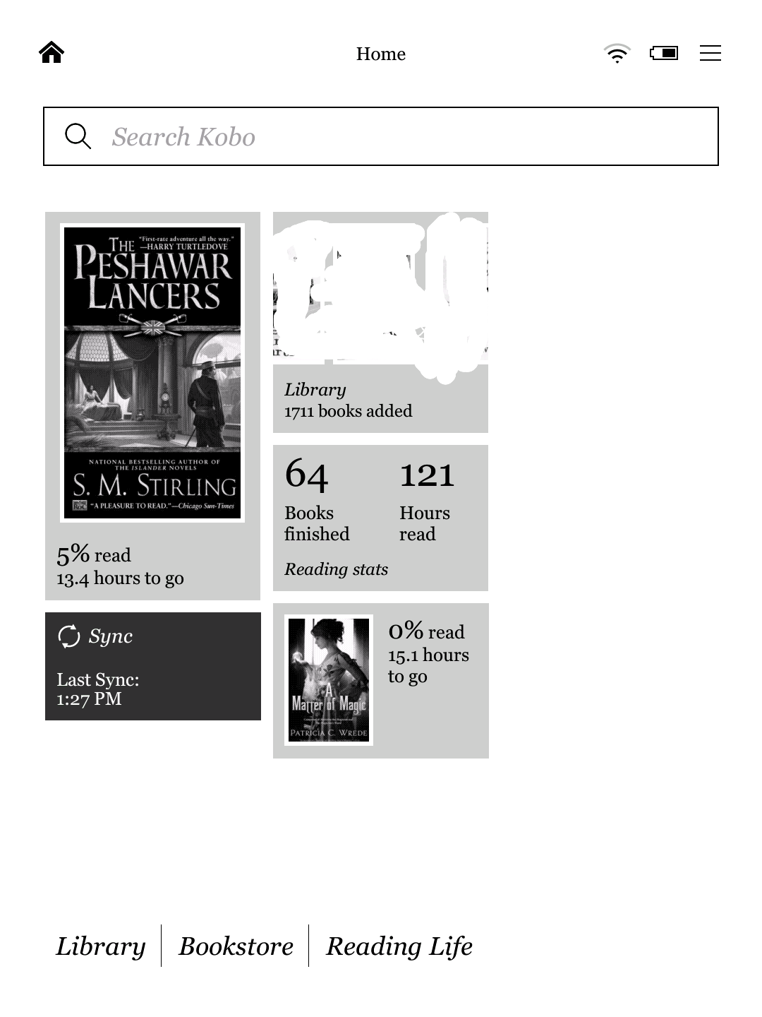

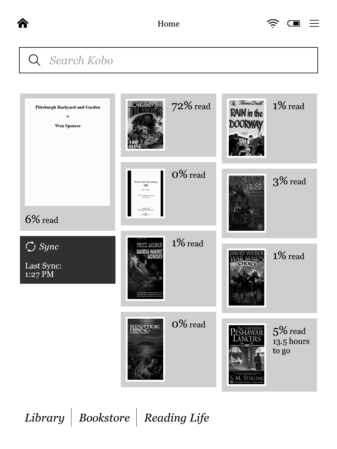

Just tried using the Screenshots option and got these results before and after. It did trigger off the power key so no sleep or power off unless I remove the option.
Regards,
David
ID:	108805   Click image for larger version
Looking at the screenshots and thinking back, I have seen something like that. But, usually I have non-book tiles as well so it isn't as noticeable. The Sync tile is the one I see as I have the DB trigger getting rid of it.
I hadn't realised there is a difference between the tiles on the Glo and AuraHD. The Glo displays the text below the cover and it doesn't include the time remaining except on for the current book.
But what I am most intrigued by is what embarrassing book happened to be in the middle of the library tile Personally, I would have hidden "Sense and Sensibility".
The one in the middle of the library tile was Wen Spencer's For Blue Sky which is a free read which I downloaded and converted to an .epub for convenience. Unfortunately, I was having a snarky moment when I generated the cover. I'd try to claim I was simply following the cover artists who seems to believe that Tinker is an over-endowed bubblehead but (attempted look of innocence that wouldn't fool a grasshopper) don't think anyone would believe that.
At least it was "Sense and Sensibility" and not "The Masqueraders". My wife is a Georgette Heyer fan.
