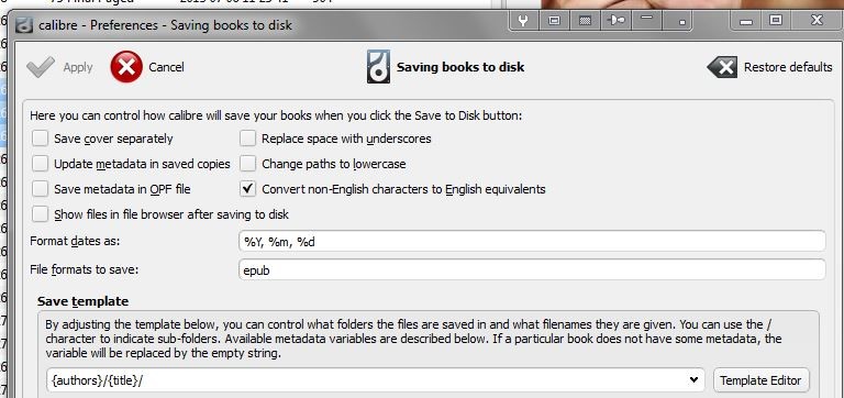

I don't use Save to Disk often but I keep it simple - see below for my Save to Disk settings. The net result of those settings is Author folders that only contain epub files whose file names are the same as those in the Calibre library.
