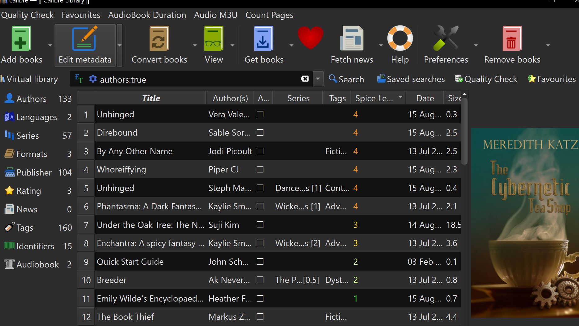

I will say from a very quick look at that website today that I think it could all be done with a Romance.io metadata plugin if someone took the same approach that the goodreads metadata plugin does. Where you bring the extra rating down back as a fake identifier value (like I do with "grrating"), and then have a custom column that displays that "identifier" value - which is actually the rating. Perhaps the only thing you cannot do (or maybe you can - I've not bothered to try it) is display that custom column that is "built from another column" as a rating column. So you would instead see the raw numeric value rather than stars.
A custom column with a numerical value is what I use in Calibre, so icons like stars or chili peppers aren't a big deal to me. I have the integers from 1-5 with a color for each one, starting with green and ending with red.
Here is a screenshot of what my custom column looks like:

You're correct: composite columns (built from other columns) can't show stars. However, it would be easy to do a search and replace, copying the "identifier" rating to a custom rating column. This could be done automatically using action chains when books are imported.
You made the template language flexible enough to display rating (I shouldn't be telling you that )
program:
    rating = $rating;
    text = '';
    for x in range(0,rating):
        text = text & '★'
    rof
The line highlighted in blue should be edited to fetch rating from the appropriate column
Edit: Thinking about this, I was about to suggest a rating_to_stars() function, only to discover it is already there, and it uses halfstars as well.
program:
    rating = $rating;
    text = '';
        text = text & '★'
    rof
This is exciting, granted, I am not sure what most of the code means. I didn't know that there was functionality for half stars. Is that something that can be used for the built-in rating system in the default metadata screen?
BookWookie is offline   Reply With Quote
A simple template that uses rating_to_stars is
{#my_numeric_column:rating_to_stars()}
where #my_numeric_column is the lookup name for an integer or float custom column.
If you want half stars then use this
{#my_numeric_column:rating_to_stars(1)}
where #my_numeric_column is the lookup name for a float custom column.
