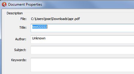

Tested Again in Windows 7.
As you can see, the metadata plugins seems not to work but if you checked the file in Quick PDF Tools you'll see the metadata changed. (capture attached)
C:\Users\jose\Downloads>ebook-meta apr.pdf --title test22222
Original metadata::
Title : apr
Author(s) : Unknown
Changed metadata::
Title : apr
Author(s) : Unknown
